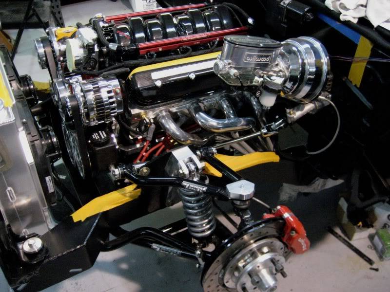

      St George Utah
      1,243
      here is a pic of "Evade with an LS with our headers on it

      here is the pic of the driver side fitment with a BBC
