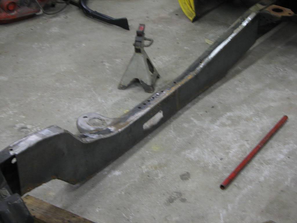

      Ok I have not gotten very many pictures as of lately but to fill you in.
      The frame has been Z’d 3 inches in the front
      2 inches of the frame has been cut off the bottom
      It has been boxed with 3/16 plate
      The rear has been C’d enough to hopefully allow laying body with I hope up to a twenty inch rim, just don’t hold me to that!

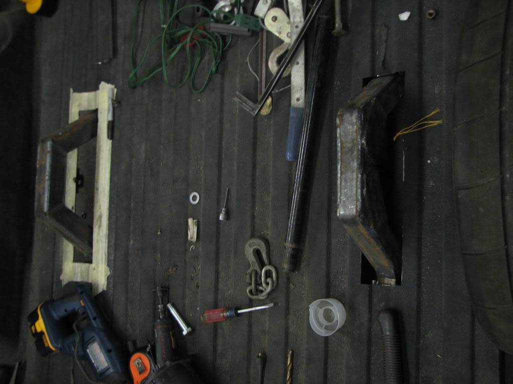

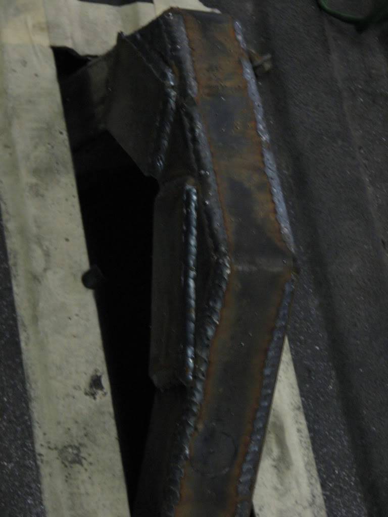

      Ok here they are I got some pictures!

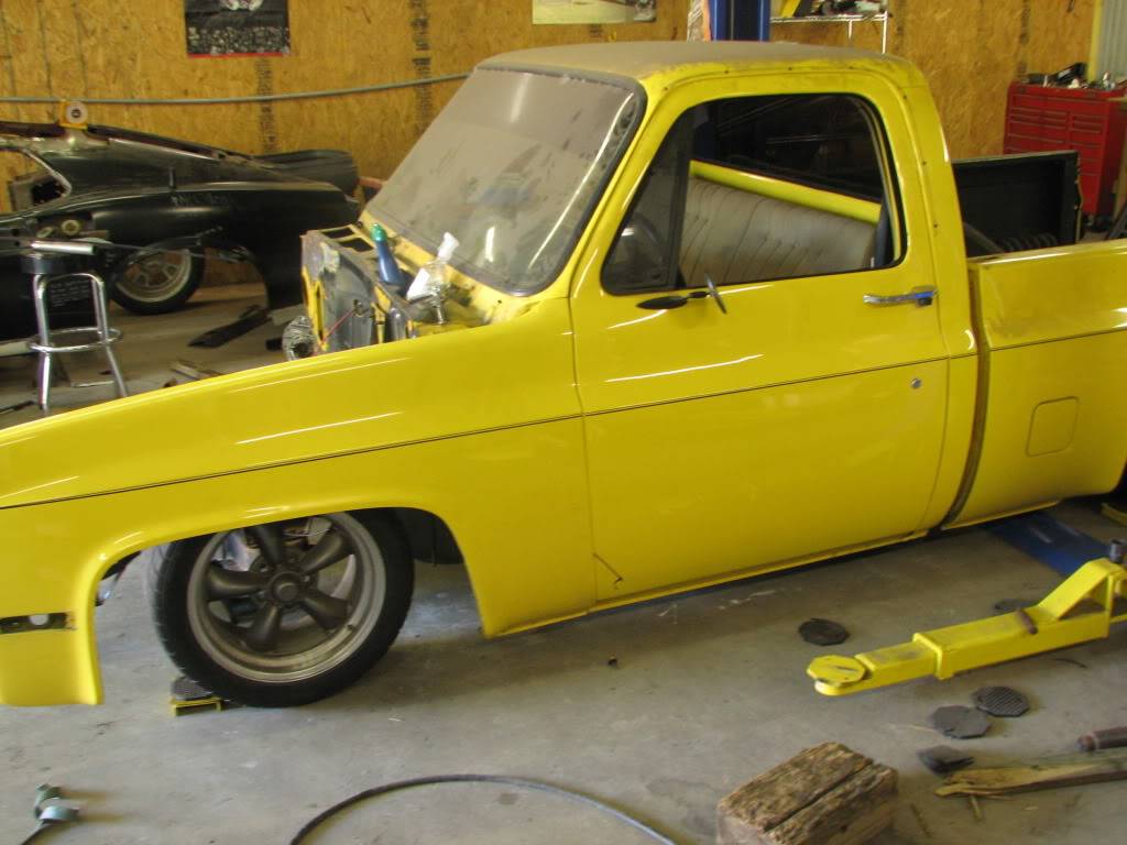

      Well set the cab on the frame today, I think if this thing looks any cooler when it's done I may have to keep for myself!

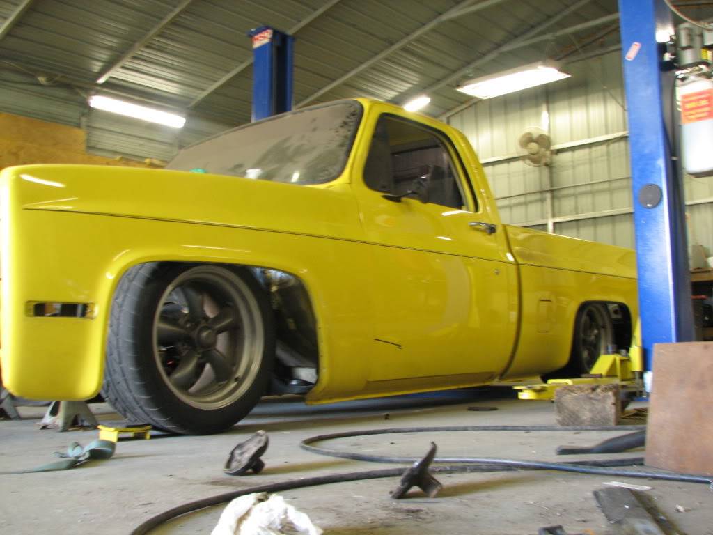

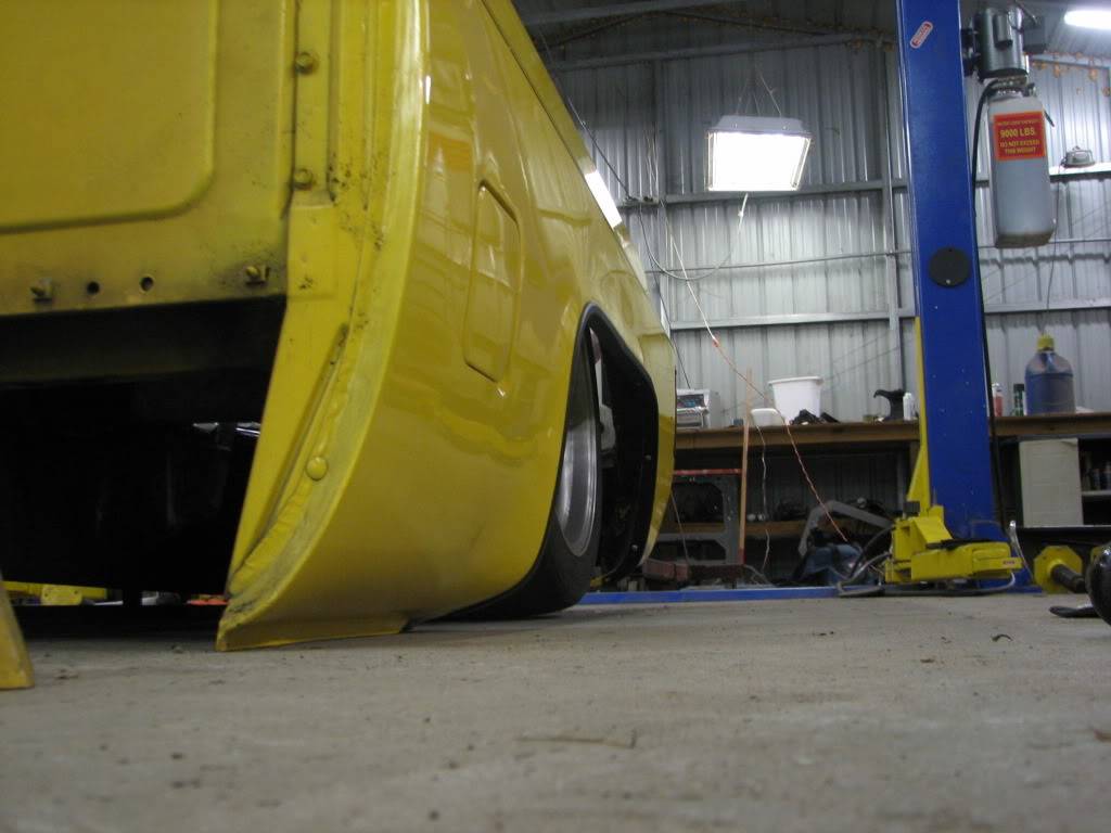

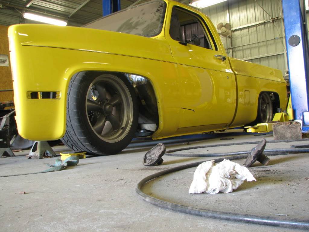

      Well thanks to the holidays I have not been able to really work on the truck, but I did get the cab and fenders on.
      But here a few pictures of the cab on, after everything slows down after the holidays I will continue the thrash!
      Thanks,
      Kody

      Southern Maryland
      402

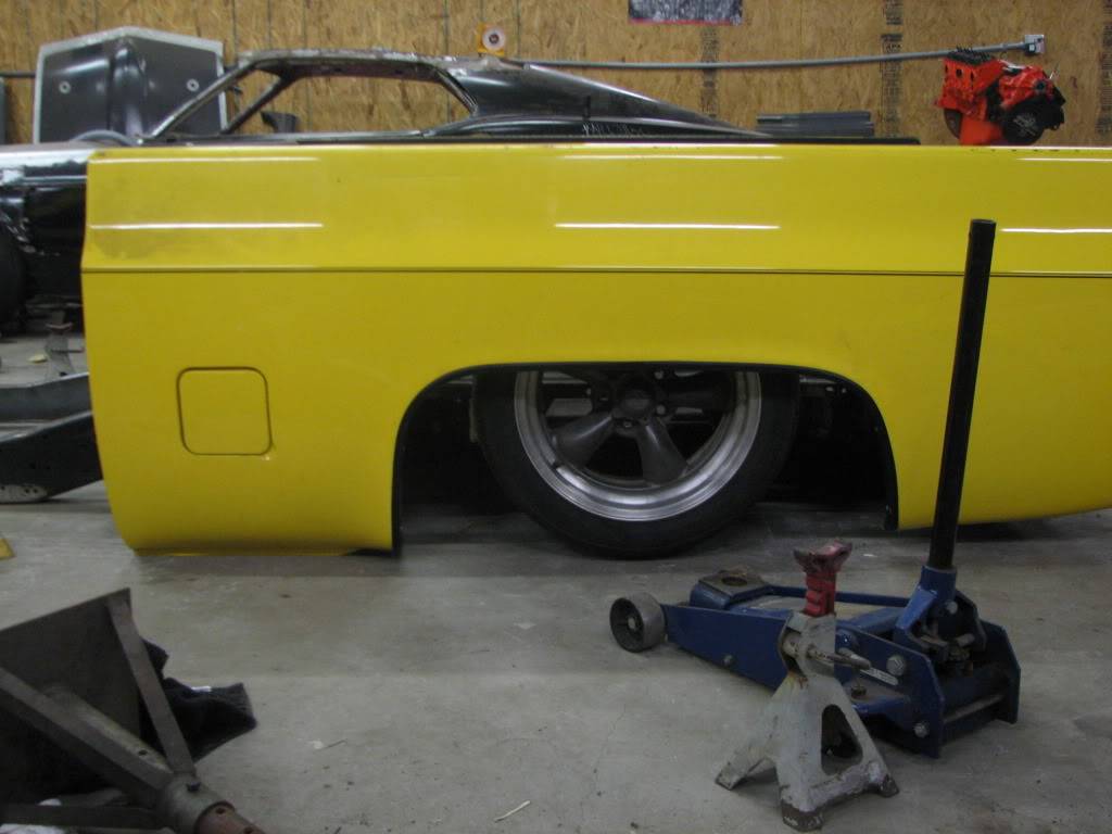

      I wonder what it would look like if the wheel wells were closed up some. It would take a lot of fab but they are BIG
