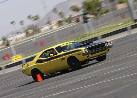

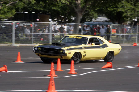

      We have pretty extensive slalom and skid pad test numbers on all our parts. Hot Rod Magazine also did a suspension test a few months ago, and in our big block Coronet test car on a mediocre testing surface at the California Speedway back parking lot we got 61mph out of the car in the slalom. The E-Body is much faster thanks to a lower center of gravity. In our own test sessions that car has run over 66mph on 200 treadwear tires. It will be at the optima Street Car Challenge.
      Skid pad numbers weren't in the story but it has pulled .91G with good tires - but keep in mind that skid pad is more of a tire test than a suspension test. Slalom and autocross better represent real world handling.
      We've scheduled a few track days at El Toro Marine Base for more extensive testing (including with the new A-Body system) and should have those numbers soon.
      Here's some video of the Challenger
