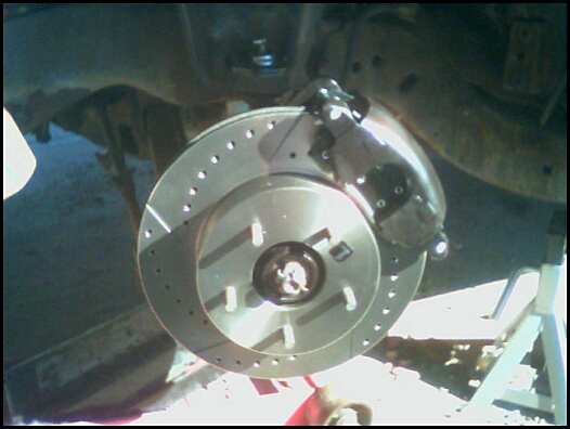

      Old thread I know but maybe this will help somebody else out
Size:  21.3 KBName:  2006 (3).jpg
Size:  19.2 KBName:  2006.jpg
Size:  18.8 KBName:  2006 (2).jpg
      here is my budget setup, drum spindles with machined down boss, drum hub,
      1/4" flat steel bracket with large metric caliper
      rotors are slip on from ('65 to '82 corvette) 11.75"x1.25"
      i had to use a 1/2" spacer to get the correct offset to the rotor, i will replace these with wilwood rotors and correct offset hats when i can upgrade my wheels (need the spacer anyway)
