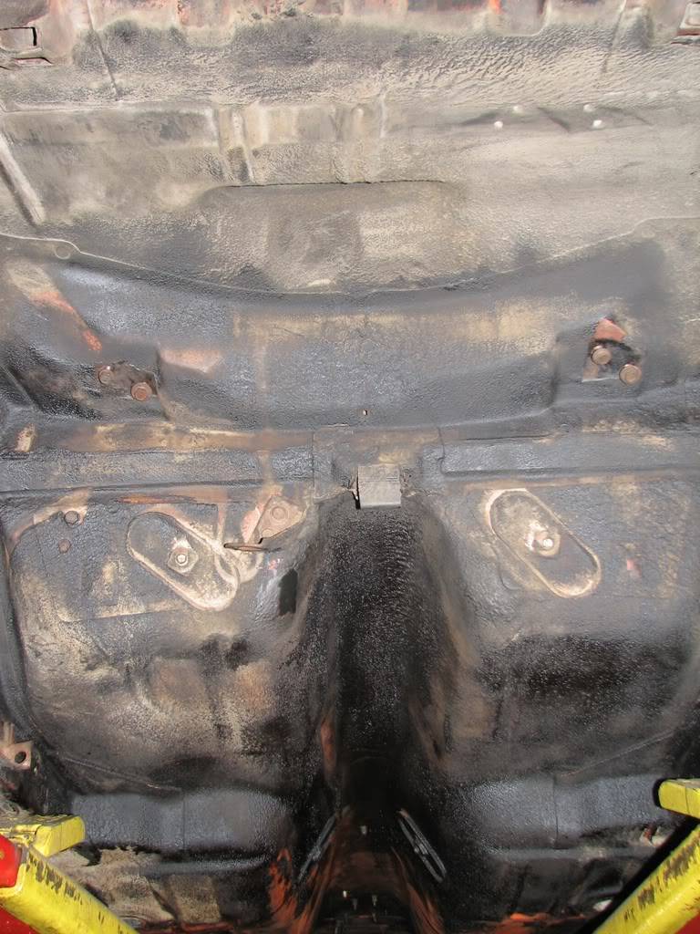

      I bought a 5 gallon bucket of each of the Noise coating and the Ceramic heat formula. I did the entire underside of my car and hardly used 1/3 of each bucket. Planning on doing my floors with the left overs.
      I think a single 5 gallon bucket should be more than enough for the floors unless you are planning on laying it on really thick.
      Summit had a good deal since their shipping on both buckets was only $11.
      Here is some pics to get an idea of the coverage -
      Before:
      1 Day After:
      Drying darker after about a week:
