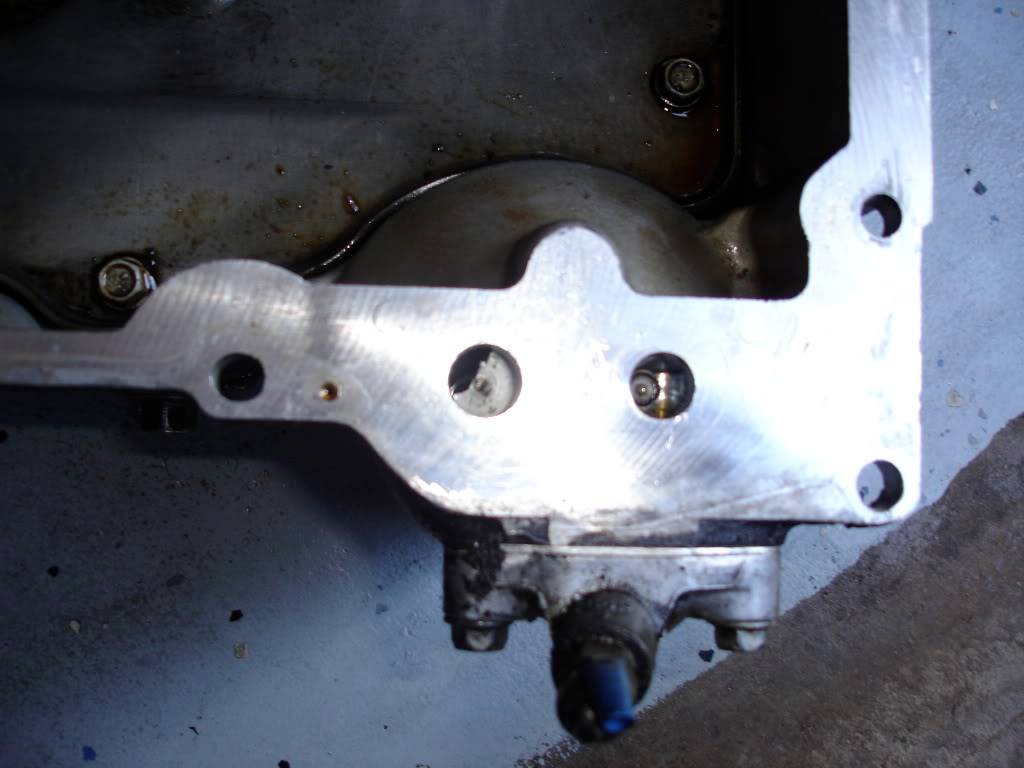

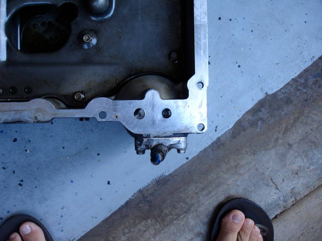

      Presently, I have some concern over my oil pan. There are two non-oem looking holes about the oil filter location. Can anyone tell me if the my oil pan is useless with those holes, or is that some type of modification to allow for more oil flow?

      Those holes should feed the oil filter. The pan I have has holes there. They look different, but are in those two spots.

      The holes are definitely factory, otherwise the oil wouldn't be able to get to the oil filter. The oil filter pad is integrated into the oil pan on these engines.
      If it bothers you that the one seems to be partially blocked then smooth out the transition and remove the casting flash with a die grinder.
      The old engine ran fine with it the way is is now and yours will too.

      Thanks for the replies guys. I'll keep the pan, and will try to make that hole a little more smooth.
