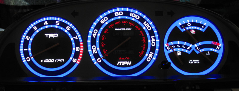

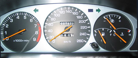

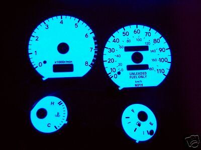

      EL Sheets are paper like thin material that can be cut to shape & when a small current is applied to it, it lights up.
      Since the gauges of an 86 Monte are poorly lit, not lit through from the back, but by light reflecting from the sides onto the gauge. Anyway I was thinking of possibly making a gauge face from this EL Sheet . Anyone have any experience with it?
      Here are some examples I found.

      If you want it to look like the last two pictures (basic indiglo), with no reverse lighting, Id just buy a sheet & cut it to fit the cluster. Then get a sign shop to cut you a identical overlay of the gauge face in vinyl (anything not glowing..numbers,letter, redline, etc) . then lay it over the indiglo sheet. The look wont be near as modern as the reverse indiglo in the top two pics.
      For the reverse indiglo look, Speed-Hut is the only company that comes to mind www.speedhut.com
      EDIT: The 80's MC's are not offered by speedhut...BUT they do have a request page, and it appears they'll do the tooling in "ANY" style they offer (and they have some pretty bad a$$ styles) if a group buy of 25 can be reached

      I want the opposite, the face black with the letters/numbers & tick marks lit up. I'm wondering if I could just design the face in something like photoshop & put the EL sheet in the printer & print the black, red, blue (whatever) on it & then cut it out. Of course I would try it first on clear to make sure it lights through where needed & blacked out where needed.

      I'm pretty stoked I found the thread linked below, as I've been stumped on a way to get the acurate reverse glow look (without looking bobo). You get a white EL sheet (not the green indiglo color), then you design your overlay and print it on transparent acetate sheet. Do two (maybe even three) identical layers as so minimal light shines through the black part...Heres the build.
