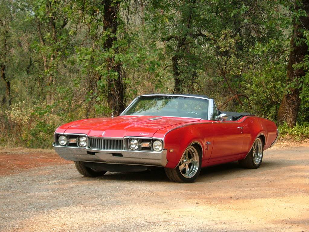

      MINE!
      Global West front coils, SC&C front suspension with tall UBJ & tall LBJs.
      17x8 wheels with 255/45/17
      4.5 Backspacing and a 1/4" spacer for caliper clearance
      17x9.5 rear with 295/45/17 drag radials
      Rear rims have 5.5" bs and running a 3/8" spacer for caliper clearance. Had to roll the 1/4 lip once I put the spacer on. With no spacer, would have been fine. 5.75 would have been even better.
      These pics are with a Hotchkis coil in the back, sat too high. I installed Hyperco 11" 175 in/lbs coils in the back, brought it down about another 1.5" and it looks much better.
