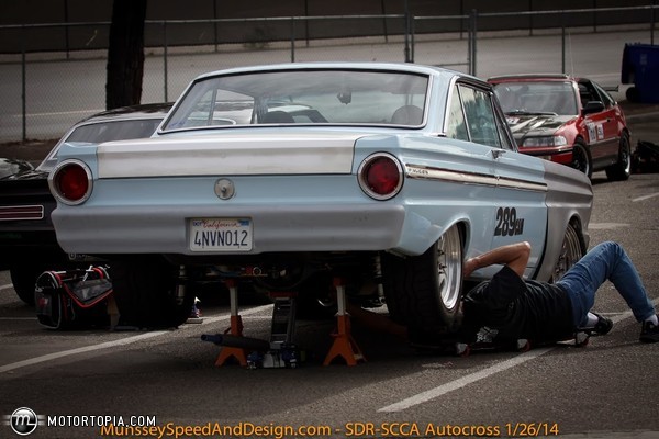

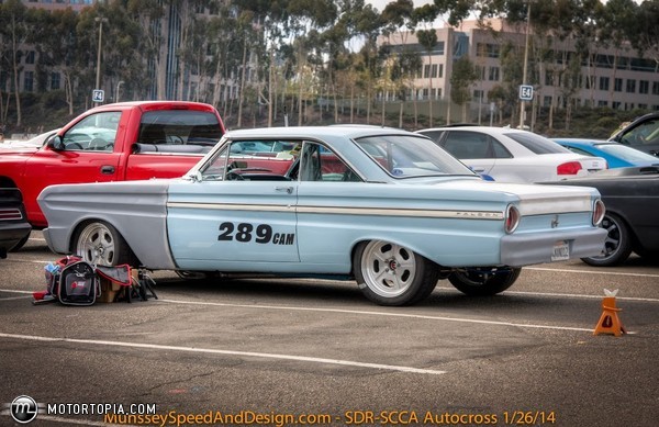

      a few pics from the last autocross. My buddy Jeff came out to get some pictures of the rear valance he built for my falcon.

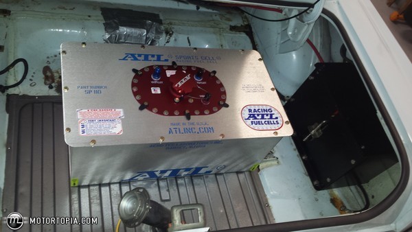

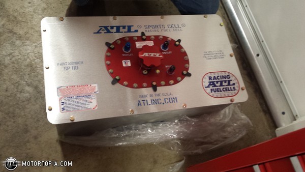

      I decided on the ATL sports cell with the hard plastic bladder and aluminum can and fill plate. I chose to try the 2 duck foot pick ups.

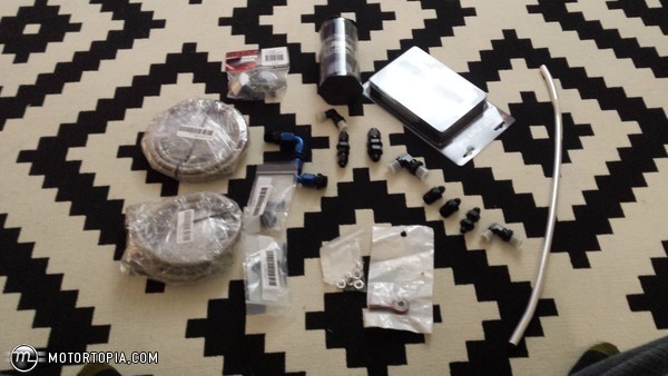

      I ordered the ATL fuel cell.
      And a few fittings from summit.
      A few cable ties and Im ready to race.

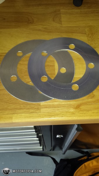

      I was having a slight rub on the inner fender in the back so I made some .050" thick wheel spacers and problem solved. I may even be able to drop the rear another 1/2".
