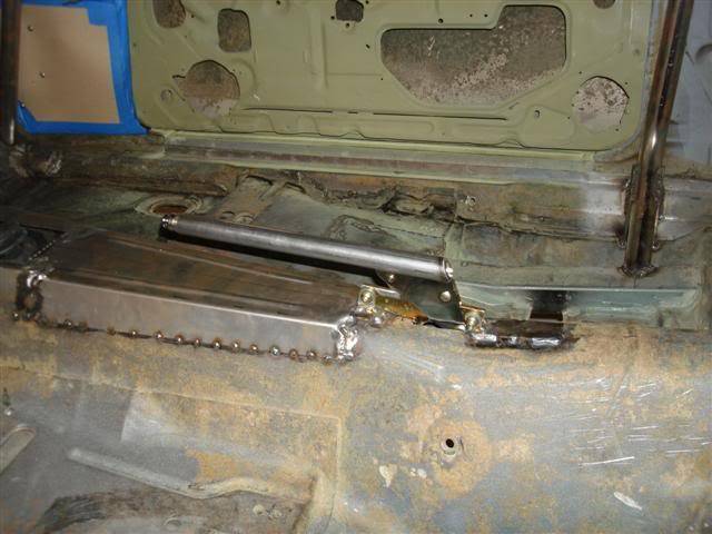

      I fixed the leverage problem with mine by taking it apart and adding a longer handle to it. I haven't used it yet though so I can't say how well it works. I add about 5" to it though.

      That will fix the short arm leverage issues. Looks good. Any build pics? Is it a chrome tube? Or are you gonna paint it? I like my arm, it holds, and I dont have to do the major two hand grip. Im just used to the honda arm and the feel of it. Like I can pull and pull and it gets tighter and tighter. With the lokar when it hits the pads its not moving anymore. Maybe that extra 5 inches will give the leverage I like. Thanks. JR

      Quote Originally Posted by JRouche View Post
      No it isn't chrome but it could have been chromed if someone wanted it to be. I will be painting mine black and probably adding some heat shrinking for the grip. The tube is a piece of 1" .120 wall tubing that I had left over from my roll cage build. It (hammer) fit perfectly over the top of the original tube. I basically took the original one apart to find that the button was hooked to the release lever with a piece of all thread. So, knowing that I could just lenthen this piece with a new longer piece of all thread I cut the end of the original handle off about 1.5" back from the button. This allowed me to keep the original button and the flange that is hooks into. I drilled a hole on the under side the new lengthened handle and plug welded the end of the original handle with the button flange into it. Then I cut the new handle in the back to match the slash cut and then hammered it on the original, and tack welded it in place with a plug weld on the rear portion to hold it still. So the original handle is still inside of the new piece and gives a nice long leverage area to pull on. As you can see a little bit I also welded plate into the floor to extend the area that I will be pulling on. The front plate is covered by the new tunnel portion but is about 8" long. If you have any other questions or something is missing just let me know.

      Ok? Now I like your thinking already!! You kept it simple and completely doable. Im saving this post, I may need a "helper bar" fix in the future. Bet you can get plenty of cable stretch now and get that solid locking feel. And the heavy cables they provide can easily take a lil more tension. Thanks for taking the time to explain it all. KEEPER!! JR
