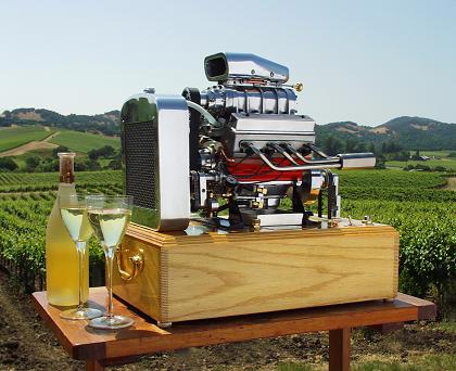

      You know ive seen that before, and im still wondering how a tiny blown motor fits into a nice day at the vineyard??

      Pardon me, do you have a tiny blown V8?
