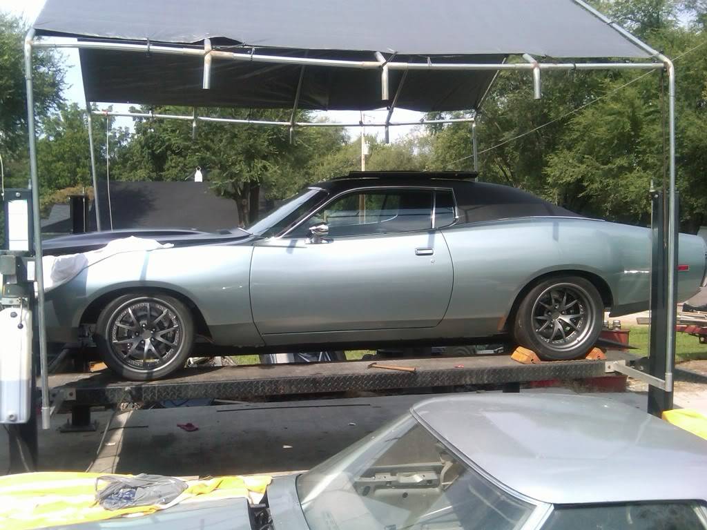

      I put the race wheels and tires on it today checking fit and clearance. It is amazing how much difference wheels make. Notice these have no chrome.

      Definately looks more "pitbull" than "show dog" with the 18s!

      WOW! Those Forgeline EV3s are awesome but damned it that big Ole car does not make those 18s look like 15s! The 19s and 20s fill the wheel openings much better. Either way, sharp as hell and not another Camaro.

      Both sets of wheels look great, but the track setup looks a lot meaner. Very nice build.
