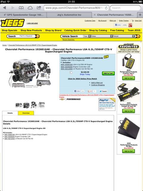

      Note this Jegs pricing typo last Friday. I "bought" one. They called me the next day about the missing digit in the price....it was worth a shot. What a great story that woulda been.
      Dec 2010
      St Louis
      453
      Bought one? I would have bought 10! lol
