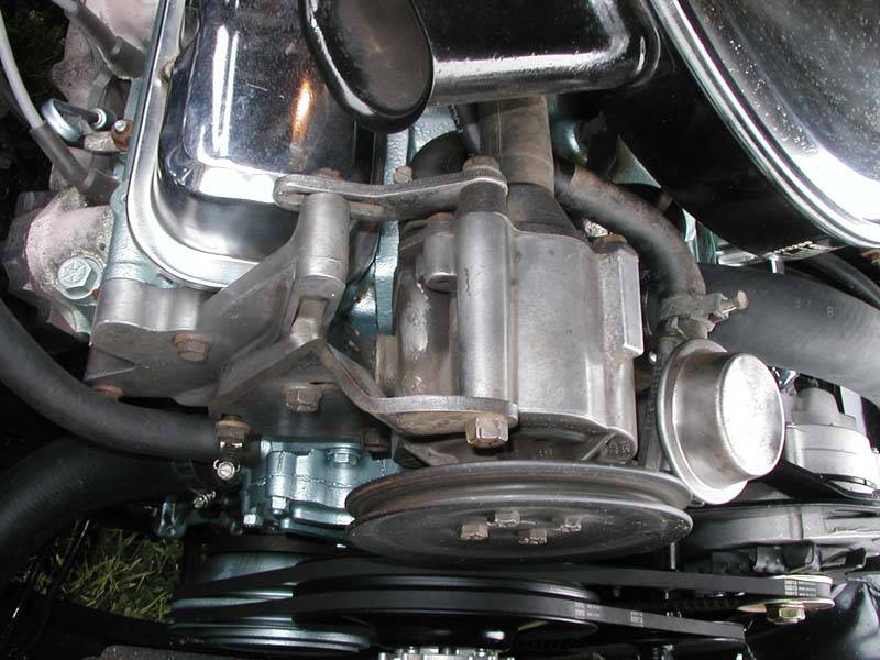

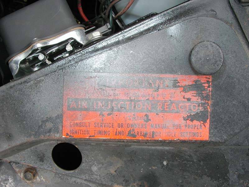

      (California cars were equipped with the A.I.R system (Air Induction Reactor or smog pumps
      and in 68 they added the 6 port TVS in the manifold etc. Also available was the pancake louvered air cleaner in 67, then the standard single snorkel air cleaner became the norm - with chrome lid and valve covers for the 400's)

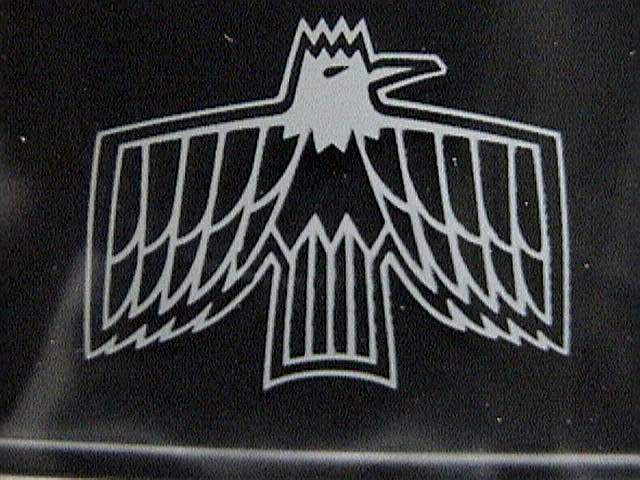

      - 68 deluxe interiors have the firebird emblem etched into the windows. (printed, not etched, and there is no rhyme nor reason why some cars received the Bird Glass and others did not. They also ran low in production of the bird glass and it was dropped, still a mystery)
