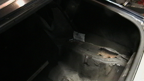

      Around the corner from my job I have found an '80 Malibu for sale. The tag in the window says $1000. Which would seem reasonable at first, until you look under the car and see that the rear frame horns are rotted from where the wheel well starts to the bumper mount. My thought was that if I can get the guy to sell for $500 or $600 I could cut the frame rails off the frame of the Monte and replace them on the 'Bu. I could then sell the Monte body and front clip to a local stock car racer for almost as much as I would pay for the 'Bu.
      The rest of the car is very solid. I crawled all around and under it. Have not seen under the hood yet, but believe it to be a V6 car. I'm just concerned that if I do this, I'll end up in the same place I am now, with a disassembled car. I think I can do the rear clip without completely removing the body, anybody ever tackle this before?

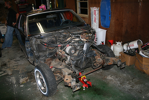

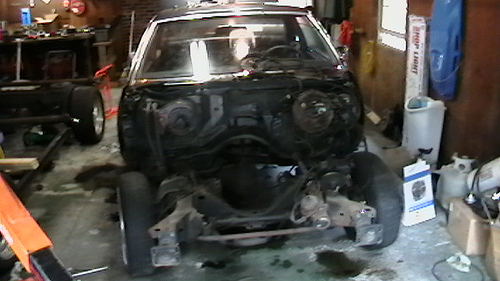

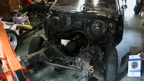

      Last night we got the front clip off the Malibu (will post pics when my brother sends them from his camera). Came across something interesting that I didn't think of.
      The Monte frame is 2-1/4 inches longer in front of the radiator support. Will be sectioning it down to the correct length once the body has been moved over. Am I the only one that thought that this was a one for one swap?
      Other than that, everything came apart very smoothly, nothing broke or stripped. Hope that continues throughout the rest of this project.

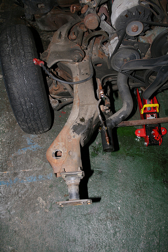

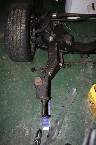

      Here are two pics showing the difference in the frames:

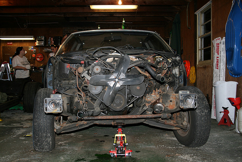

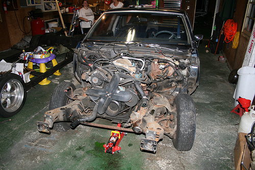

      Was very obvious once we got the nose off the Malibu. Here are some others post nose removal.

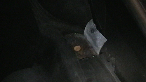

      Have made some more progress. With the rear of the frame being rotted out, I kind of expected to run into some body bolt issues back there. Had to cut open two spot in the trunk to grind the bolt plate off.
      Also finally got the V6 outta the way so that we can jack the body up and get it on jackstands. Hope this weekend to get that portion taken care of. Its all unbolted, just need to disconnect the brake lines and e-brake cables.

      I have come to the conclusion that it will be easiest to remove the 2-1/4 inches from the good frame and weld the bumper mount back on. Instead of cutting the piece off of both frames, I'm going to make some kind of jig off the rotted Malibu frame, and use that to position the mount on the Monte frame. All of the same holes exist, just that the location for the bumper shock is further forward on the Monte frame.
      This pic above is the Monte frame, where the body is headed.
      The Pic below is the Malibu frame. You can see how much closer the radiator support mount hole is to the absorber mount.
