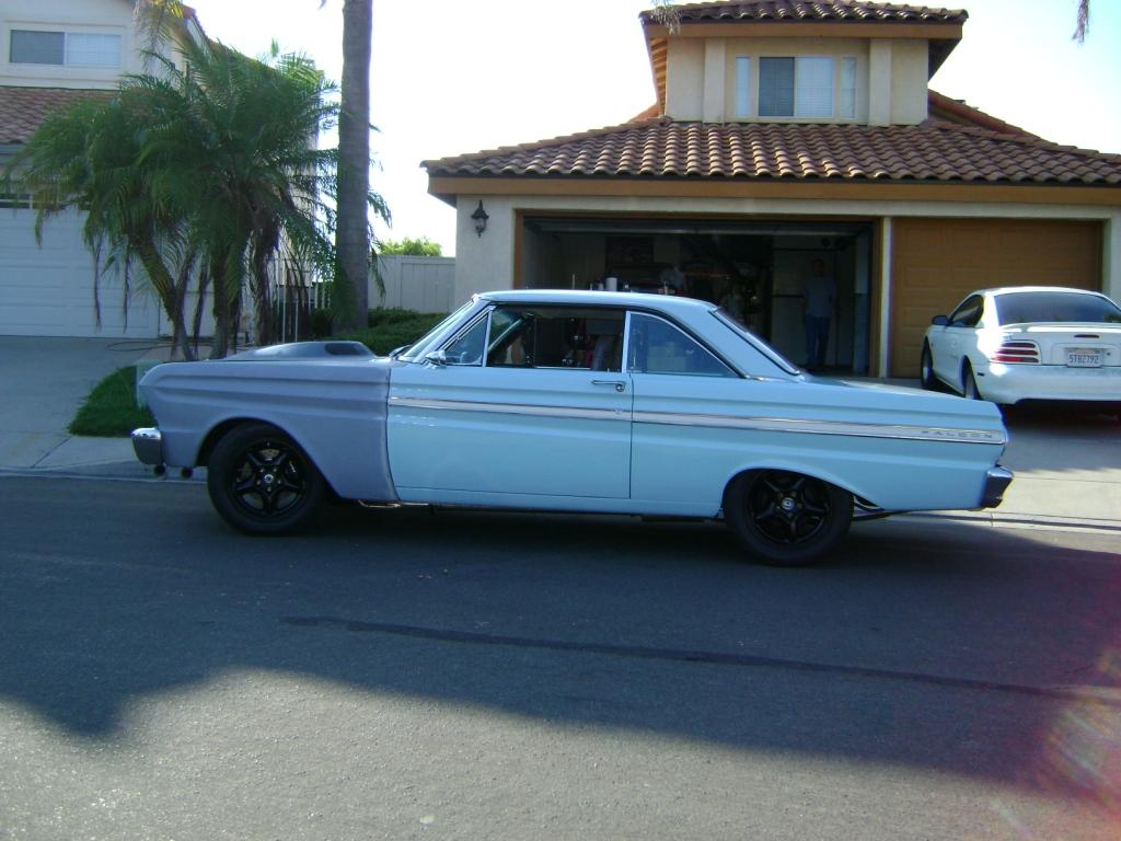

      i have a 65 falcon and a 95 mustang and i got creative last weekend. i decided to put my 95 mustang wheels on my 65 falcon. they are 16x7.5 with a 245/50/16 tire. The back fit perfect with a 1/2" spacer. I have stock drums in the back of the falcon so a disc would space this differently (smaller spacer). I was impressed because most places you read up on falcon and with leafs the largest back tire is a 225 on a 7" rim. The front i had previously tried and the wheels fit also with a 1/2" spacer with some turning loss due to contact at full turn and full compression. so my plan is to swap wheels form falcon to mustang (i know the falcon wheels will fit the mustang) and try it out and see the handling difference. I will be upgrading form a 215 tire. I will get a better wit if i run a lower series tire.
      just thought I would post my discovery for anyone with a falcon. I know there are a few on here.

      looks great,really fills out the wheel wells nicely

      thank you. I will lower the back another two inches and then even out the front. Trying to dial it all in.

      here is a full pic

      Nice dude!

      And thanks for the help you have given as i was making my decision. these wheels are the absolute widest i can fit on the falcon with leafs in the back. It was the best of both worlds as now i can get a set of 275s and 315s on my 95 mustang. and i dont have to buy two sets of wheels.
      going with 16s really helped with the tire selection for the falcon as well. 245/50/16 probably the most popular tire size ever.
