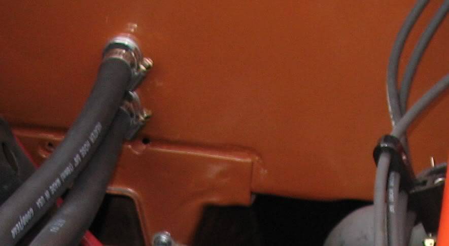

      Lawrenceburg, TN
      4,098
      Here is the hoses to the firewall with the small aluminum bulk head
      has a smooth clean look
