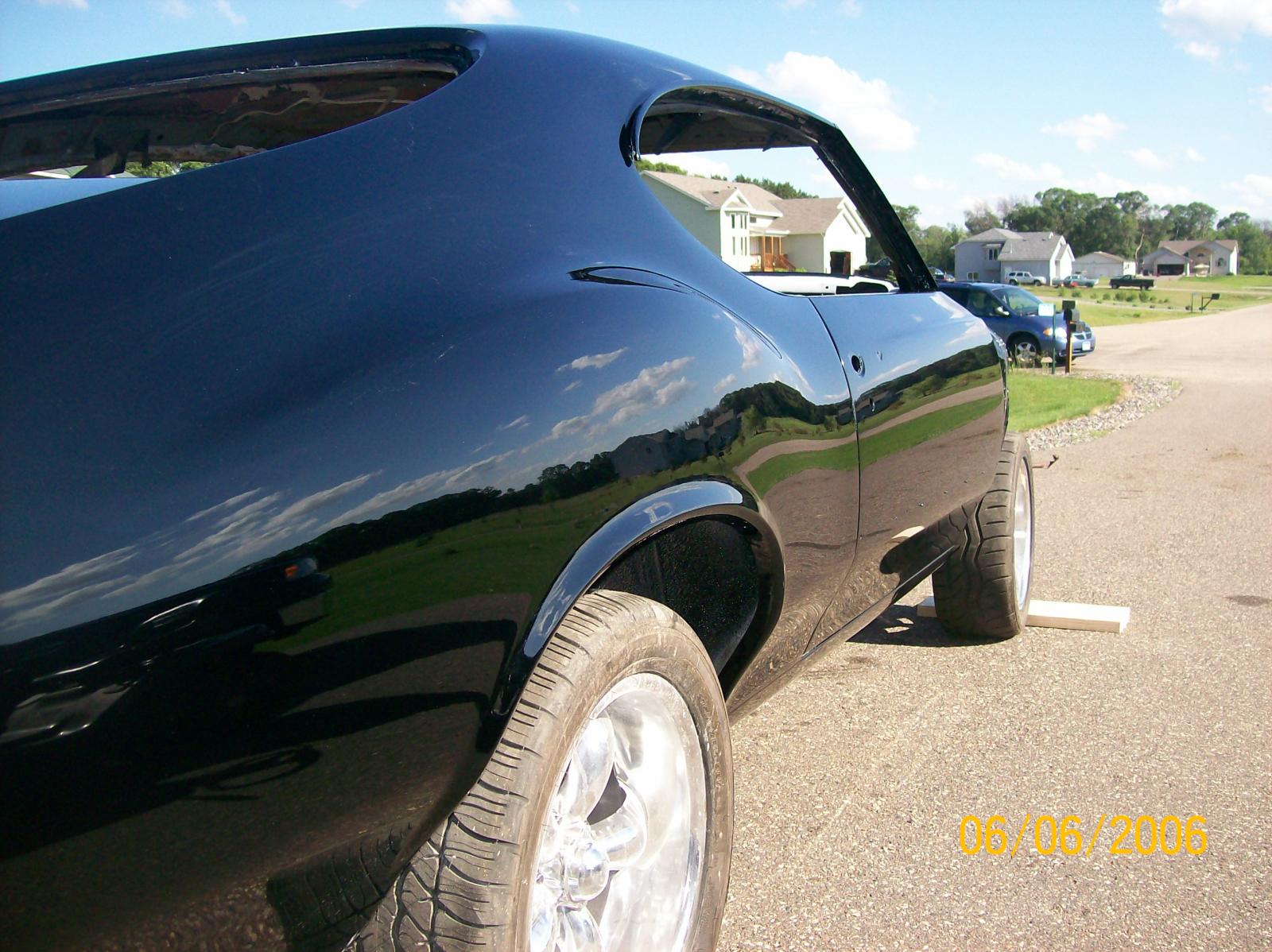

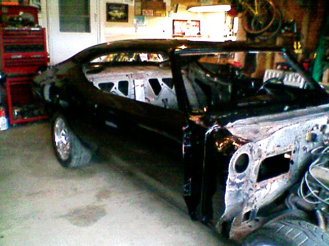

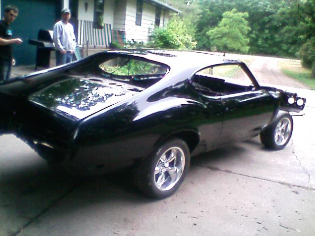

      I am doing up a 72 Cutlass S and I'm having problems with the welded seams on my quarters showing up in the hot sun but when I drag it back in the garage it smooths out again. I may have a solution to the problem. It involves some rewelding plug welds along side of the seam and blasting it and using some special marine grade body filler that sands like a rock but is very very ridgid and will not flex. A guy I know does custom and restoration work and he had the same problem on a GTX he did and he redid the car over 10 years ago and it still looks perfect. I will find out more and keep you posted if anyone is interested however I am going to wait till later this summer to redo it. I've got a lot of put together to do and I'm not ready to attack those quarters again. Here's a couple pix of it as of last week. I just sanded and buffed it this saturday and sunday I drug it out to see if I missed any spots buffing it. It looks awesome while it's in my garage...

      I'd recommend welding the seam solid, in addition to the plug welds. Also, if it were me, I'd use lead. If that's not feasible, All Metal or one of the metal impregnated fillers.
      The problem is that the heat is causing the seem to heat up and expand. Then when you pull it back into the cool garage, it contracts into proper shape.

      The problem lies in the welded section itself. The metal expands and contracts at different rates allowing the weld seem to show. As you are welding.The seem becomes very ridged and the surrounding metal expands at a quicker rate than the weld seem.
      The product you may be thinking of is dynaglass. Yes very hard to sand. Its like liquid fiberglass and filler mix.
