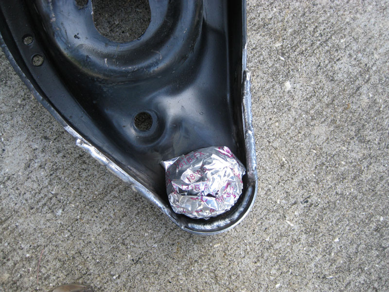

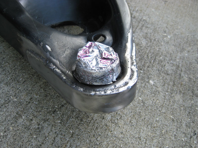

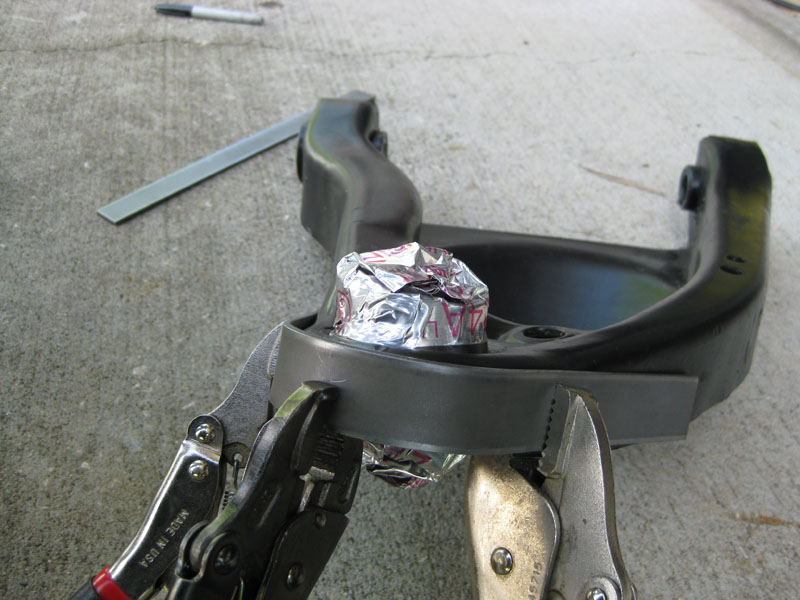

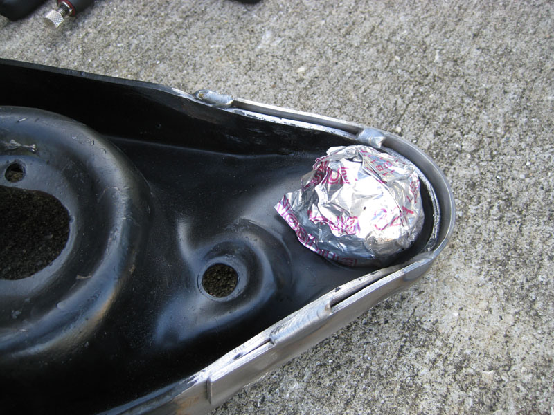

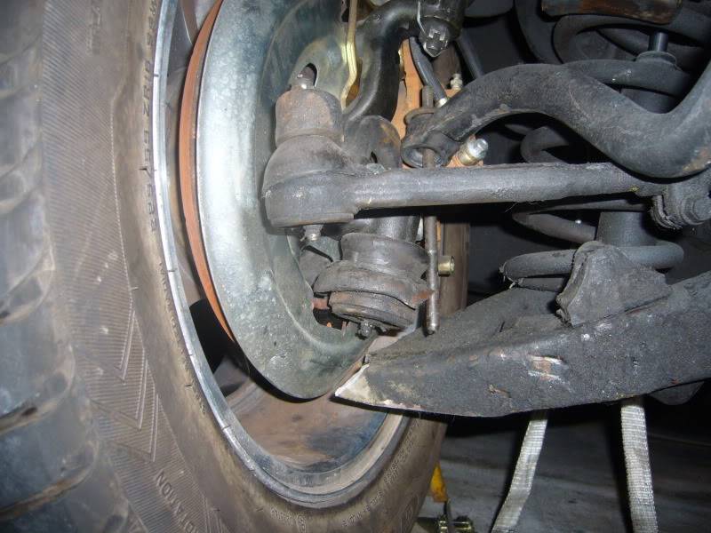

      First I bent and welded a piece of 1x1/8" strap around the end of the control arm. Before anything gets disassembled check for clearance between the LCA end and rotor. With the C5 brake swap I have a lot more clearance here now.

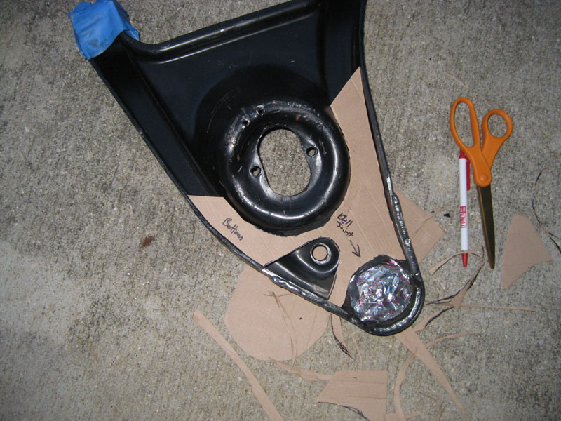

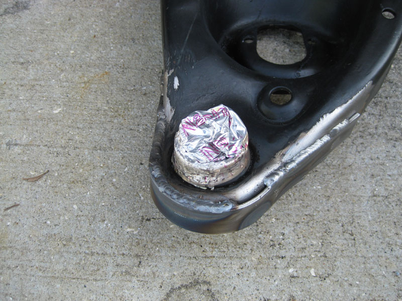

      I then cut a template from cardboard. You can see the space I left near the sway bar hole. This allows my endlinks to move forward when the control arms move down.

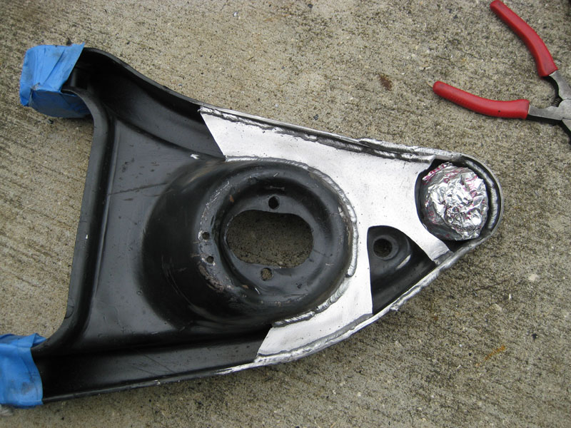

      Then transfered the template to 1/8" plate and cut it with a jigsaw. The second one I used a hole saw to drill the radius around the sway bar bushing and it came out a little cleaner.
      A little finish grinding so the bottom plate fits tightly and then weld it in.

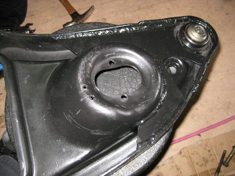

      Now just add paint.
