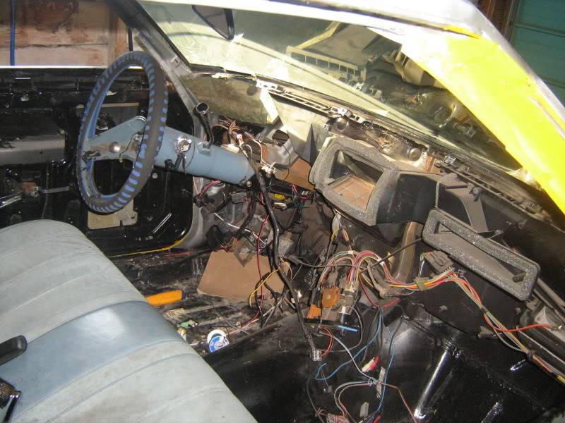

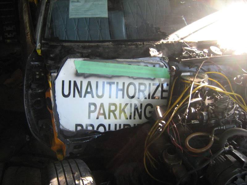

      hey ive done it to my cutlass. its not to hard, but it does require you to take the dash out and fender off. i did it on my 79:
      took off the dash:
      then unbolted it from the inside and outside:
      and since i didnt want to wait 2 weeks to get one online i just made a free one:
      just need to sand it and paint it.
