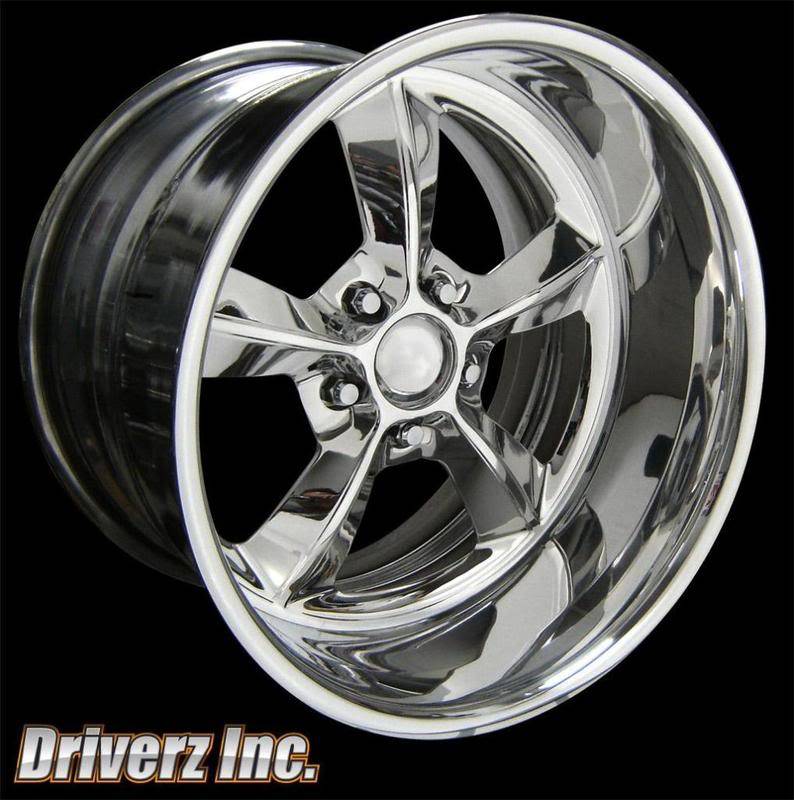

      OK, here's the deal. The car is lowered "a little" (still not sure of the stance). SPC tubulars up front w/Howe tall ball joints and PT springs. Currie Currectrac rears, SPC PT springs. Wilwood 12.2" drilled/slotted disks w/black wilwood calipers all around. I widened the inside of the rear wheel wells, and can fit either 275/45/18s or 295/45/18s in the rear with a 10" rear wheel and about 5.5" backspace. I want more than rubber band sidewalls. I may do 18" rears and 17" fronts. Still not sure. Here are a couple renderings. Thanks for the help! BTW, the lower of the two renderings with the tach wheels is not proportionallyl correct. The wheels are larger than 18's and the car is lower than in reality.

      I think the NewGen wheel with a powdercoated grey center would look good.

      Since you are building the car to have a period look, then I would go with the NewGen. It has more of a traditional styling than the others.

      I like the 'old school' look on this car. I would go with the 'Newgen' wheel with a Grey center.
      I agree.
