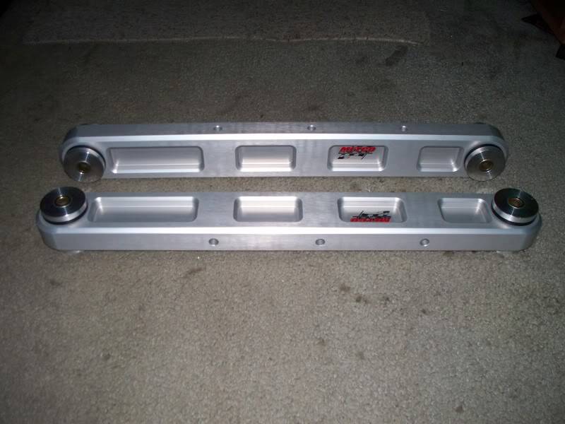

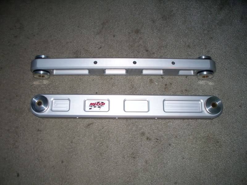

      Well on Monday I ordered new rear lower control arms for my Custom Cruiser. I want this car to handle even better than it currently does which is pretty darn well. And in order to do this I need a rear swaybar. Now there are options out there for swaybars but most rear bars are so big they almost require a new front bar. And I am not yet at that point. So I needed another option, and I found it with these Metco billet aluminum LCA's. With these you can mount a stock sedan rear swaybar. They figured out that all one needed to do was to move the mounting holes further forward on the arms. You will notice that there are 3 holes on each arm for swaybars. The 2 most rear holes are for the wagon bar and the 2 most forward ones are for the sedan bar. These LCA's are truely beautiful.

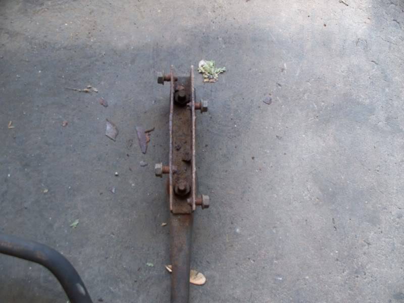

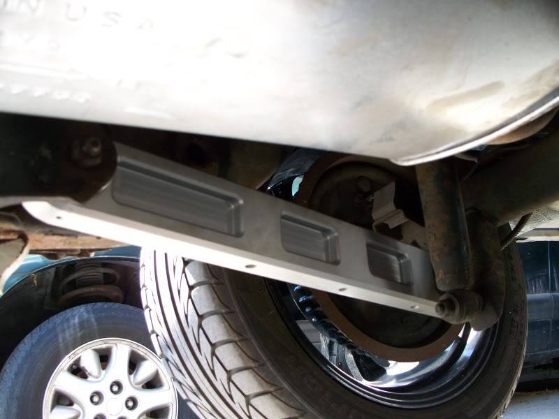

      Ok I am back after the install and I am beaten and bruised. The arms were tough to get off. Seems GM thought it was a good idea to put the forward mounting bolts in thru the boxed frame. What a pain. But I got it all done. Here is the bar with the channel that slips into the frame rail.
      And a close up of the channel

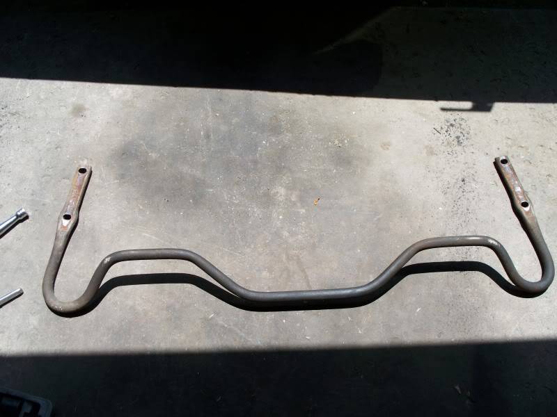

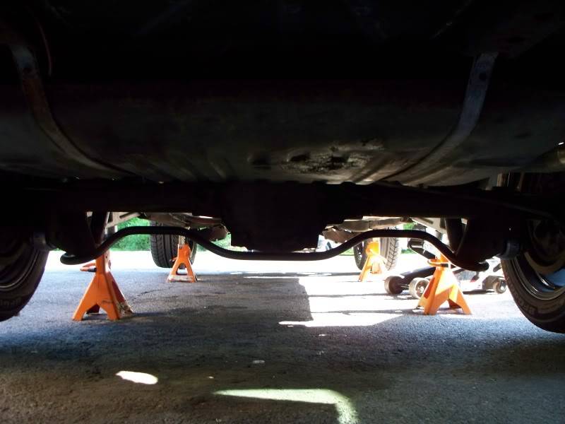

      And the bar without. This is all I will need to bolt it to the Metco arms besides their hardware.

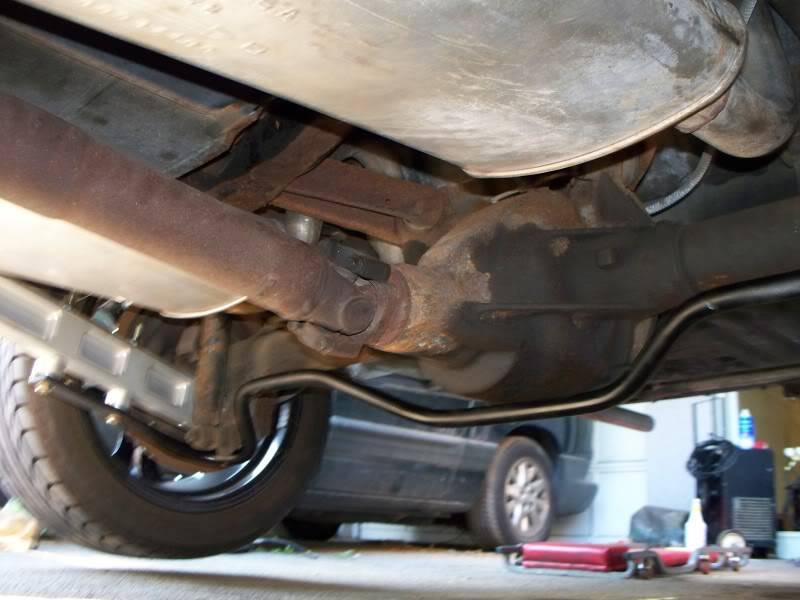

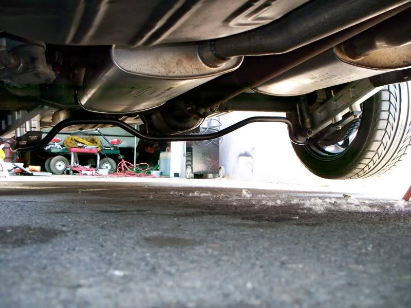

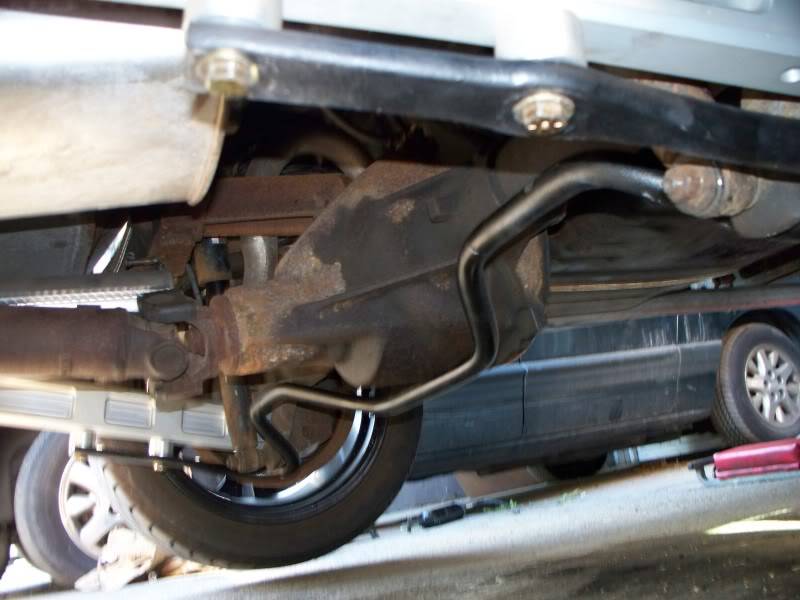

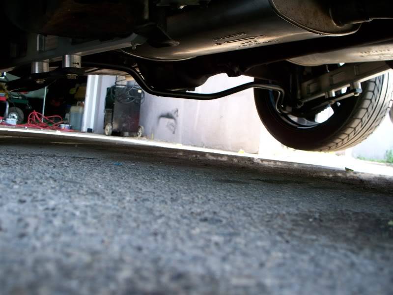

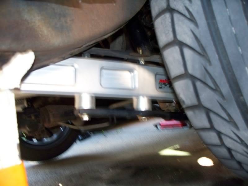

      Now some pics of just the Metco arms mounted.
      And with the swaybar mounted

      You sure about the install on that sway bar?

      Wow. I didn't notice the lack of sway bar bushings, whats the story there?
      On the LCA side of things, apparently Metco uses poly bushing on both ends, I know on my rear suspension this leads to binding. But they are pretty.

      On the B-Body wagons the swaybar bolts directly to the LCA's. It is a totally unique way to do it. It does not bolt in anyway to the rearend housing. There is also no buchings used to mount the swaybar. The LCA's have poly bushings in each end. It would have been better to have a heim or johny joint in one end but oh well. I bought these particular arms because it allows me to mount either a sedan swaybar or a wagon bar. I wanted to take things slow with my suspension mods. It has been a great method for me in the past rather than throwing multiple mods at a car and then not knowing whats wrong. It handles so good right now that I am wondering if I should tinker with it.

      It acts just like any other swaybar. It's just mounted different. The arms of the swaybar resist the twist of the car when it leans. The rearend housing does not

      That's weird and I'm not sure correct at all. Someone's going to need to give a dynamics answer to this because as it sits, I'm with True. That bar is doing nothing more than the rear axle is already doing. Sure it's adding more resistance because it is there but I bet with it mounted to the rear end or with drop links somehow like a 2nd gen, the bar would work loads better.

      I can see it, and it is correct. That sway bar is bolted in two different locations on each side - think about the controls arms trying to move in opposite directions (i.e., body roll), and how this configuration would work against that.

      Its a simple torsion bar. As one arm wants to move up or down it forces the other to do the same thing even though it doesnt want to in a turn. Pretty simple really. Some bushings would help but I dont even see them as being needed, there is no frame mount, no noise transfer. And as far as binding goes, thats its purpose, to bind the left and right. Just a simple torsion spring attaching two levers. GM kinda worked that out awhile ago. Just a big spring linking the travels of the arms.. JR

      Here are pics that clearly show that the swaybar works just like any other swaybar. Afterall why would GM design it this way? Why would companies like Metco, Hotchkiss, Spohn and others make LCA's that follow the same design?
      1996 Federal Cadillac hearse
      1988 Eureka Chevy hearse
      952
      GM built tens of millions of cars with sway bars mounted like that- starting with the first A bodies in the 60's and going all the way up to the 96 B bodies (Caprice, Impala SS).
      it's not ideal, but it's cheap and light and it works.
      as to why companies put mounts for that style of bar on their lower control arms- it's so the customer can put their new arms on the car and not have to spend more $$$ on a different sway bar.
      a few companies are now making the Camaro style bar that mounts using bushings an end links. to read all their ads and read their web pages, you'd think that they just invented something totally new and didn't just look under any Camaro built between '67 and '02 and say "hey, i can make that fit G body, too".
