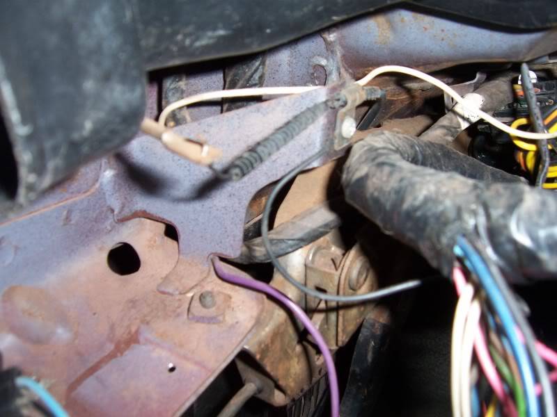

      Only problem left is that I have hazard lights but no signals at all. I went through the wiring diagrams and found that there are 2 dash grounds...1 on the LH side dashboard and the other on the dashboard brace. I think I found the LH ground (see pic) but I can't find the other ground. There is one loose black wire (ground?) under the center dash speaker. Where does this one attach??
      If the flasher is bad where can I find a new one?? It looks like I have one of the signal dash bulbs burned out as well. Any ideas where to get new dash bulbs? Thanks for the help.
