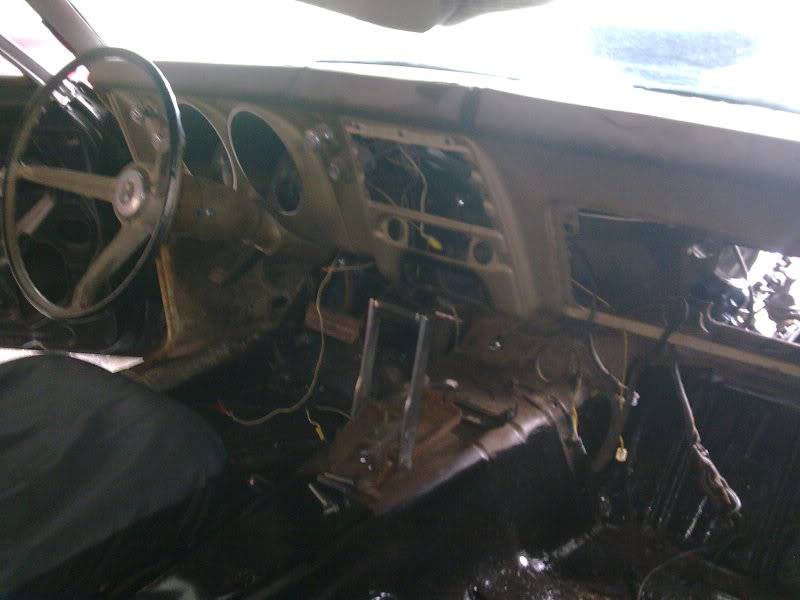

      First are pics of what i started out with. When i bought it i was told that it was all original car with 327 and powerglide, when i started working on it found out that somebody swapped a motor out for a 69-70 350 with a set of double hump heads 10:1 compression and forged trw pistons. Trans originally was a manual and been swapped for a th350. One of the pistons turned out to be cracked so i pulled the motor for a rebuild. Then came the rust, the trunk floor is basically gone, the driver side back floor pan is gone as well, both rear qarters need to be replaced, which i will some day. Right now my goal was to kill all the rust that is there, get the car cleaned up and running and then worry about patch panels and such.

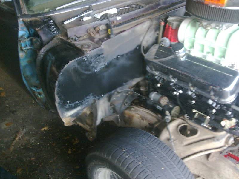

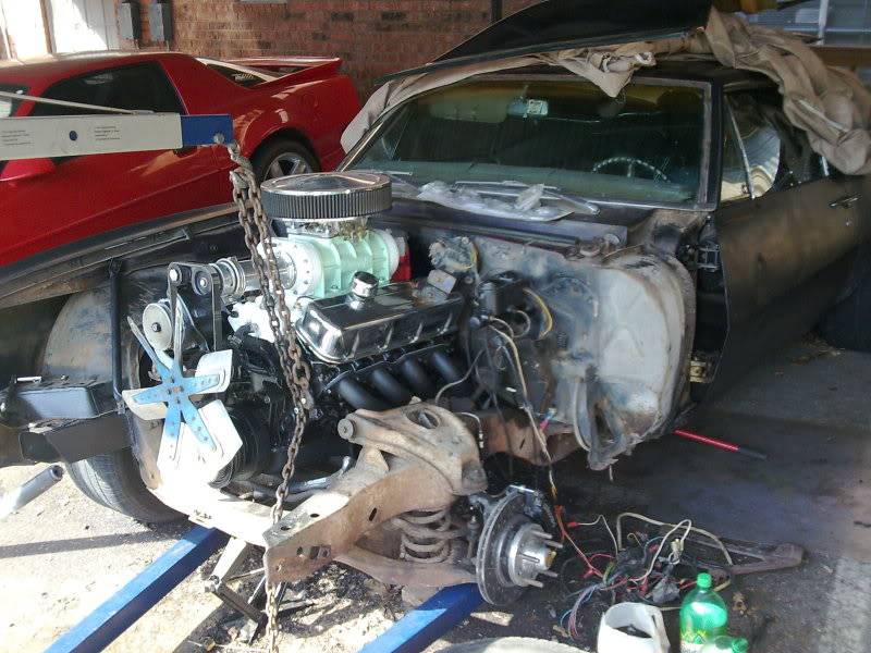

      Dec 2008
      24

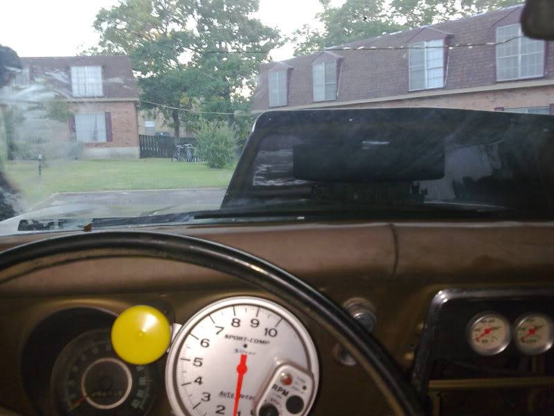

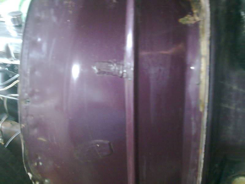

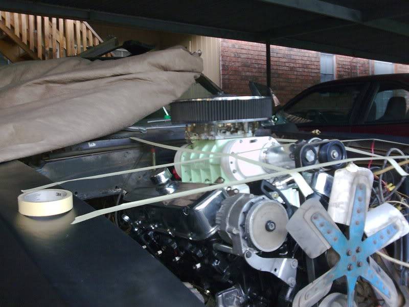

      well, got the motor in and most of the front end as well. Front disk brakes are installed as well. Found 6" cowl hood that barely clears the motor at a decent price and deleted front bumper. Installed 5" Autometer tach and some new gauges. Got hurst ratchet shifter that i need to install as well. Took me forever to get the motor in as i first tried with sb mounts, and that was very tight fit so i ordered bb mounts and still had some issues because of solid motor mounts. Finally after 3 weeks i had the motor bolted in. While i had the fenders off i actually painted the tulip panels and installed heater delete plate which was cut out of old server case.

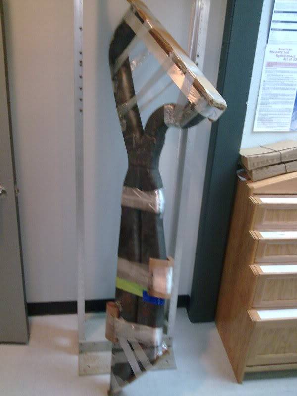

      i've been trying to measure if 6" cowl hood would fit

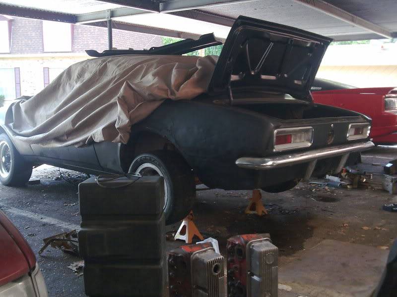

      fuel cell install
