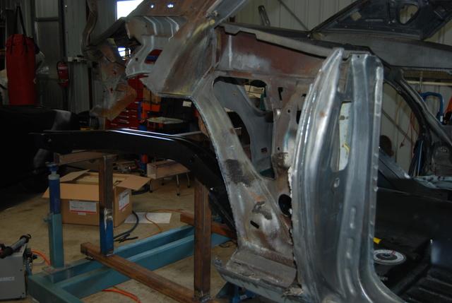

      Its been a while I have been real busy with work, but I had my first day of in about 3 months, so I needed some therapy.
      First of I went and bought a plazma cutter, **** I don't no how I got buy without it, what would have taken me a couple of days, took me a couple of hours.

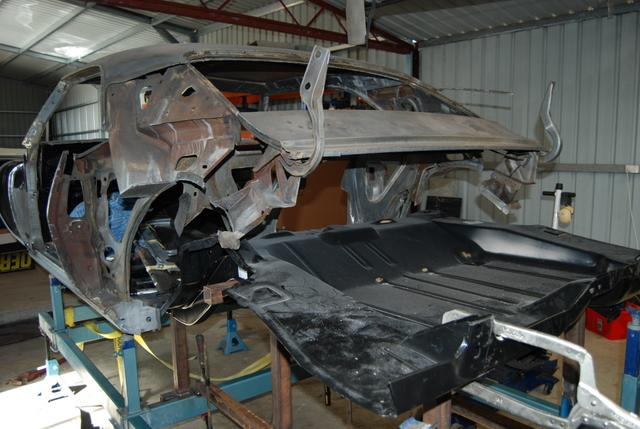

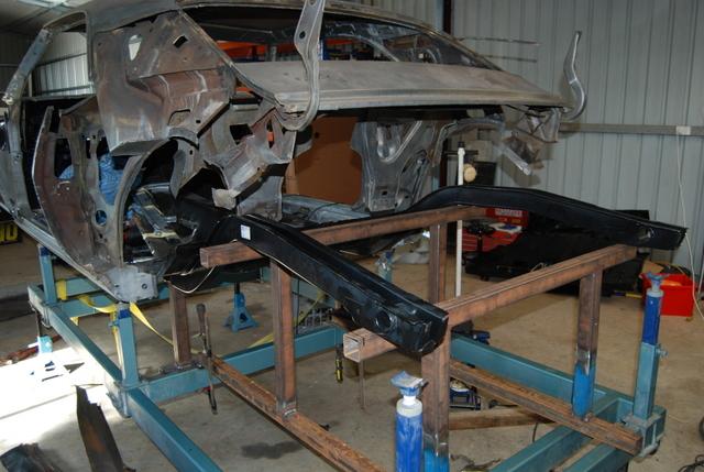

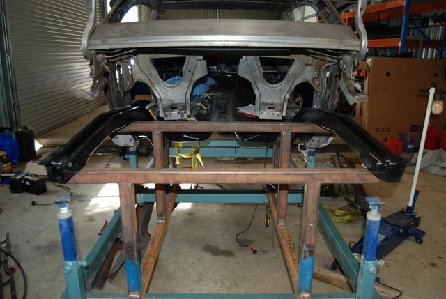

      You can see in this photo I have made the body jig to pick up the factory points.
      Trunk floor test fitting

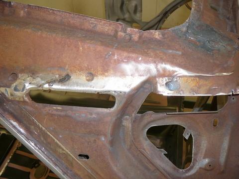

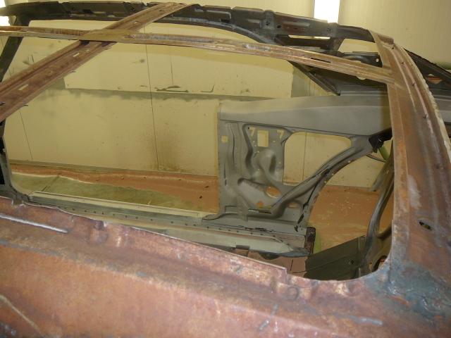

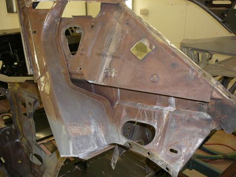

      Hi Guys time for another update, I spent the day blasting and priming the inner sections of the car so I can start hanging panel, I really hate rust and as you can see in the pics it hides it self well, I would really hate to build it and have it come out later.
      Before blasting
