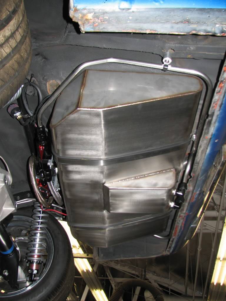

      Not sure exactly how you have your vent. I have the Rick's tank, I just ran NPT fittings and a rubber hose looped a couple times that ended in a little K&N filter. Used hose clamps and zip ties to hold it in place:
      I'm not on the road yet so no idea as to the effectiveness, but would seem hard for the gas to work its way out.

      Where does your vent come out of the tank?? Passenger side like the DSE??
      From what I can see of your routing it looks very similar to what I have done with mine and it leaks like a *******, until the tank gets below 1/2..

      Mine is on the driver's side. Most of the length of the hose and the breather is above the level of the hole in the tank. So I am hoping that minimizes any leakage.
      Maybe some type of restricter or a fine inline filter might help, reduce the flow up the line?
