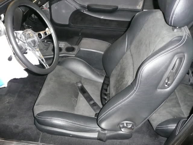

      I have both front and rear 2005 GTO seats in my 69 Camaro and they turned out great! There is very little foot room in the rear because the seats are so much bigger than stock but with a few adjustments the fit looks over the top great. I had to use a flat slide mounting bracket on the fronts causing me to lose the power function but I was able to maintain the power recline on both seats.

      Here is a pic of when Mark sent me, I think they look great!
