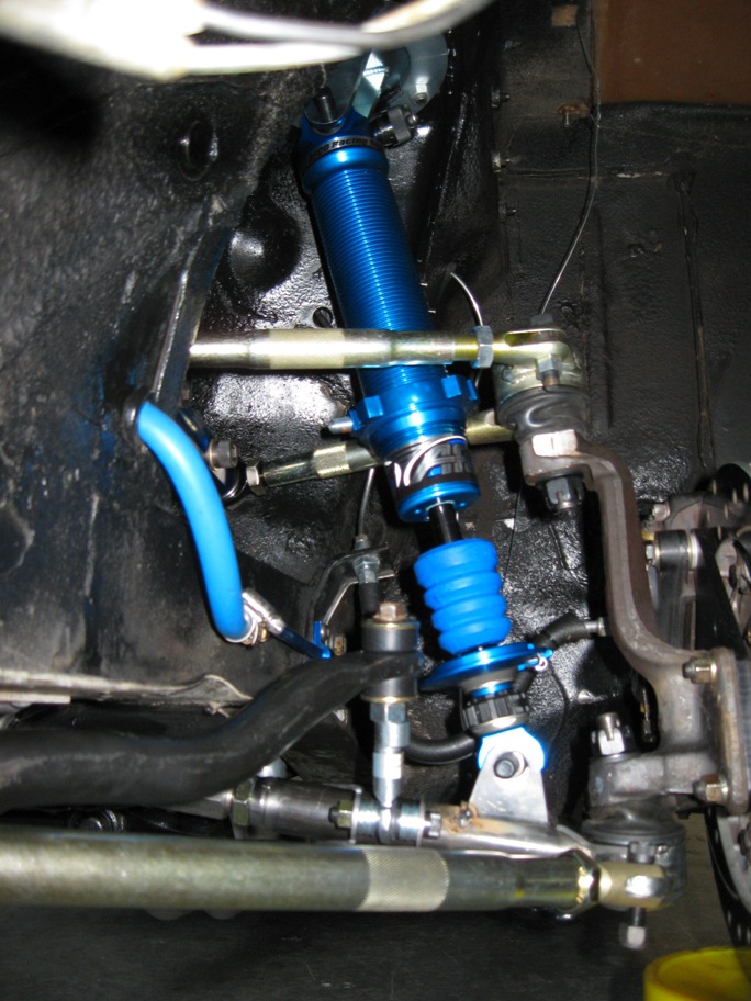

      I am new to the site, but have been building cars my whole life. Also im a mechanical engineer. I have a 65 falcon. Just finished building my own front suspension.
      the idea was to use fords chassis without modifications. Except for the 1.75" drop of the upper control arm, this gives a camber gain under compression.

      Edit(i learned how to attach pics) so here is a picture of my suspension, just finished the TIG welding and paint so more pics to come. Those are AFCO double adjustable coilovers, hopefully worth what i paid.

      finished supension, just need to fabricate a chassis mount for the sway bar.

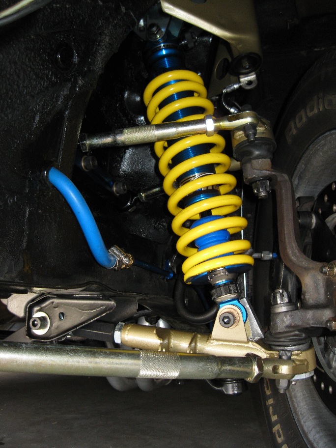

      here is a pic with the stang wheels

      the car went to its first show with the new suspension (just a monthly show at a local restraunt). The drive there was great, im really happy with the suspension and handling characteristics. I got many compliments. The car got a once over from a local race shop that competes in the american iron series. He liked the car and the attention to detail. so that makes you feel good!
