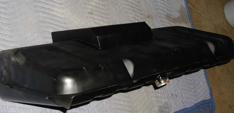

      And here I've been feeling stupid for spending within $200 of a Rick's tank to mod a stock tank with an in tank pump and sump that have never given me fuel starvation issues regardless how much fuel is in the tank by stuffing this
      into the stock tank, thusly:
      Or maybe I'm not pushing it hard enough . . .
      Mike Kelcy - '68 Camaro with some stuff done to it.
