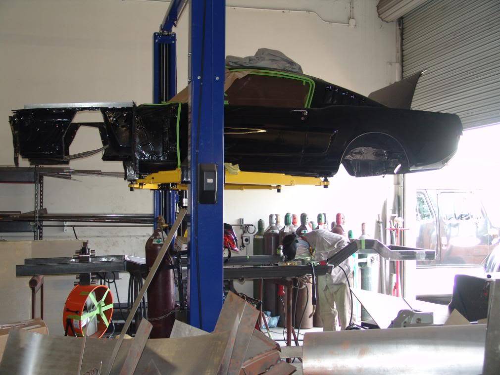

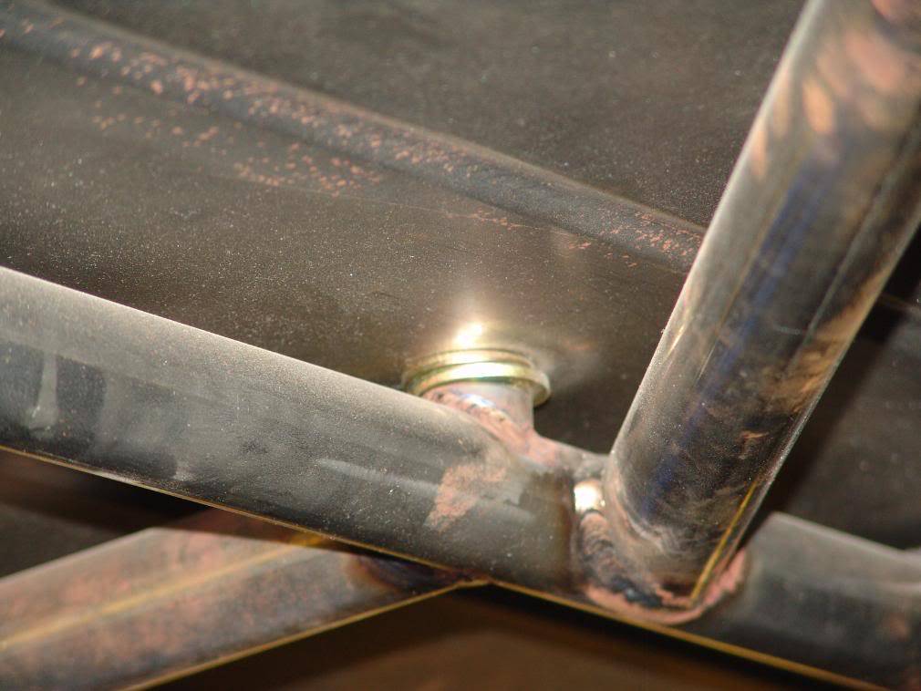

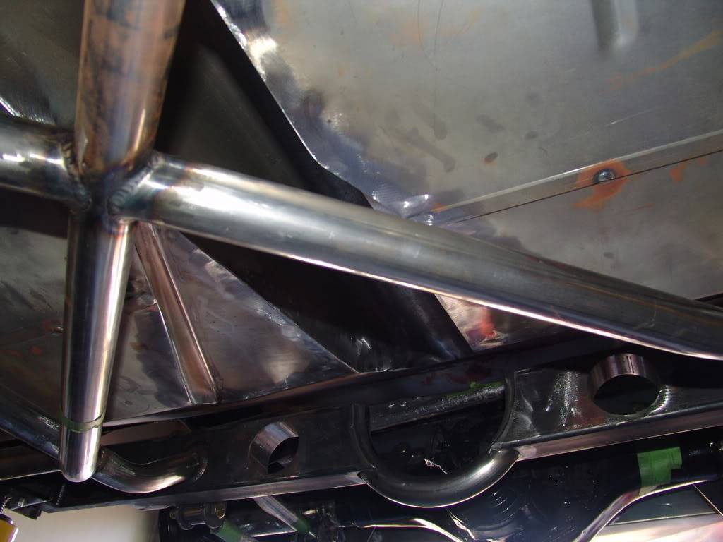

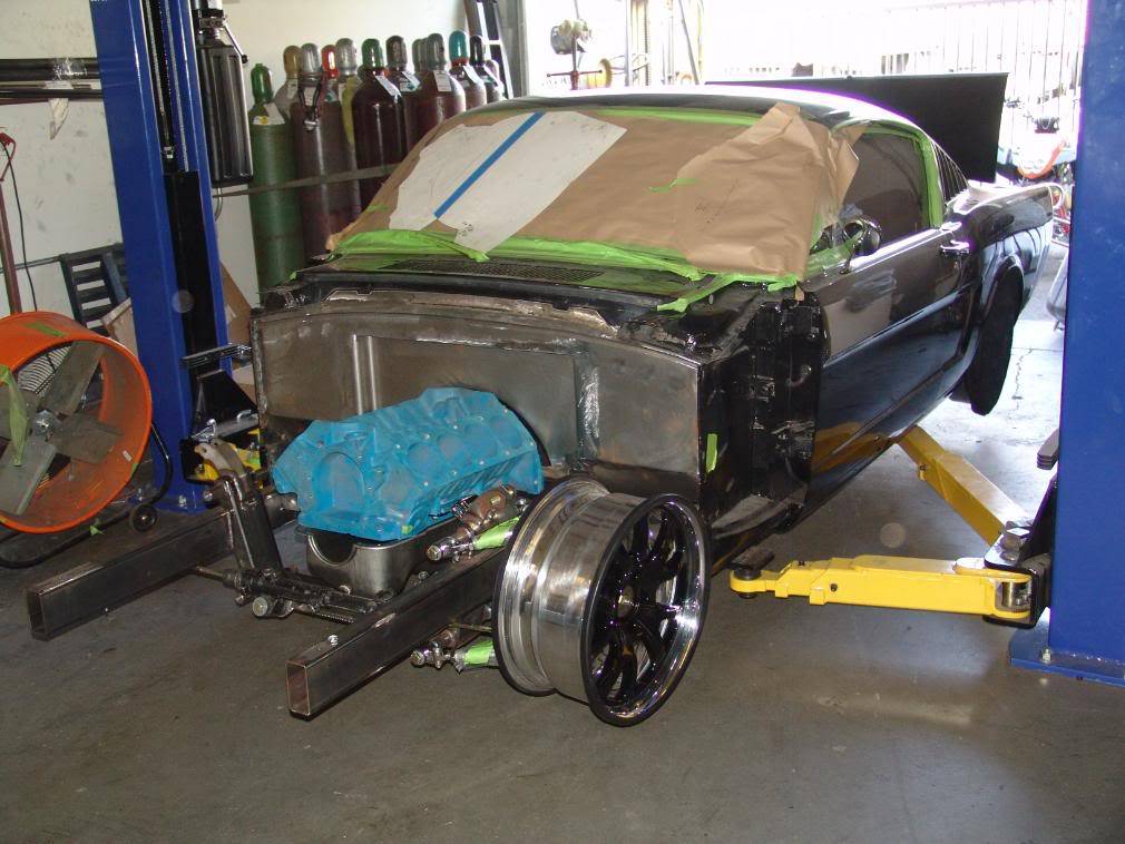

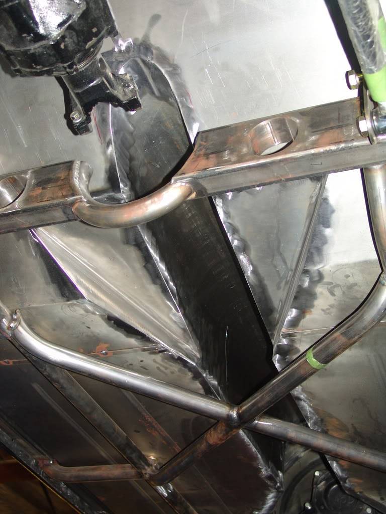

      I have a few pics of the chassis I'll post, but here's a shot I like of it getting ready to go under the car.

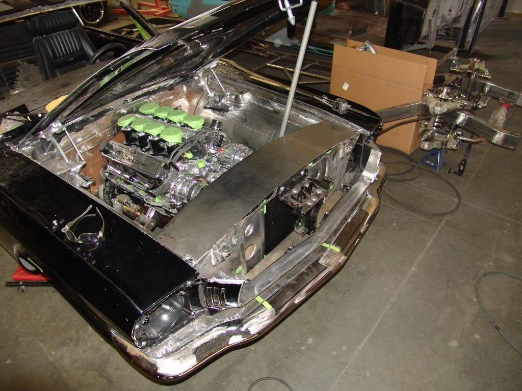

      early stages of motor mock up

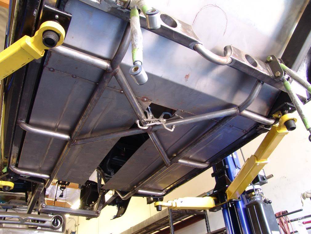

      rather than welding the chassis to the body, we opted to make custom mounts (not shown, the washers are for mock up) that will make for less road noise and nicer overall feel to the car.
      some trunk work
      basic fuel tank

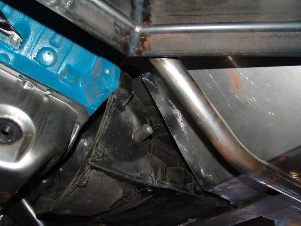

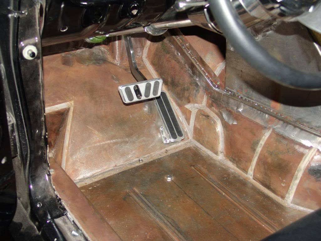

      starting on the trim for the tunnel
      you can sort of see here where the tunnel is flared for the exhaust. The exhaust runs under the drive shaft then exits and go through the frame.

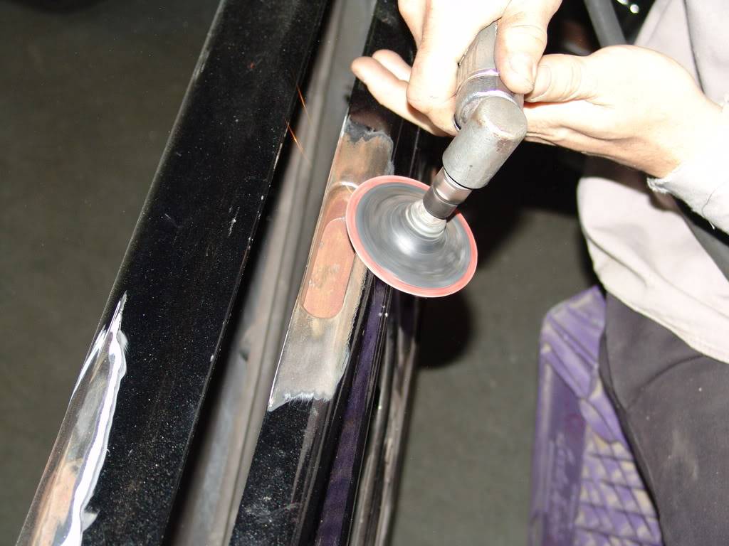

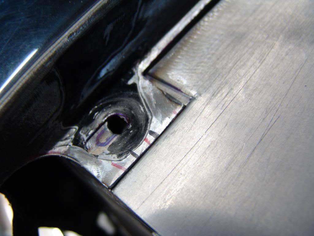

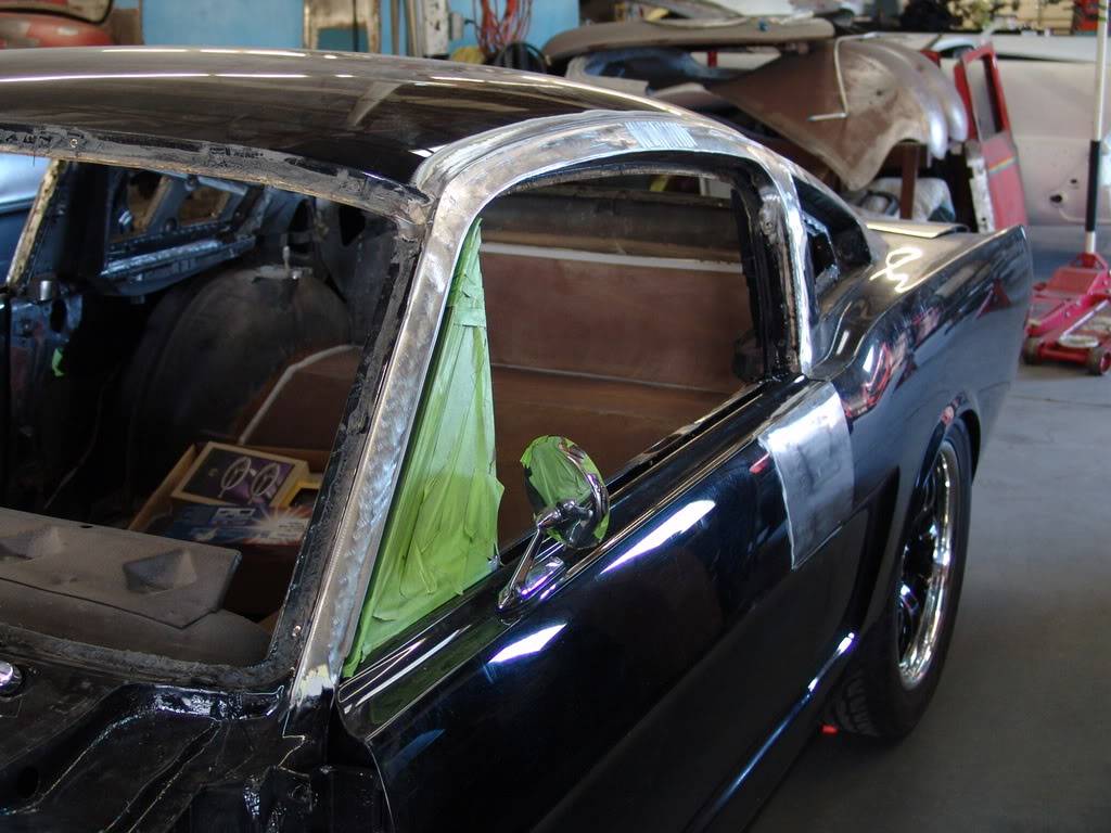

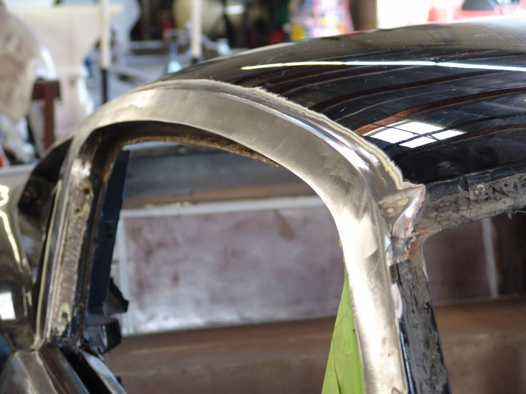

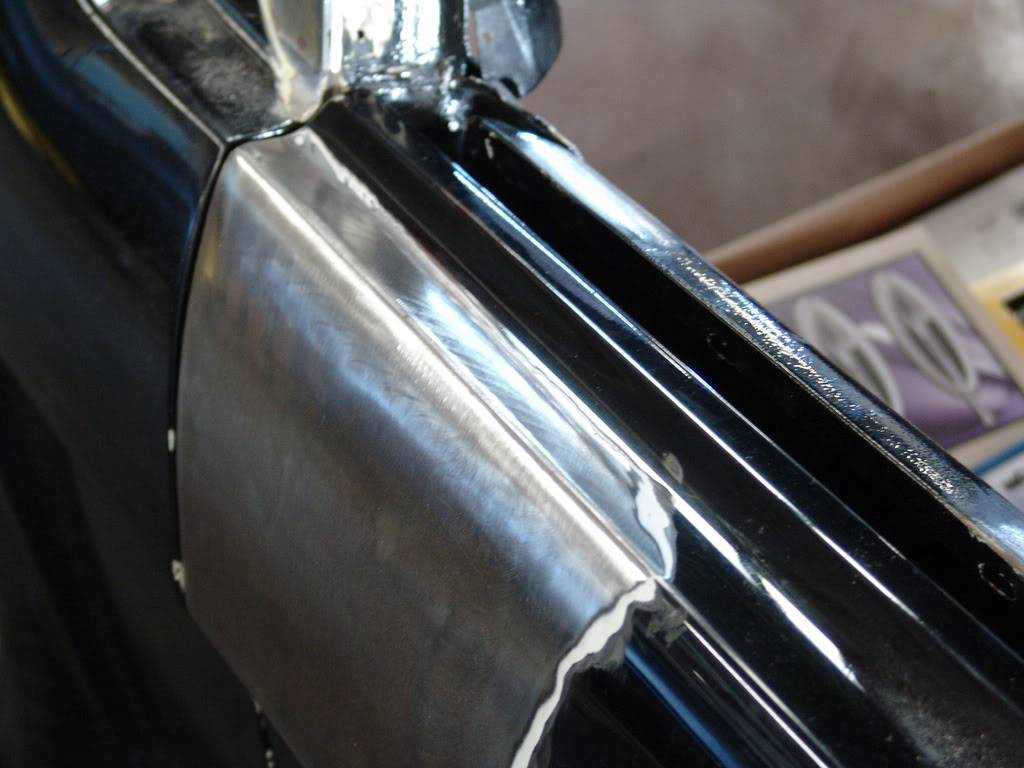

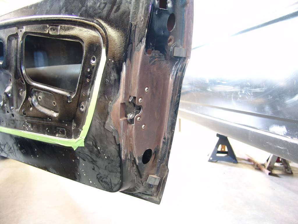

      you can see here the drip rails are shaved already. Here is Geoff working on the door gaps.
      A cool little door pull was added ( I call it the change holder)
      handles and locks shaved...
      bear claw installed along with the new striker

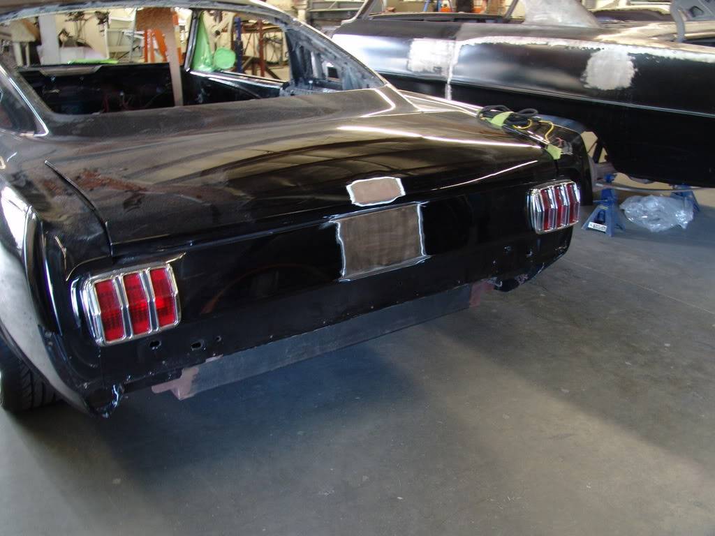

      gas filler and trunk lock are gone

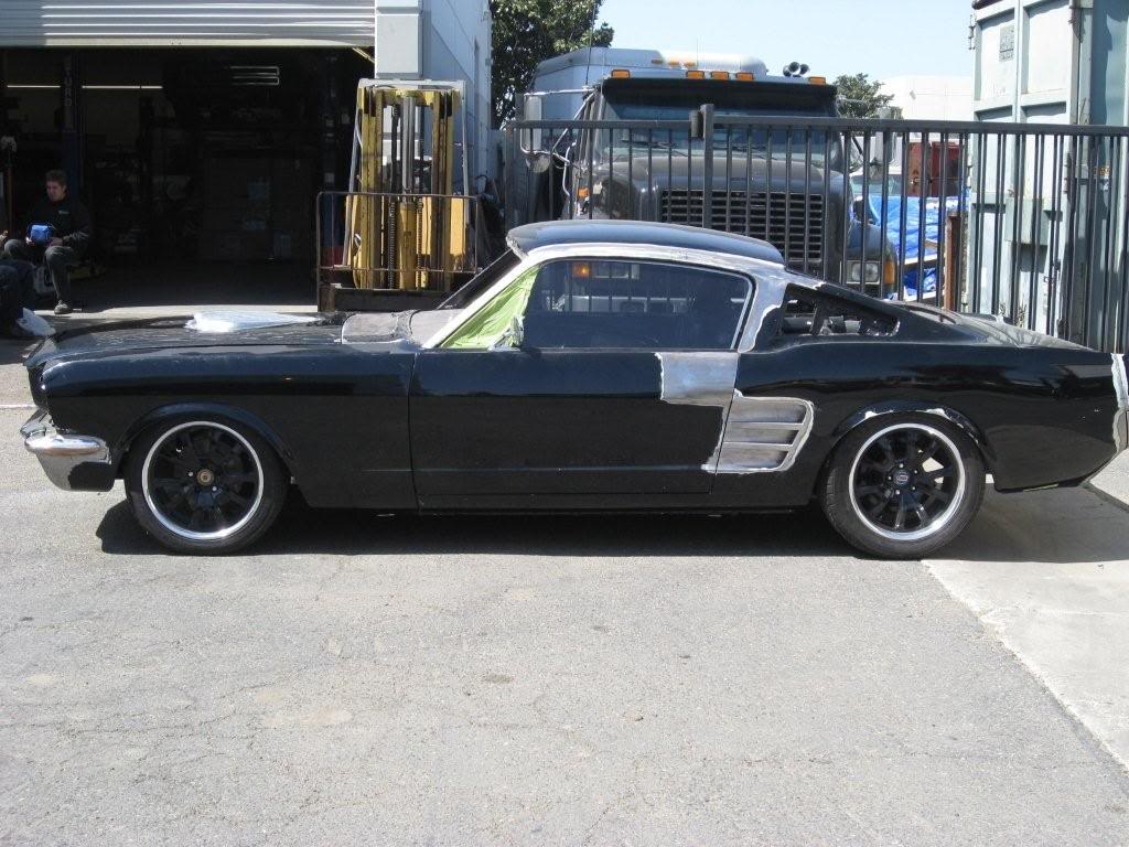

      couple overall outside shots

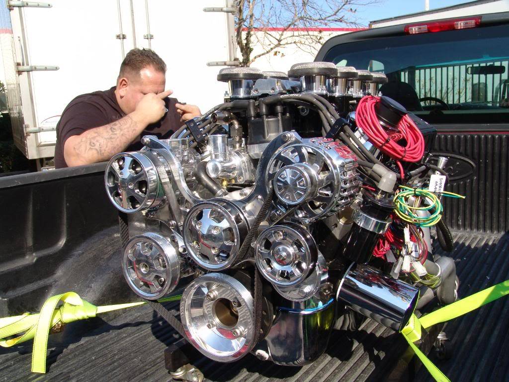

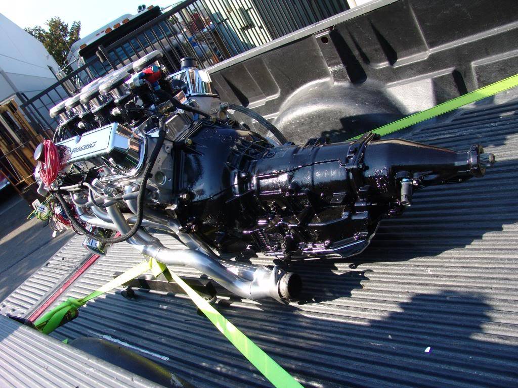

      sweet, the motor showed up.

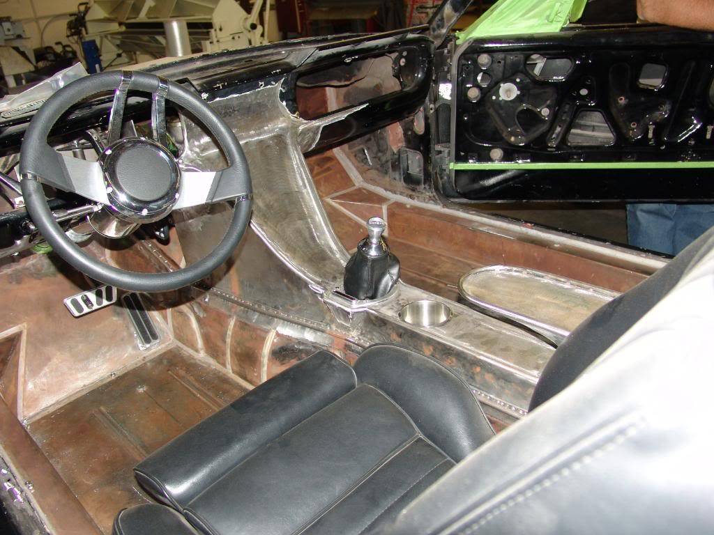

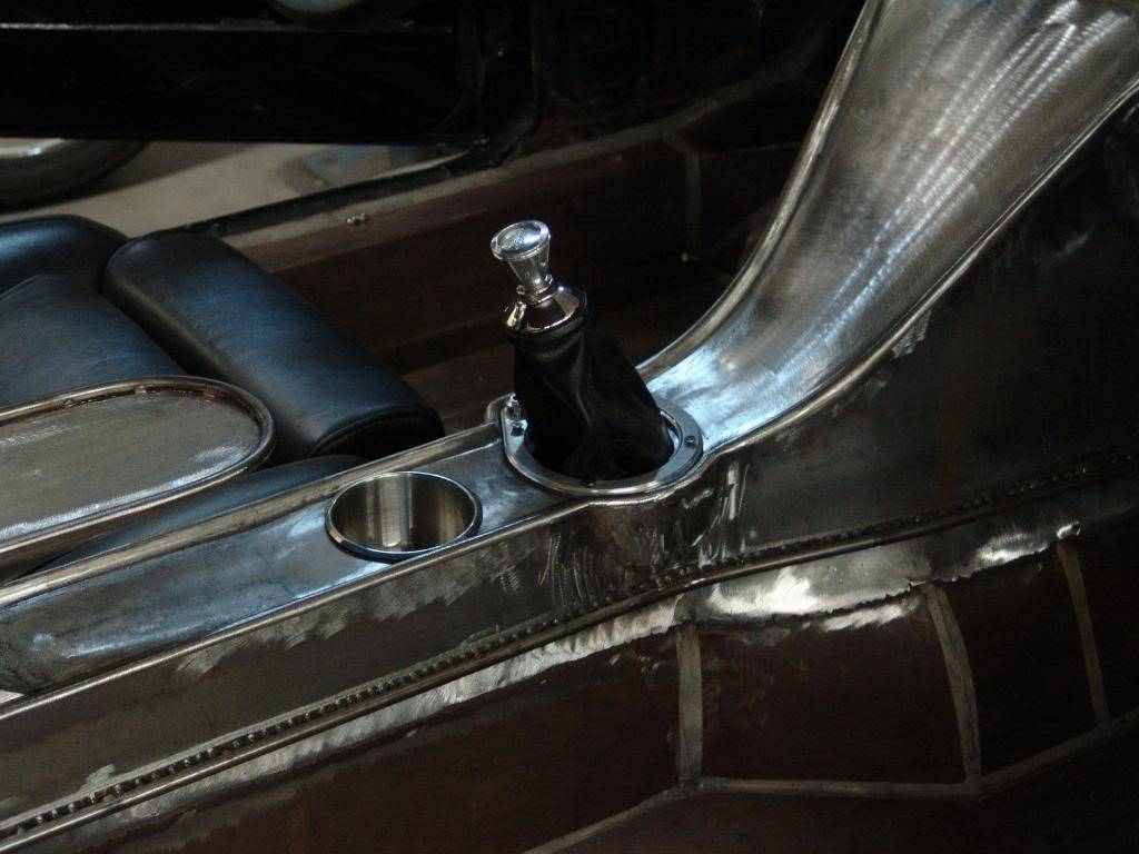

      Custom center console

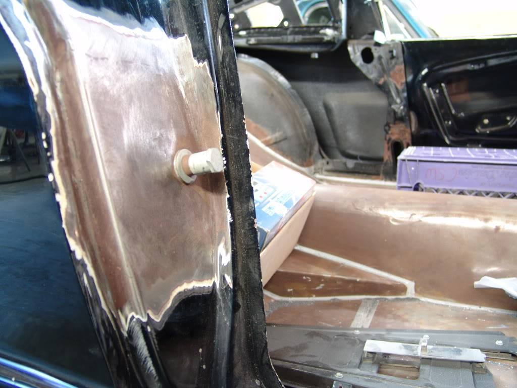

      This is a good shot to see how the chassis sits. On most full frame Mustangs you lose precious seat height. The way we do ours you can channel the body right inside the door line, and retain full leg room.

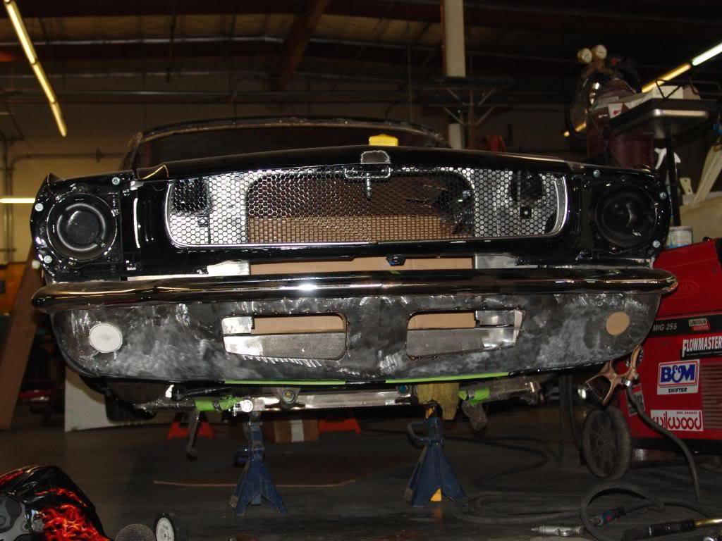

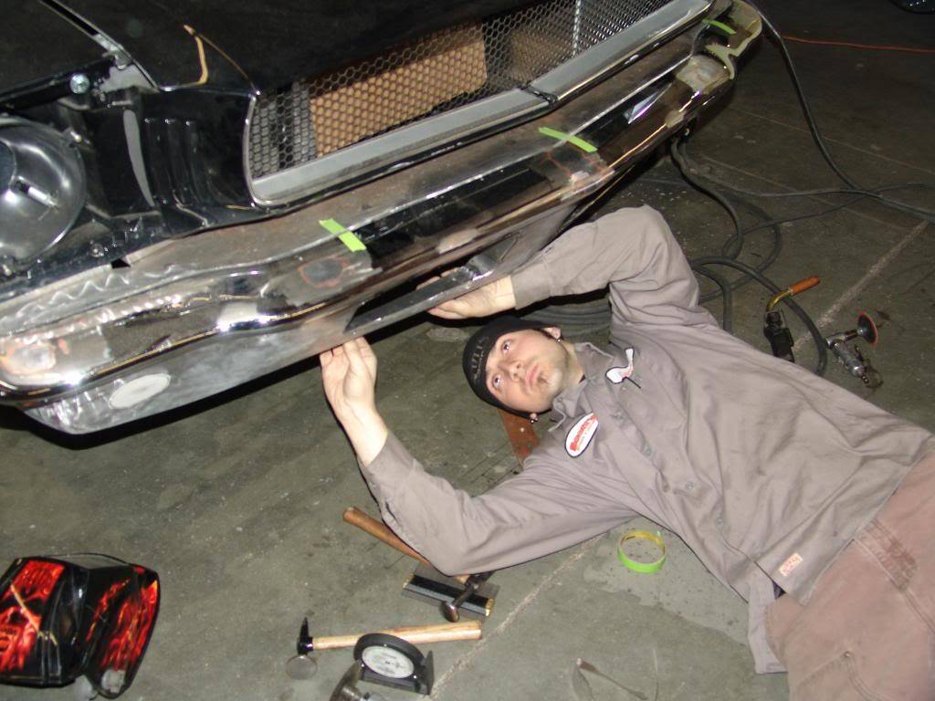

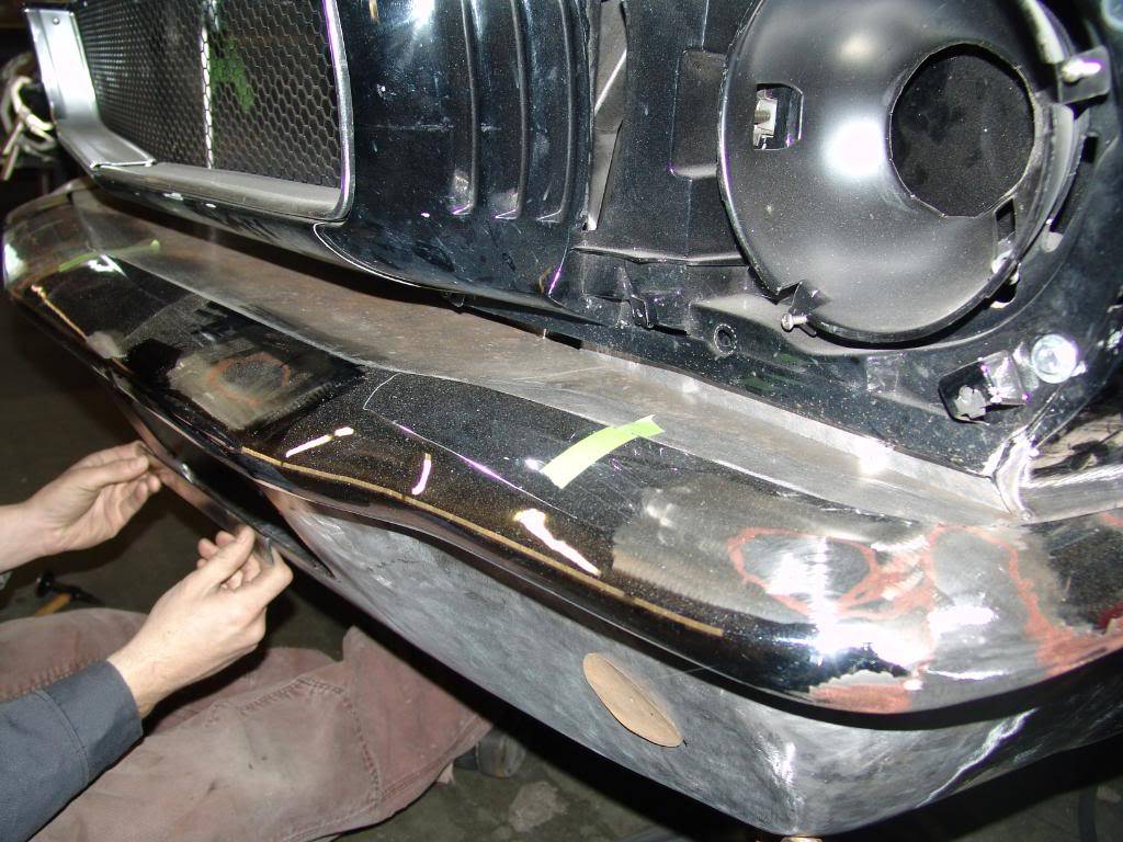

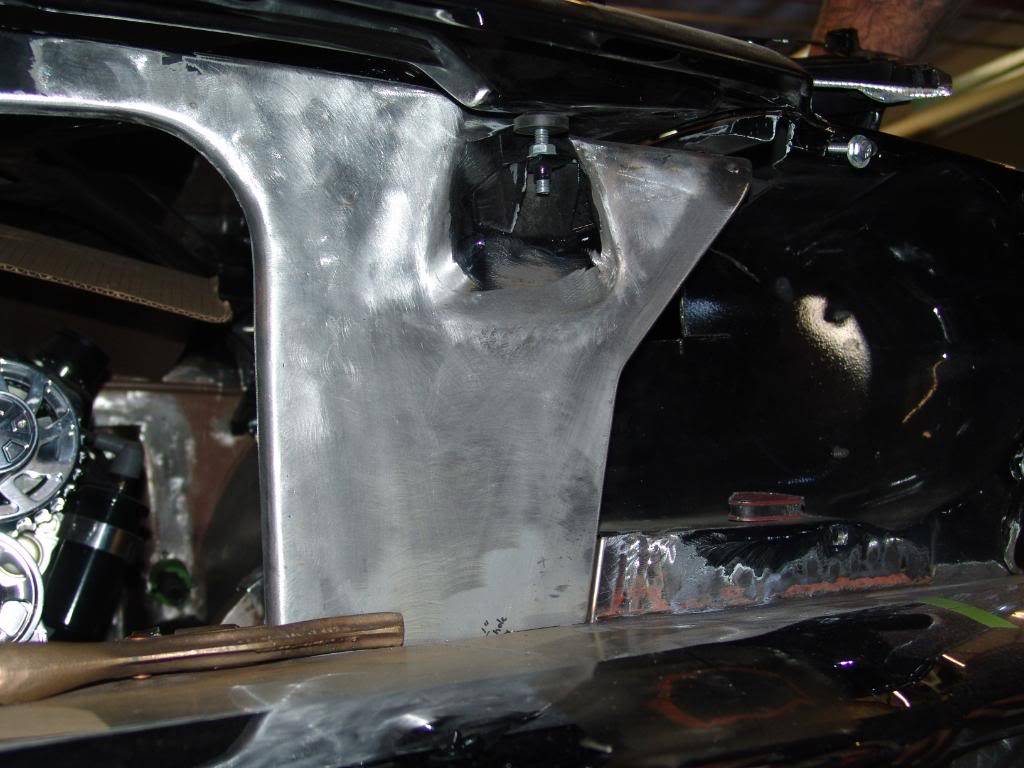

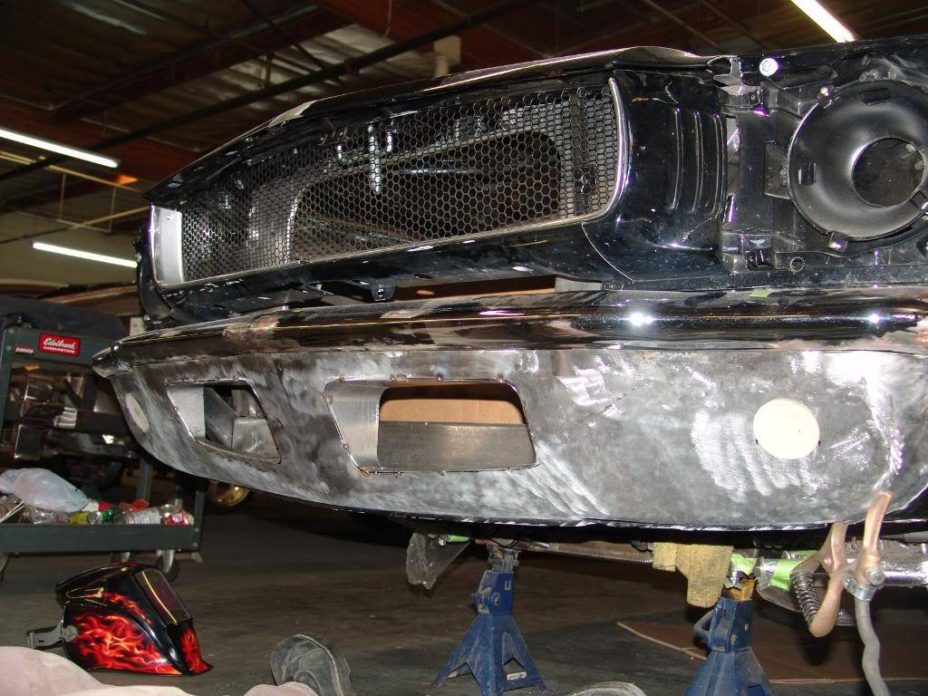

      This is the beginning stages of the new front end. Geoff made a new lower valance
      not sure if you can tell here, but the filler peice has been made to fit the new bumper that has been trimmed, recessed, raised, narrowed, and what not, LOL
      New bumper location from the side view

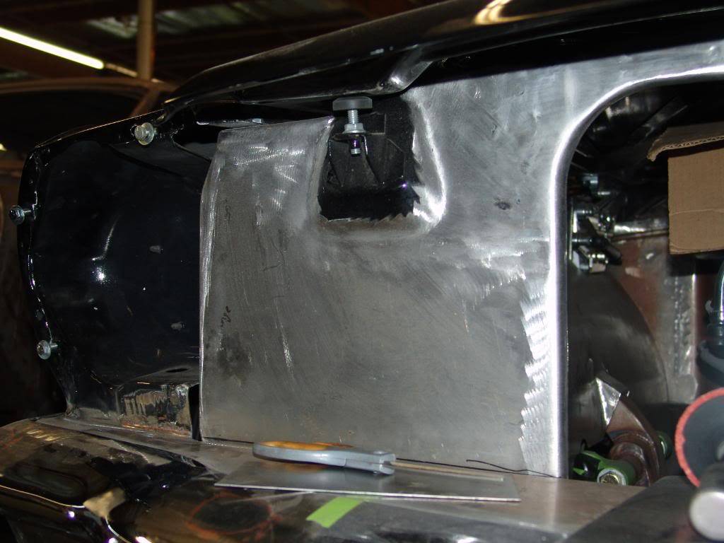

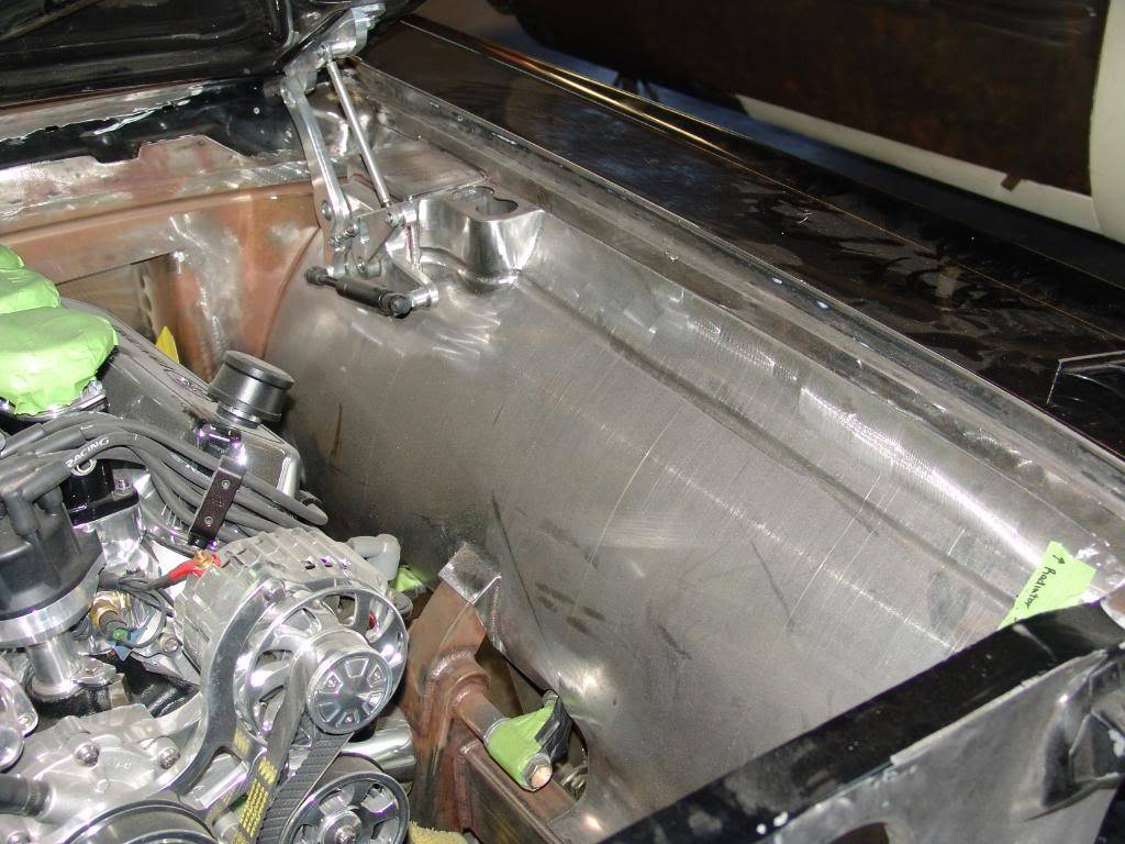

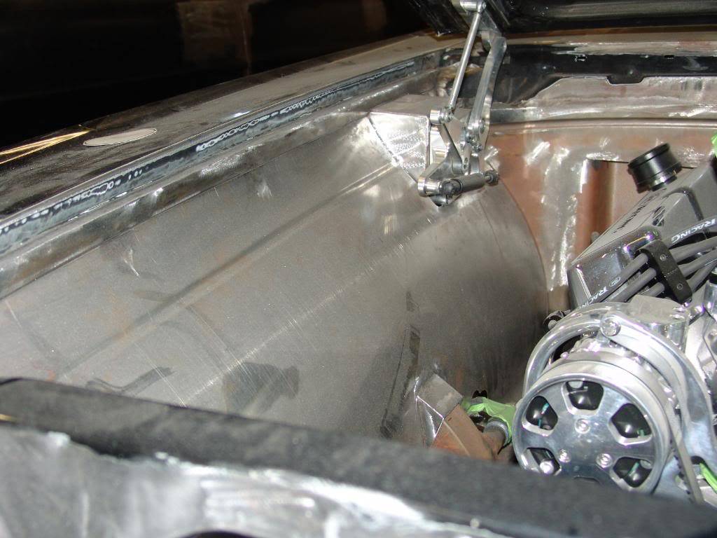

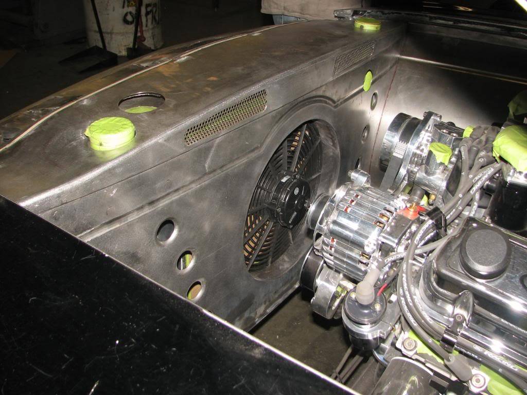

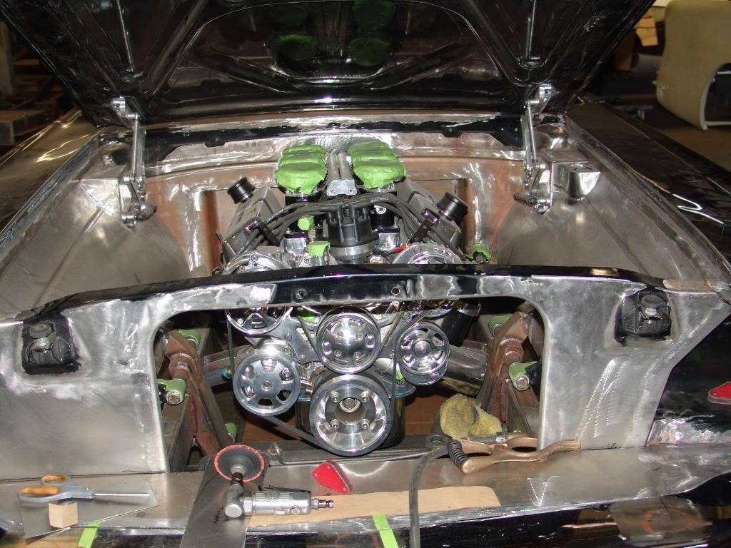

      New inner fender panels complete with body line that wraps around.

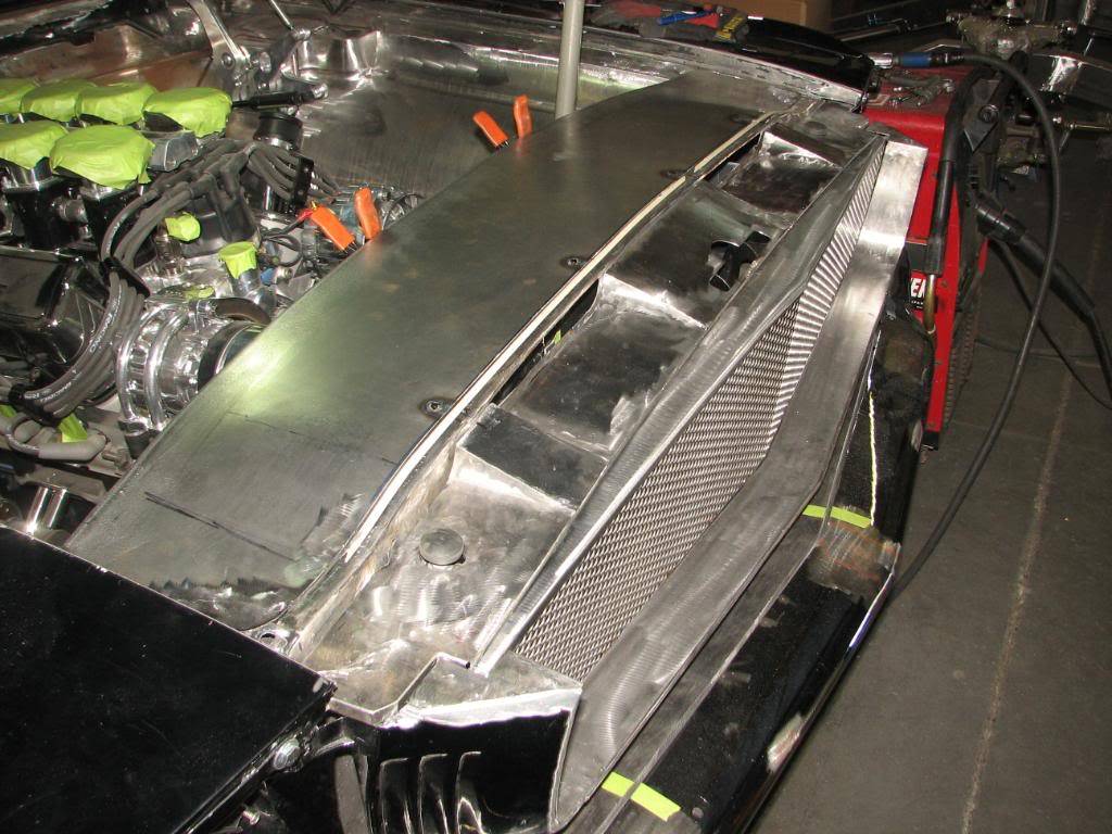

      core support has been given a bit of treatment

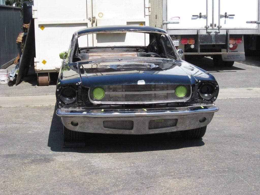

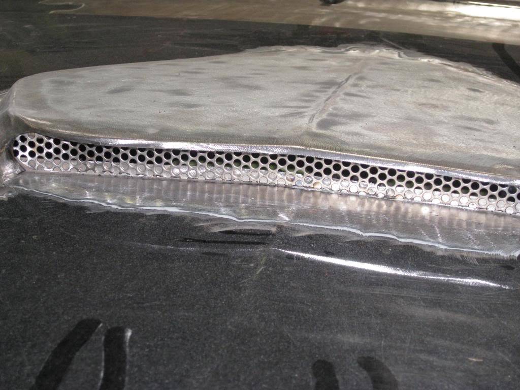

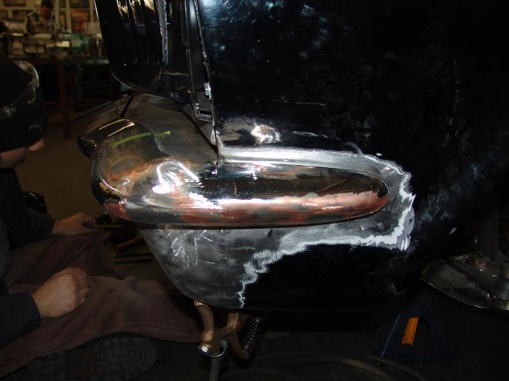

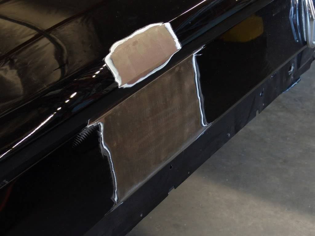

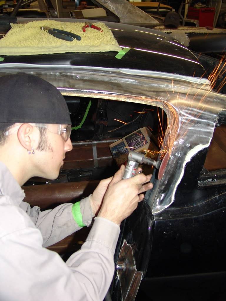

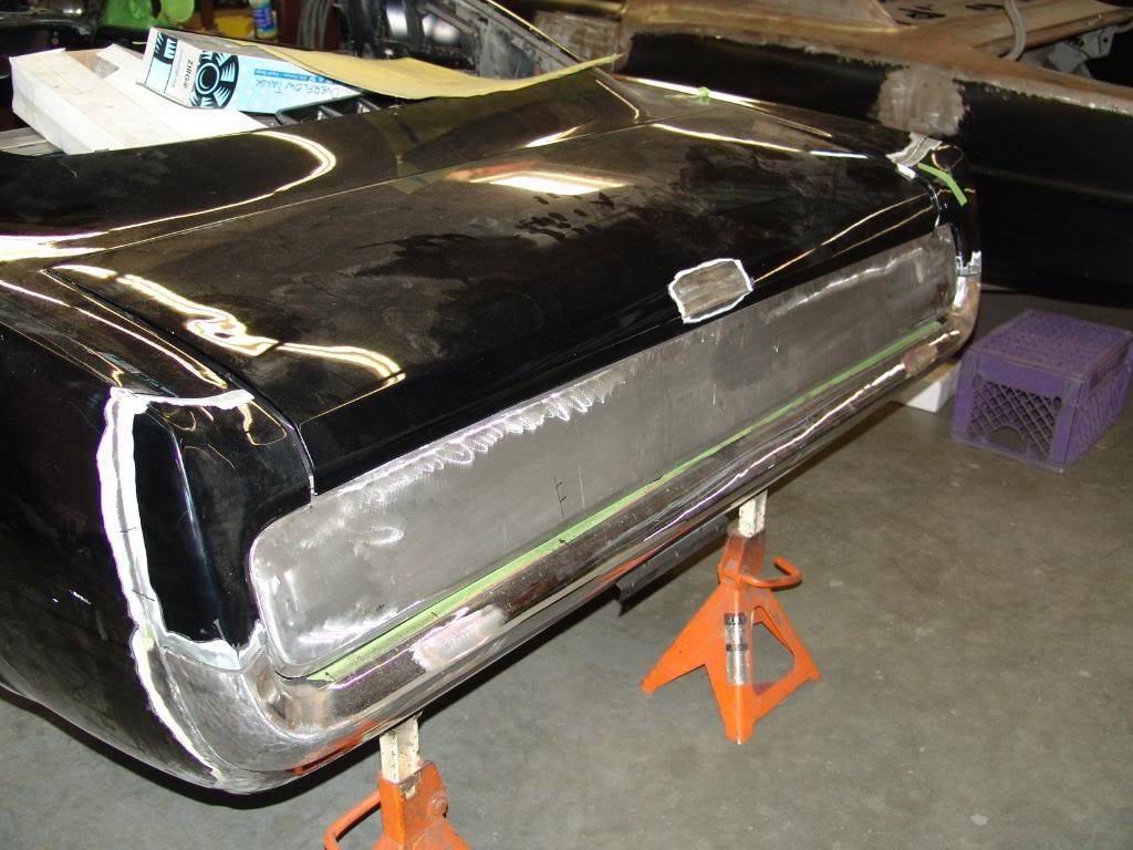

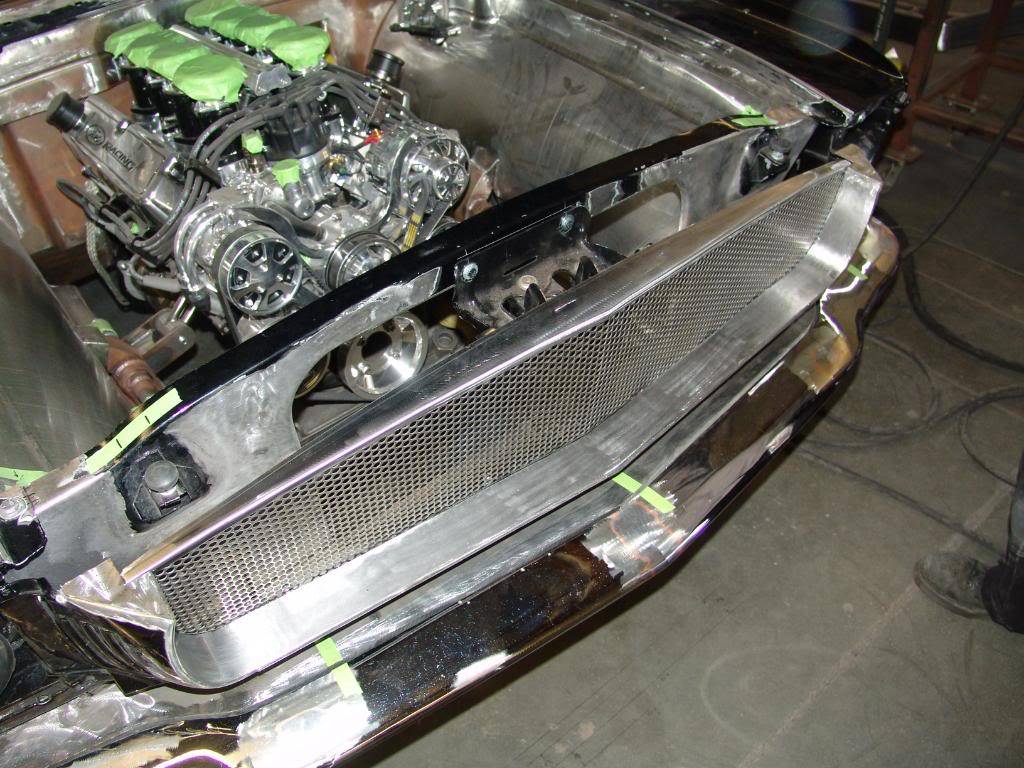

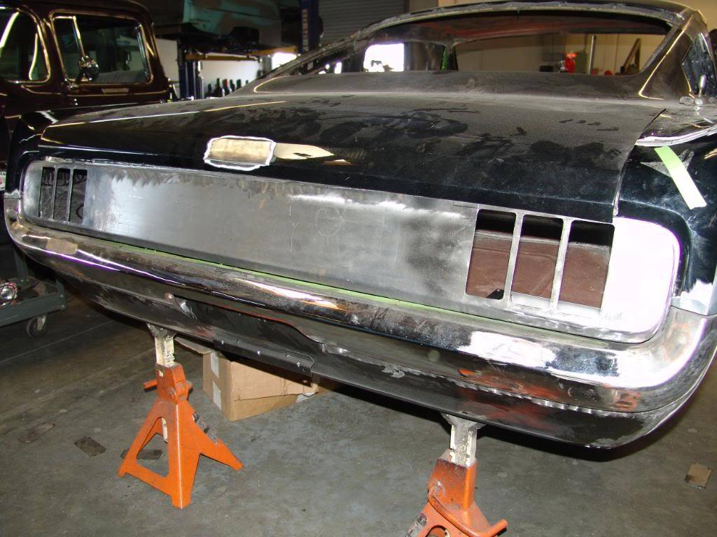

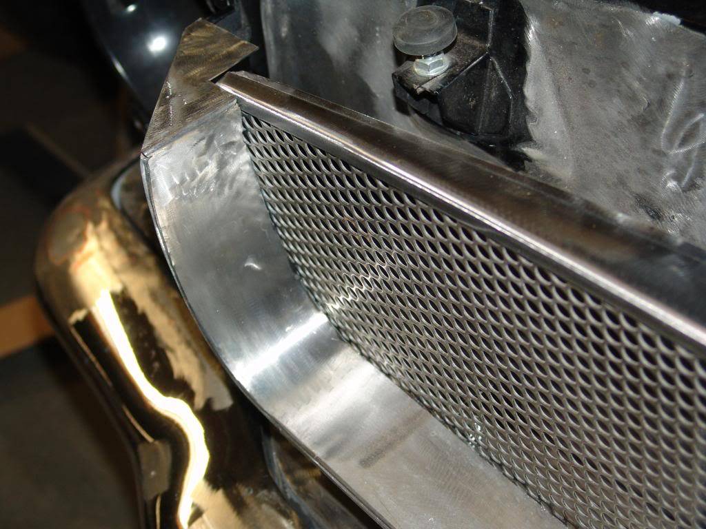

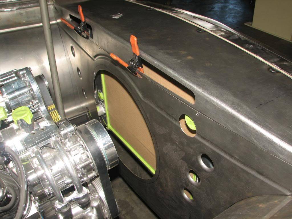

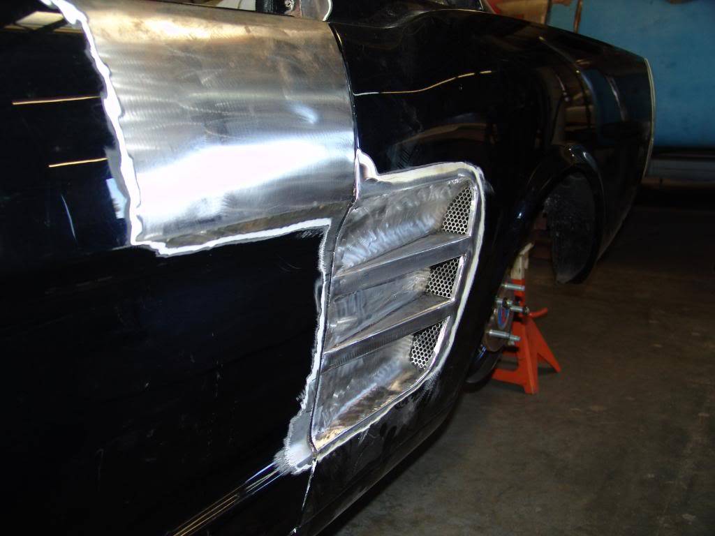

      The car was really missing something. Oh, I know, how about a set of side scoops. These have the matching mesh that is in the new grill

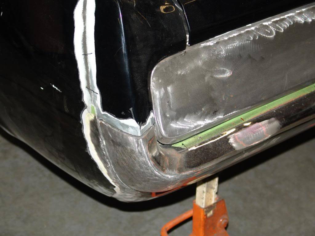

      the rear ended up getting a new panel and the rear bumper was narrowed and recessed.

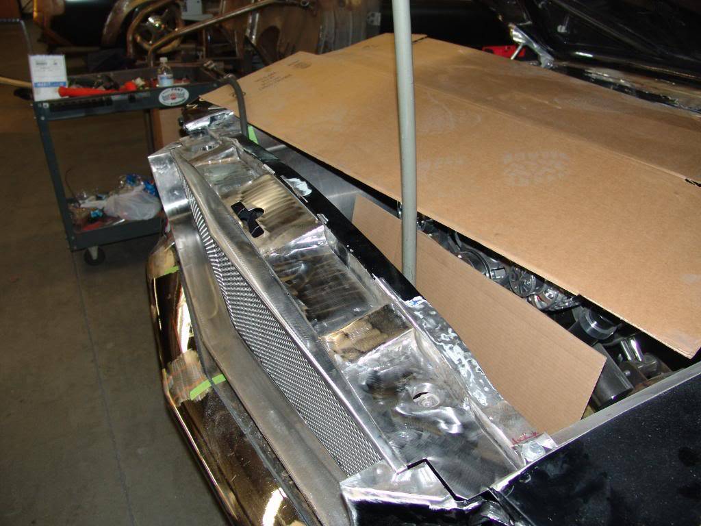

      New grill trim was made out of sheet metal and the old pt metal one was ditched

      core support cover and trim pieces

      here's a shot of the rear. A custom set of led's were made. they look pretty sweet

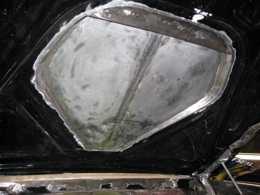

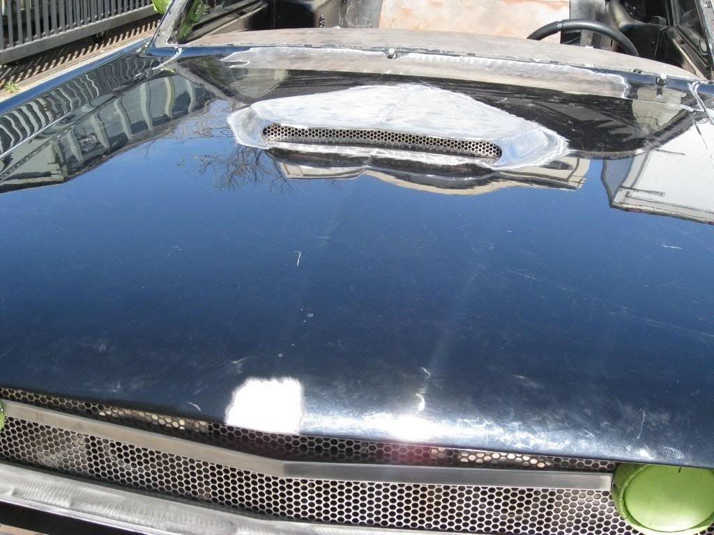

      here's an under shot of the hood scoop. It's functional and retains the factory contour under the hood of the bracing.

      Well off to paint.
      we really wanted to stay away from the big scoop thing, once it's all painted, i think the hood and all the proportions are going to look fantastic.
