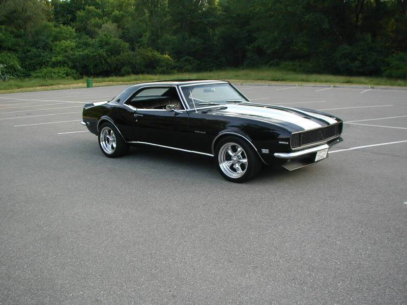

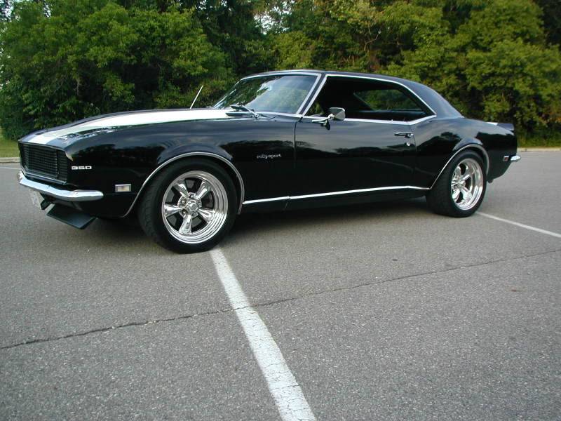

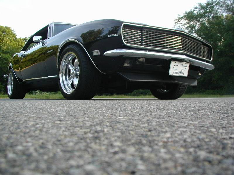

      PS: Thats a gorgeous 68 you have there.
