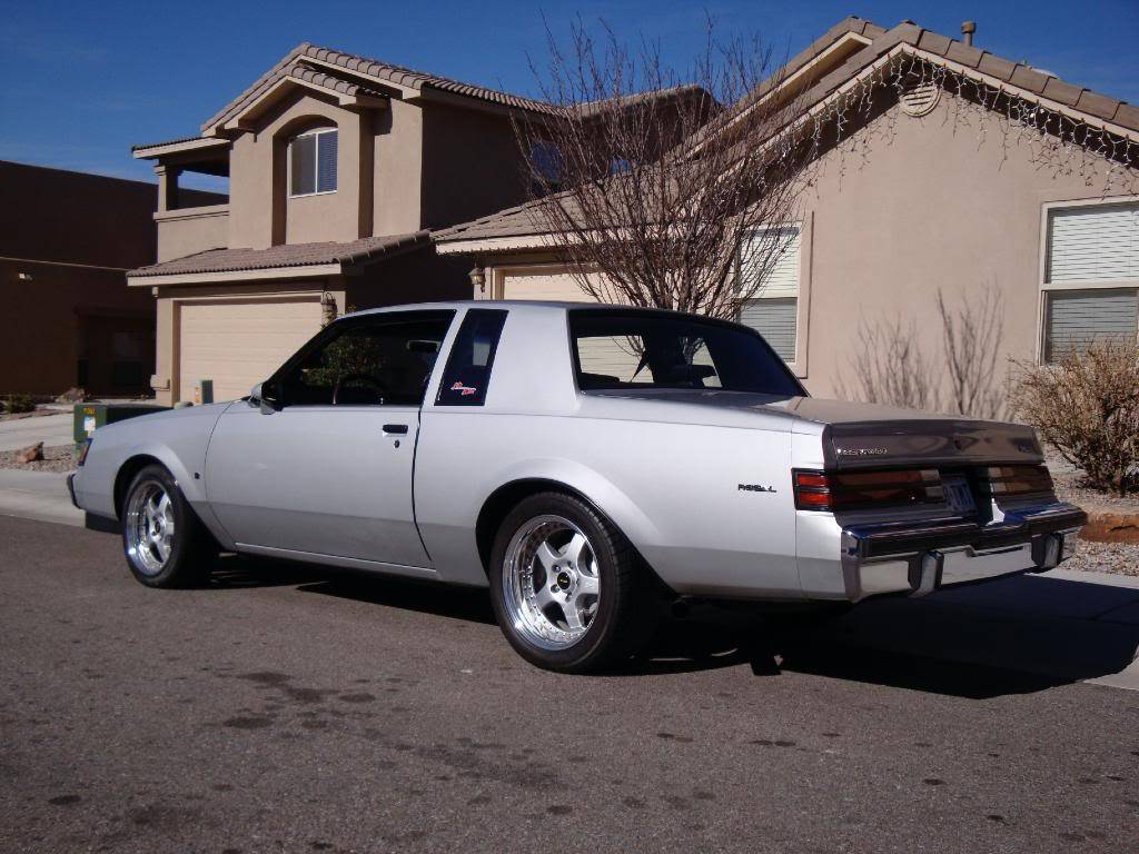

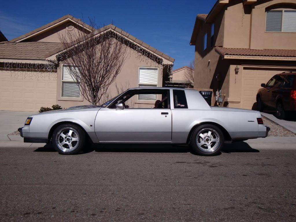

      Although not the best pics, you can see how the car sets with my current suspension combo:
      Although not slammed like some of the great rides on the site, I am happy with how it sits. And besides that, I move about every 2.5 years and never now where I am going to be living next, what the roads are like, etc., so I do not want to go too low until I settle down permanently.
