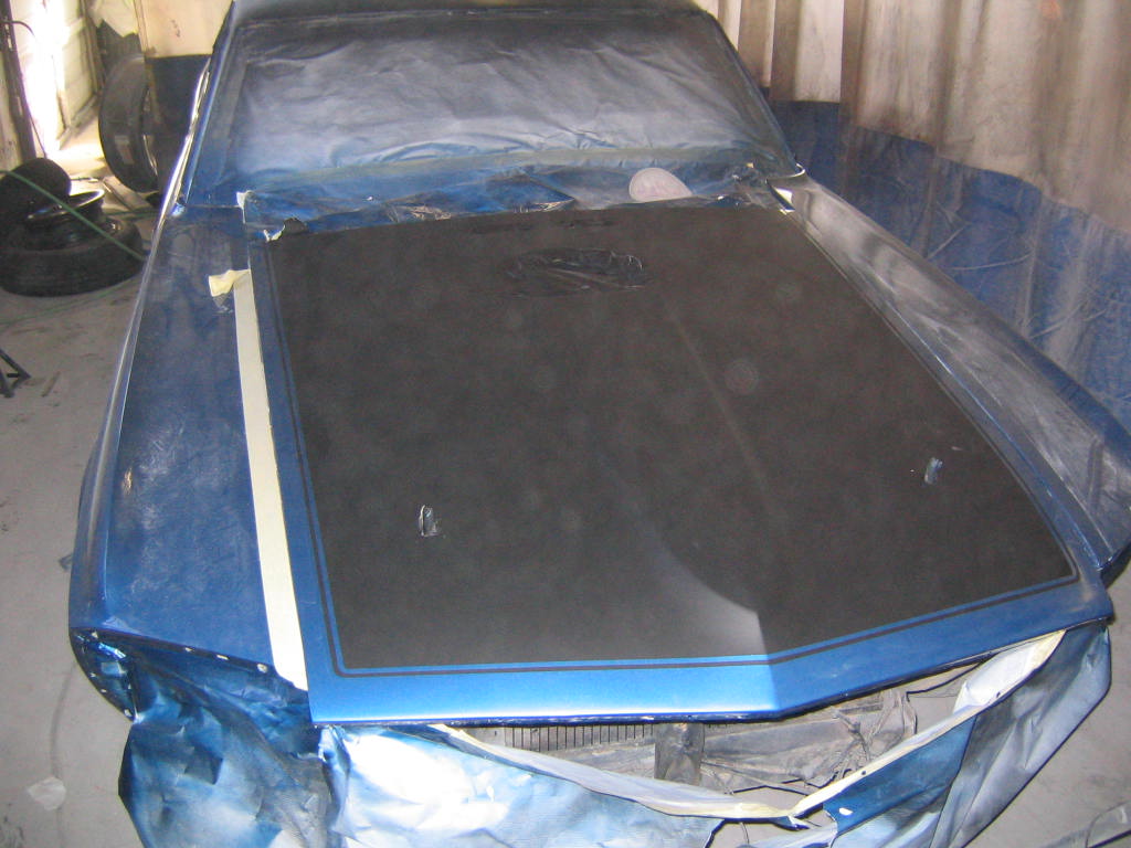

      i have that on the hood, taillight panel, and headlight buckets of my 69 gt coupe.

      here is a better pic of it on my car, it's still a bit dusty in the pic, but near as bad as the first one i posted. that's what i get for living in west texas i guess, anyway here is a link to the pic
      http://www.1969stang.com/gallery/bni...ar_hood?full=1
