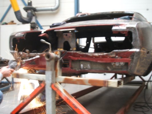

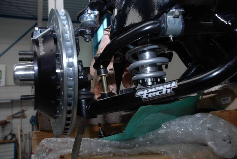

      Posting this for my buddy Erik since I shot some pics when I gave him a helping hand last week.
      Introducing a overseas '68 Camaro located in Amsterdam, the Netherlands.
      Three years and counting body off restauration. A turbo-ed SBC, 6 speed manual, Moser rear end. Erik will post the details. All parts from Frank @ Prodigy.

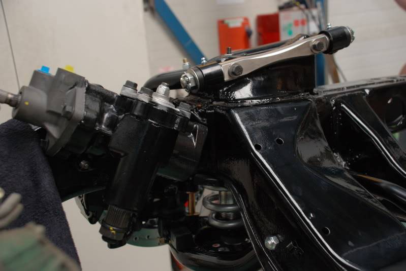

      Nice! What steering box is he using?
      It's the 600 series, quick ratio from DSE

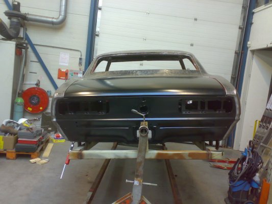

      Thanks Cliff for posting the pictures!!

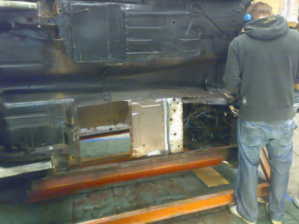

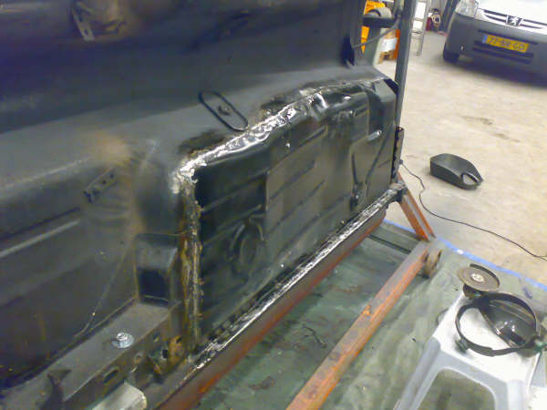

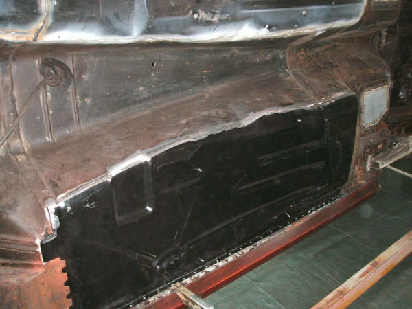

      I drove the car for 5 years before I started disambling it.
      I was in shock off what came above. That's when I decided to go all the way.
      It got a new trunk floor, rear frame, floores,tail panel. The subframe was very bad, it had rotten mounting holes.
      Erik

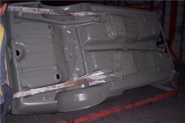

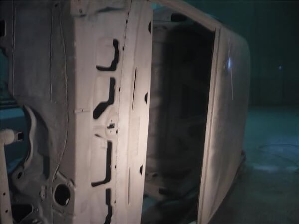

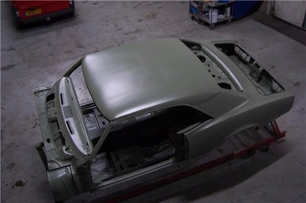

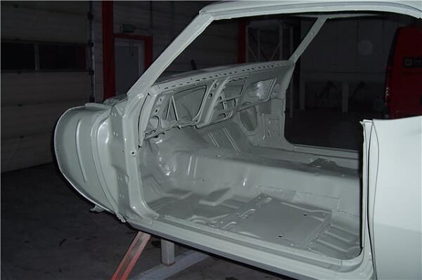

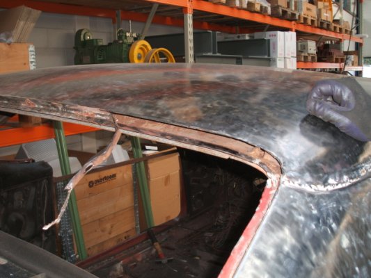

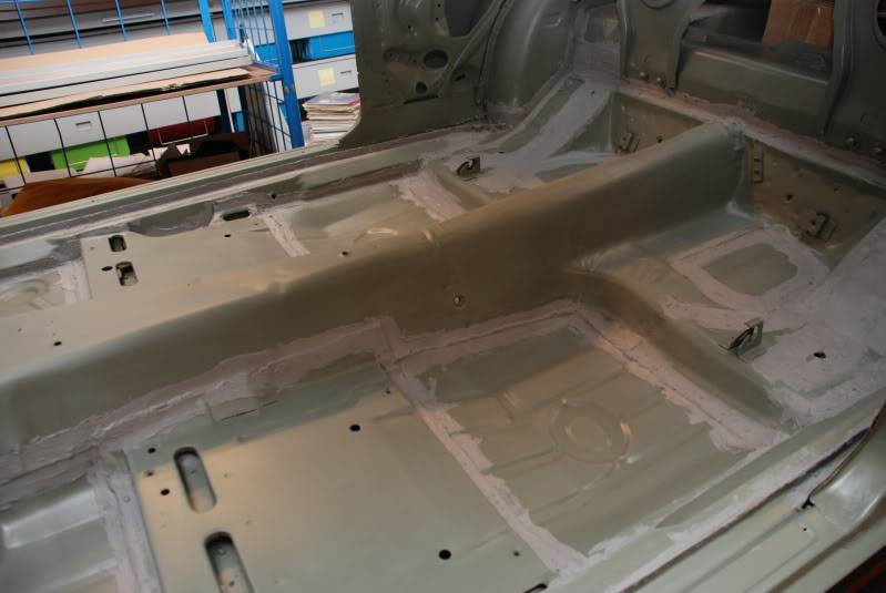

      More body work:
      Jan 2007
      Netherlands
      72

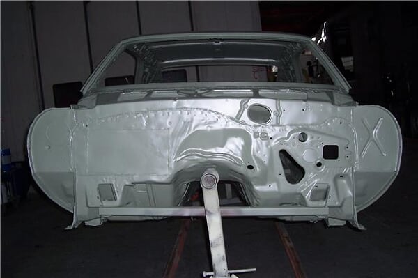

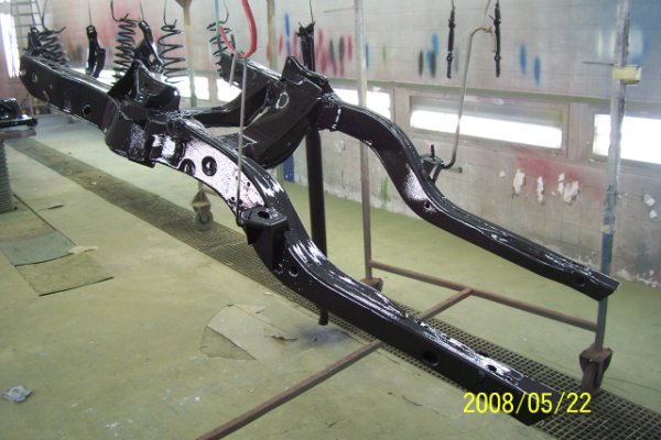

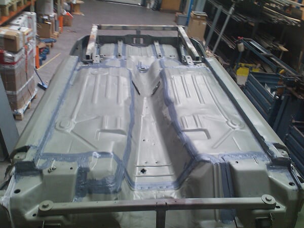

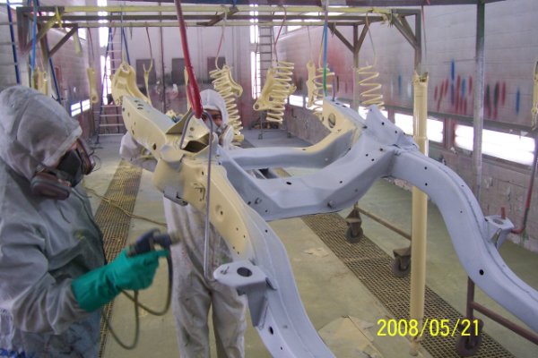

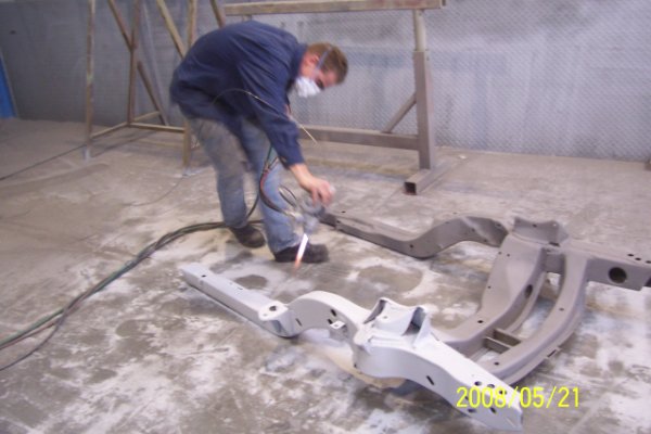

      at sandblasting subframe and body:
      Body work so far.
      Erik

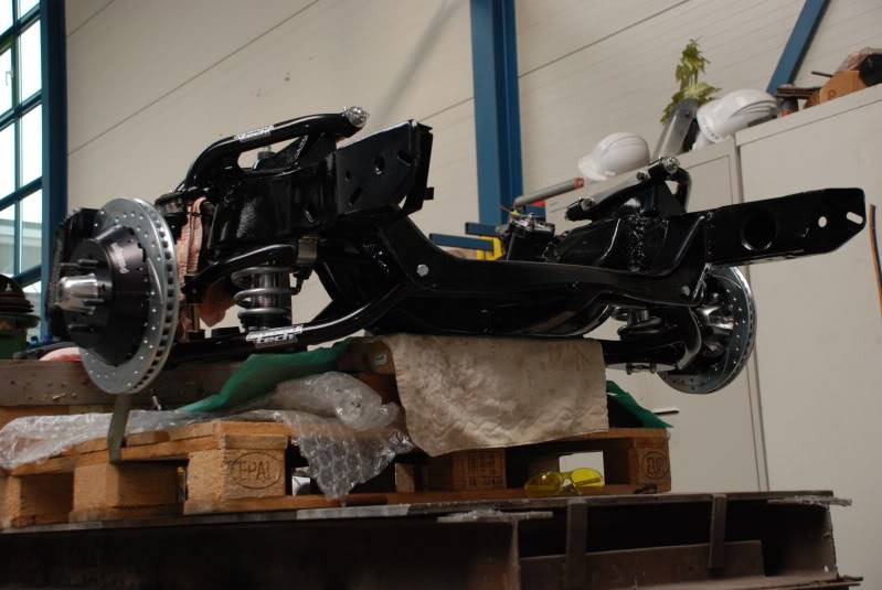

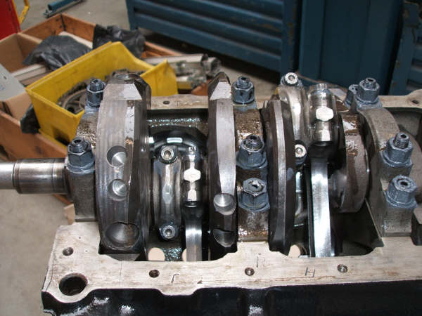

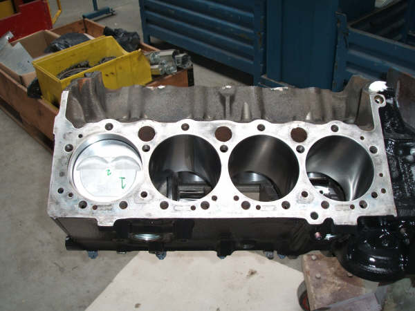

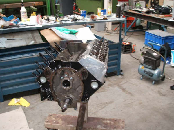

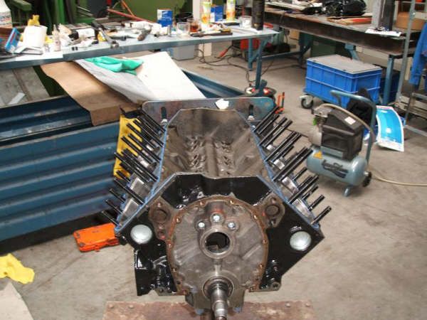

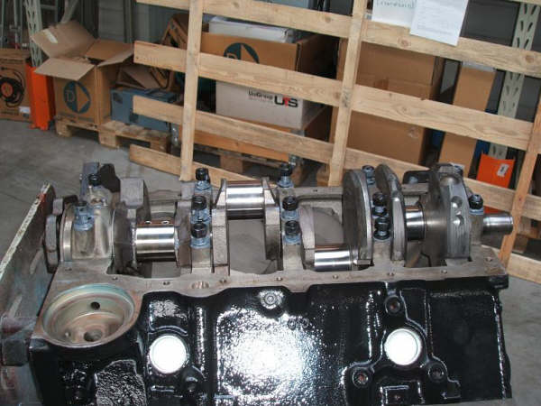

      Engine is a sbc eddy heads comp extreme turbocam martin turbo system rajay turbo.
      Moser rear 3.55 gear, tko 600 being orderd as we speak thanks Frank!!

      Thanks guys, still a lot of work but no more welding and grinding. It's nice to put it all together now. Hope to have it on the wheels soon.

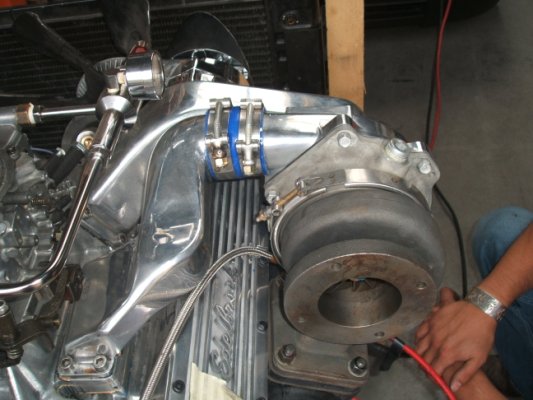

      1,753
      Help me out figuring how the turbo works please- maybe pictures from a different angle?

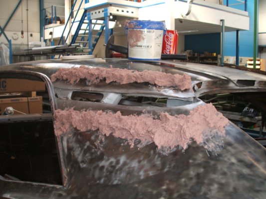

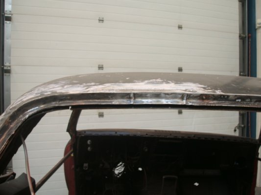

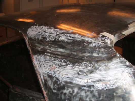

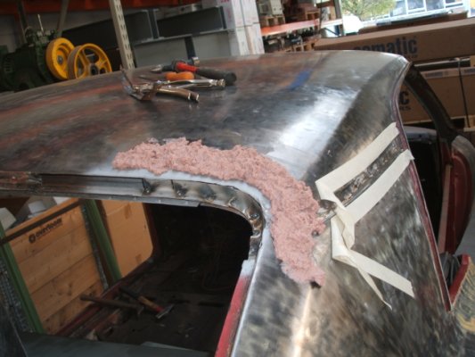

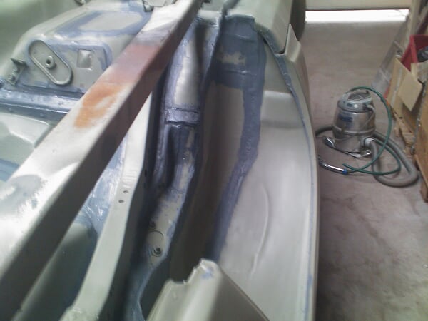

      What is this all about? Is that Bondo?
      Tony
      May 2008
      Staten Island, New York
      191
      That actually looks like something that came out of my kids diaper this morning.
      Sep 2008
      43
      looks like some heat absorbing stuff.. for the welding... not to warp panels from heat.

      Parts have to come over sea's, so it can take some time before they are here. Because of the shippingtime by boat (big parts), that takes 4 to 6 weeks, and if we have luck at the boarder. Otherwise it may stay there for a time. And you have to pay about 30% taxes.
      Yes that is heat absorbing stuff.
      Turbu system is a draw thru with a 2 pice intake manifold, at low rpm it works NA, at higher rpm it closes 2 valves and it is under boost, in the intake it hase a boost geard set at 9 psi.

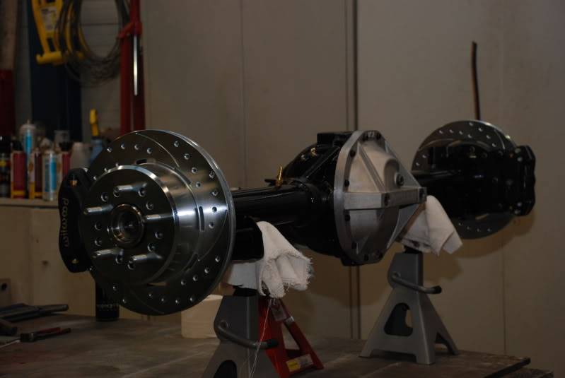

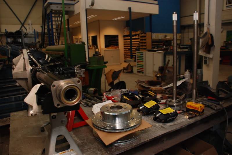

      update Moser rear

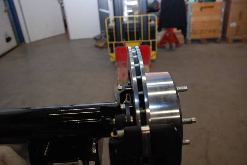

      After the rear got a POR15 treatment we decided to install the axles and Wilwood rear disc kit.
      The Camaro will still have a staggered shock set up. To prevent any caliper-shock clearance problem Frank advised to rotate and flip the rotor bracket. To accomplice the same configuration as the passenger site we even got the bracket up one treaded hole in the backingplate.

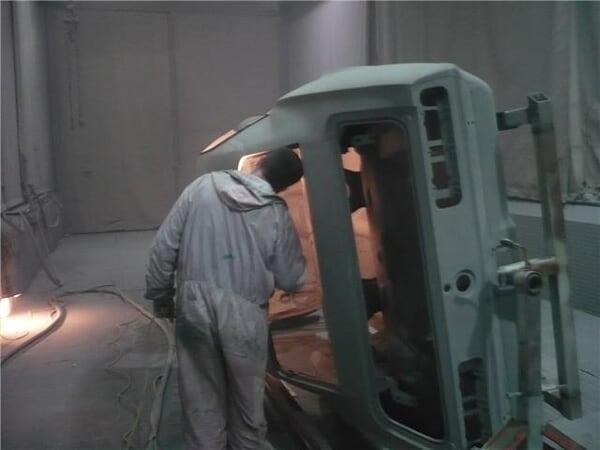

      The bottom prepared and will be finished in 2/3 weeks. After some paint we will put the body back on the subframe and rear/leafs.
