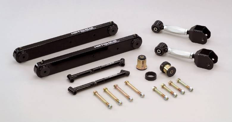

      Our setup does work really well on the G-Body. If you swap out the spindle for a B-body or F-Body spindle and use the spindle swap specific tubular arms, that also makes a huge difference, and now the new Extreme Sway Bars are out and they work awesome.
      Our rear suspension package helps a lot with wheel hop and traction, especially the double adjustable trailing arms, and the premium steering rebuild kit uses machined tie rod sleeves that are really bitchin compared to the factory stuff.
      A few years ago Hot Rod did a build up using our bars and arms (the extreme bars and double adjustable upper arms weren't out yet), and Jeff Smith really liked the setup. I'm sure Prodigy can help you out, or let me know if you have other tech questions.
