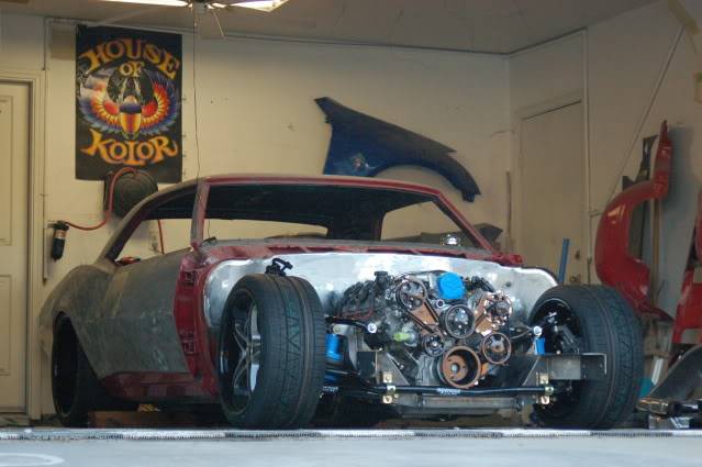

      2,624
      Quote Originally Posted by camaro2nv View Post
      There's something totally bad@$$ about the way that sits. Too bad it can't be driven. Maybe you can remote mount the radiator, box the front frame rails, paint the shell red, and clearcoat the firewall. First Camaro street rod.
