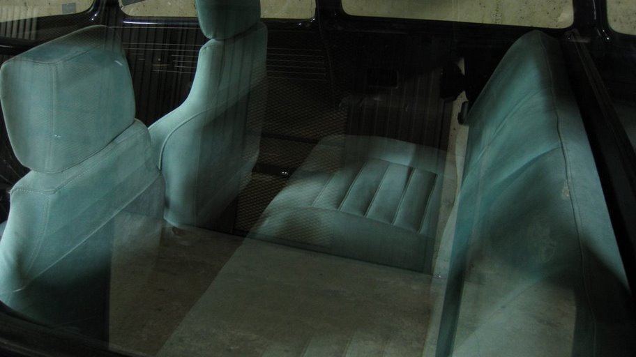

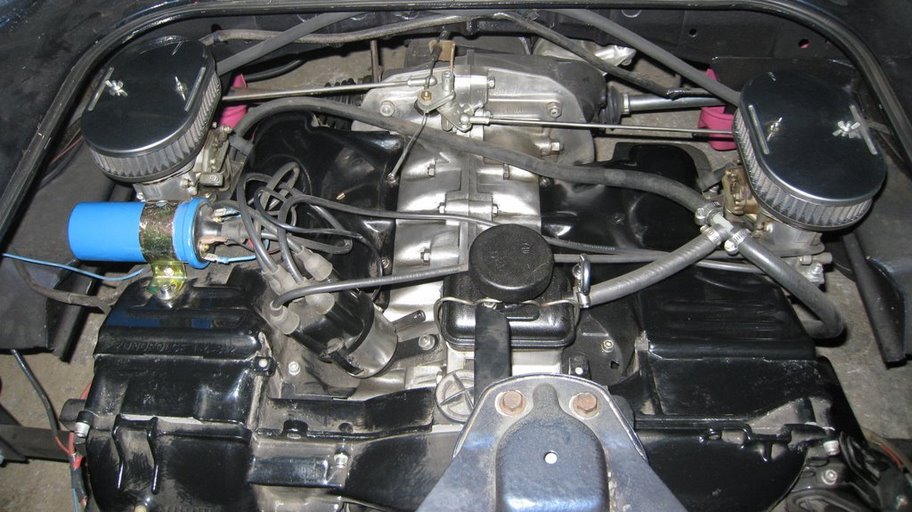

      Beautiful car and awesome job on the build. Do you have any pics of the engine and interior?

      Quote Originally Posted by Tig View Post
      Thanks!
      here some pics:
      Engine needs some cleaning, but the car never saw a drop of water since reconstruction 10 years ago!
      So... there is some dust in some places.
