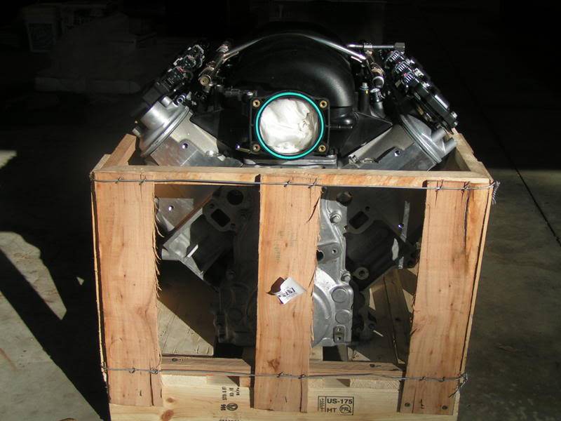

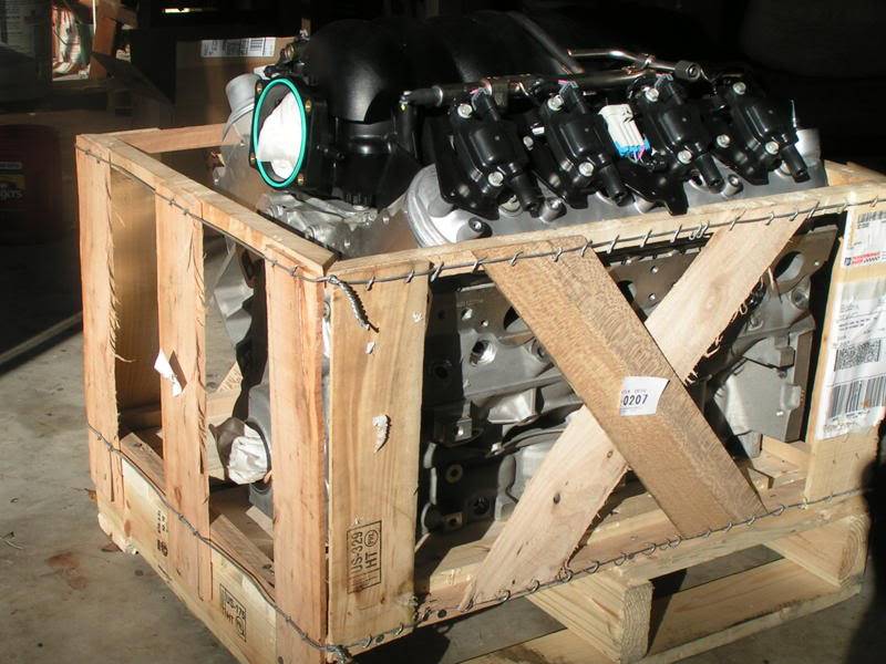

      Hi hereīs update and step forward after setback in engine purchase.when I lost the ls1/ls6 corvette engine I bought do to the owner stop paying his loan on the car.
      This week I got a another engine but the money from first engine is most likely lost forever
      And Hers is the new one
      The block is L92/Ls3 6.2 LITER aluminum. 4.065 BORE with 823 heads and intake from 08 CORVETTE
      More info when it arrive here in Iceland

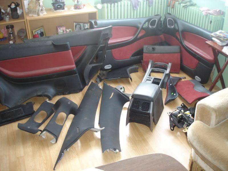

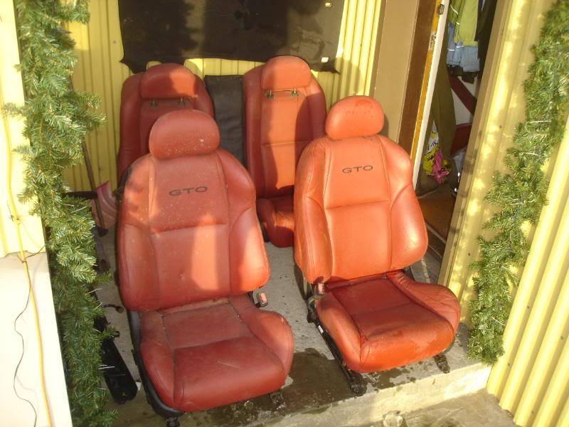

      Ok here is my part of this venture
      GTO Interior and body, dash WIRE HARNESS
      some parts will be easy some not
      the big problem is red
      and blue
      need new color for my Chevelle

      I'm very curious to see how the interior part of this goes, I have been considering using GTO front and rear seats in my project (72 CHevelle) as well

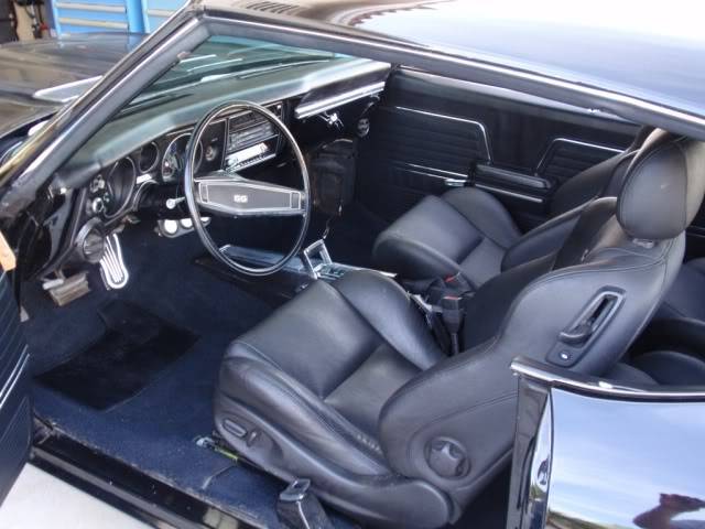

      We put GTO seats in a 70 Chevelle we build a couple of years ago. The fronts sit pretty high my buddy and I are both 6'3"). the back seat can be cut down to fit. The seat back will be really high but enough off the bottom and it fits nice.
      We had another shop dye leather to match and removed the GTO logo from the seats. In the end it would have been cheaper to buy after market seats for the fronts.
      They are beautiful though!

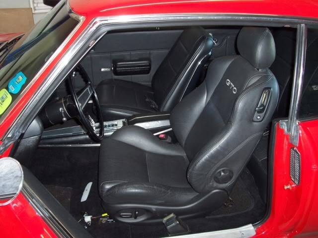

      Wayne has done the GTO seat swap. You may want to ask him about modifying the front seats to sit lower. I know that he did some fabrication.
      https://www.pro-touring.com/forum/sh...ad.php?t=25530
      https://www.pro-touring.com/forum/sh...&highlight=gto
      I am 6'2" and loved the way I sat in Wayne's 70 Chevelle.

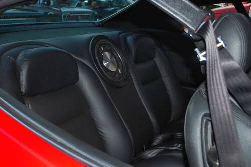

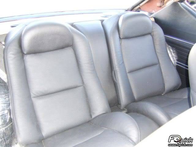

      here is a picture of my mock up. I will post up more pics over on my build as I will start working on the interior again soon.
      Pics of other members who have made the swap
