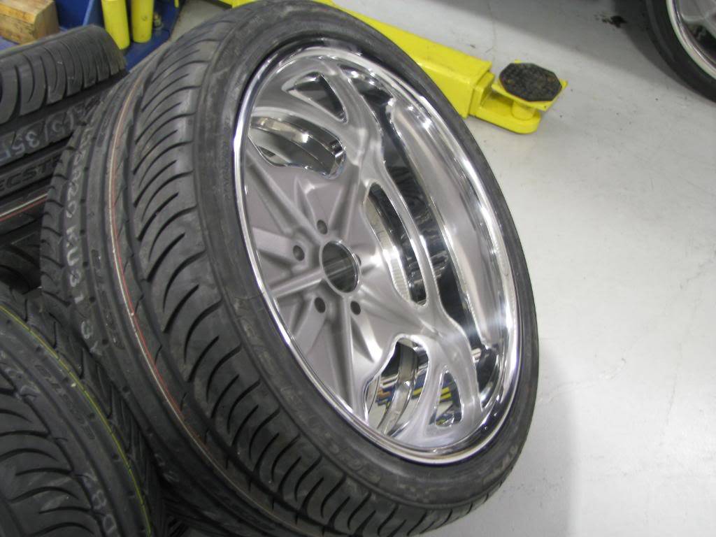

      Here are my wheels

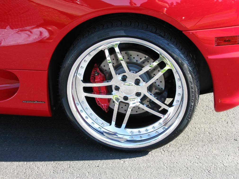

      Here's a pic of Rushforth Concept II that are powdercoated:

      Quote Originally Posted by jtodd71 View Post
      I have some Boyd Wheels
      Those are some GREAT looking wheels....JR
      So. Cal.
      1,240
      Quote Originally Posted by TD509EFI View Post
      Well heck, they look good. The powder coating doesnt fade the shine at all huh? And being PC'ed they will be as durable as anything, Im thinking more so than clear coat. We have all seen the dreaded clear coat de-lamination from our cars. But a powder coat is solid. Are the clears as solid as the base colors. It looks really good, I never knew powder coat was so clear. JR

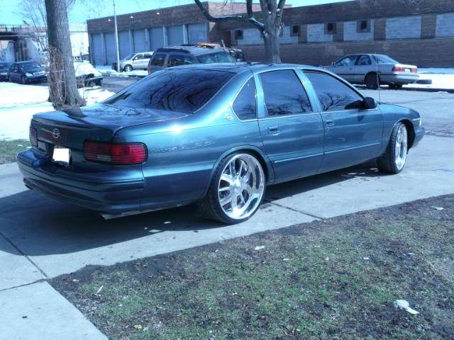

      This is polished
      and my impala on the 22's that are polished.
