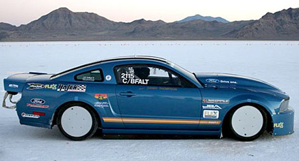

      just google 200mph mustang. you'll find a late model mustang that pulled off a 256 mph run on e85.
      Your musang isnt that different aerodynamically, really. Some mods to the front and rear and you should be stable. I'd do some rooftop vanes (see land speed cars, like this one, you can make them out if you look close) and a belly pan. Getting the wobblys at 200 mph is a good way to find out what the world looks like upside down and spinning.
      I think big red vented some of the underhood pressure from the cowl induction vent. You'll be doing the opposite with your hood, creating a high pressure system under the hood, and blowing down on the ground under the engine, causing lift. Find a way to exhaust that pressure and you're gold.
      Lastly, I'd consider a "splitter" under the front spoiler area, to funnel air around the front rather than under the car. This car has a tiny one. I'd go "car of tomorrow" big on an older car like yours.

      Quote Originally Posted by TonyL View Post
      the roof vanes might be hard since I dont want to do anything that will look silly driving around town that would be a permanent attachment. I CAn put some winglets on the ront and rear spoilers though that can detatch easly.
      beely pan would be easy since it can be attached and removed quite easily.
      hood vents can be closed temp for the run
      I could definately modify the current intakes that were there for the ac intake that are not in use to allow air to come out just in front of the windshield
      that would be easy enough.
      already in the works for an unrelated front end re design this winter that ben hermance is helping me on to get rid of the eleanor front end
