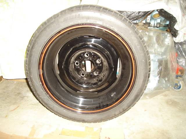

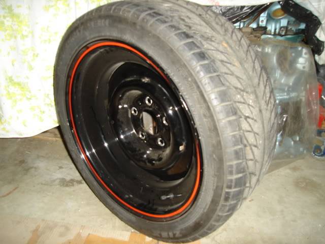

      I had these 'standard' steel 17X8" wheels custom-built to my specs about 10 years ago. I won't mention the company who made them because they were very difficult to deal with, taking 6 months after quoting me a 6 week delivery. My friend had them painted with black enamel at the bodyshop he manages, his Dad did the 1/4" wide red pinstripe on the rim lip to simulate the look of 14" redline tires.
      Wheel Vintiques sells pretty much the same wheel (14 series Gennie)http://wheelvintiques.com/shopsite_s...age13-ss4.html, you can buy them in 17X7, 17X8 and 17X9 as well as a lot of sizes in smaller rim diameters. However buying them 'right off the shelf' might not be a good idea, you really need the backspacing made to your specs to fit your car perfectly.
      It looks like they'll do a custom backspacing on this particular wheel style, and they're now finally offering some fairly decent standard backspacing on them that should fit a lot of cars.
      They look pretty much like an 'old school' NASCAR wheel with the hubcaps removed, I really like the way they look with the stock GM centers. Heavy of course at 37# bare just like the other 17X8" steel wheels mentioned here, 235/45-17s are mounted on all of them.
