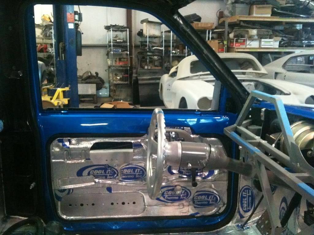

      I like what you did with the steering, must really feel good and responsive. I wonder if I could do the same for my truck?
    10. #90
      Dec 2008
      Helotes,Tx.
      54
      Jeff: thanks, its hard to be diff. ,these days,and look good doin it.
      Trey: It'll be a while but I can do it. I gotta figure out what gears I want to bust loose the 31" ers.
      Tig: Thanks,I dont see why you couldnt use a couple of u-joints and a longer DD. Its alot tighter of a feel than the oem plastic coupler.
      ~Troy
    11. #91
      NC
      583
      I'd like to give it a try, not sure if it would mess with my airbag though. You know anything about that?
      I contacted Borgeson about there shafts and they said they didnt get involved with my year (and other model years) because of the airbags.
    12. #92
      Dec 2008
      Helotes,Tx.
      54
      I'm not one for trying to keep the oem safety features but the original shaft can be cut and fit w/a u-joint and another piece of DD shaft.Then just one more splined end u-joint at the box. Your airbag shouldn't be affected and should still respond in a collision.

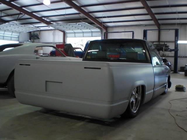

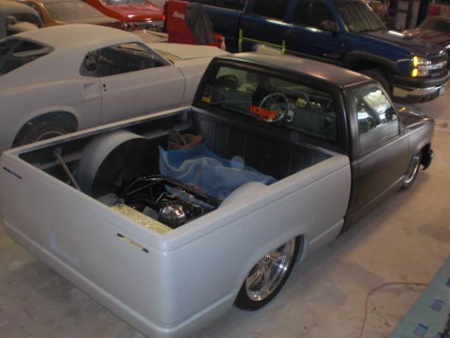

      Now w/the sheetmetal in place,you can get an idea what its gonna look like. I must say its going to look mean commin down the street.
      The 1st 8 pics are aired out.I have it set up for an extra low cruising height of (one) inch higher than shown.Ride height will be 4"s higher than shown.Camber is all the way Neg. for temp. clearance purposes.
      This is locked up.It gets some serious lift
      ~Troy

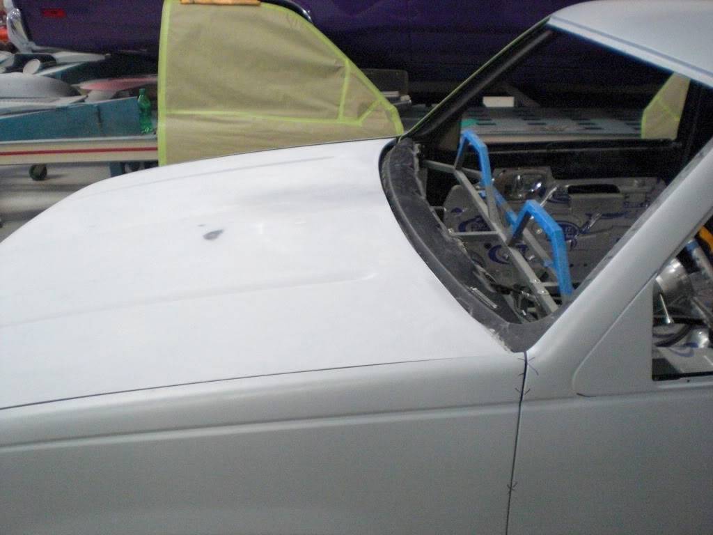

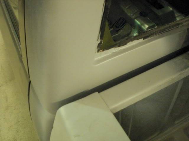

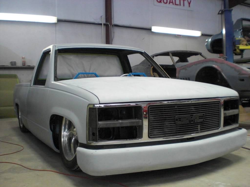

      Its been some time.Still at it.
      A few random pics of progress.
      ~Troy

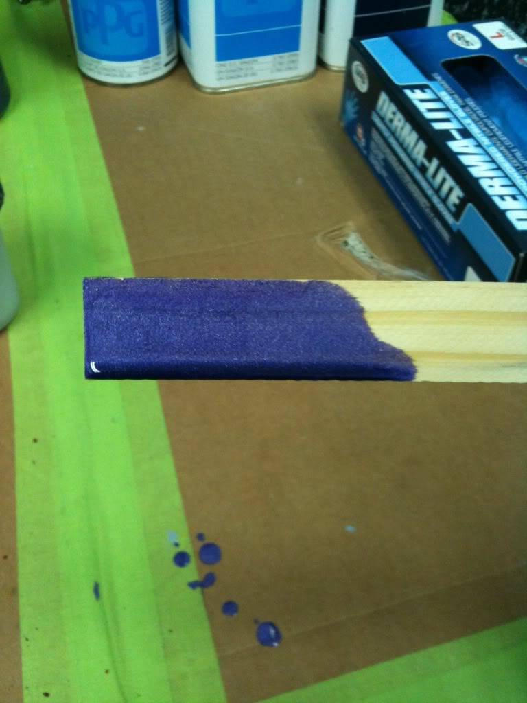

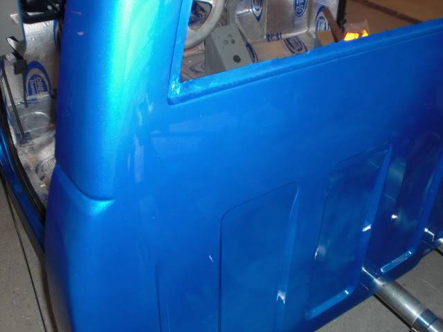

      Heres the color.
      (3 stage) Violet metallic base,blue tinted clear.
      ~Troy
