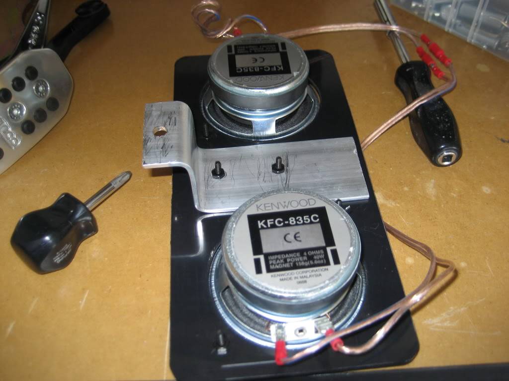

      I went with the Kenwood dash speakers like you may be doing. The rest is all JL 6 channel amp, 4's in the kicks, 6x9's under the rear dash invisible, and 10" sub firing through the rear dash invisible as well. The deck is a Alpine IDA x200. http://www.alpine-usa.com/US-en/prod...model=iDA-X200I actually didn't realize it didn't have a cd player but don't need it since I plan to upload all my favorites on my new ipod. My car is in the interior shop getting the box built and misc so I can't say how good it sounds. I'm sure it will be more than enough.

      6x9's are mounted in the rear dash like stock. Sub will be in a seperate box firing through a hole in the rear dash. The rear dash will be covered with a material that will allow sound through but conceal the speakers. The amp will be on the rear side of the box frenched in with the trunk carpeted.
      As far as the 4's go you need to be careful. There is not much room depth wise. I used some sound deadener and have very little clearance. I'd get the kicks first and take some measurments. The hinge mounting hole is not overly large or deep. I suppose you could enlarg it in diameter. But you can't gain much depth. You will need to be perfect for anything bigger than what I did.
