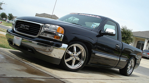

      I think for most GM Muscle Cars the brakes I have on my car are good to stop any of them.. I have the 13.5 inch 2008 C6 Z51 Front brakes and SSBC 12 inch rear disc brakes and I run 17's all the way around..
      I have never been a fan of anything over 18's until I bought the wheels for my truck that a friend was damn near giving away.. They just look good.. :D
