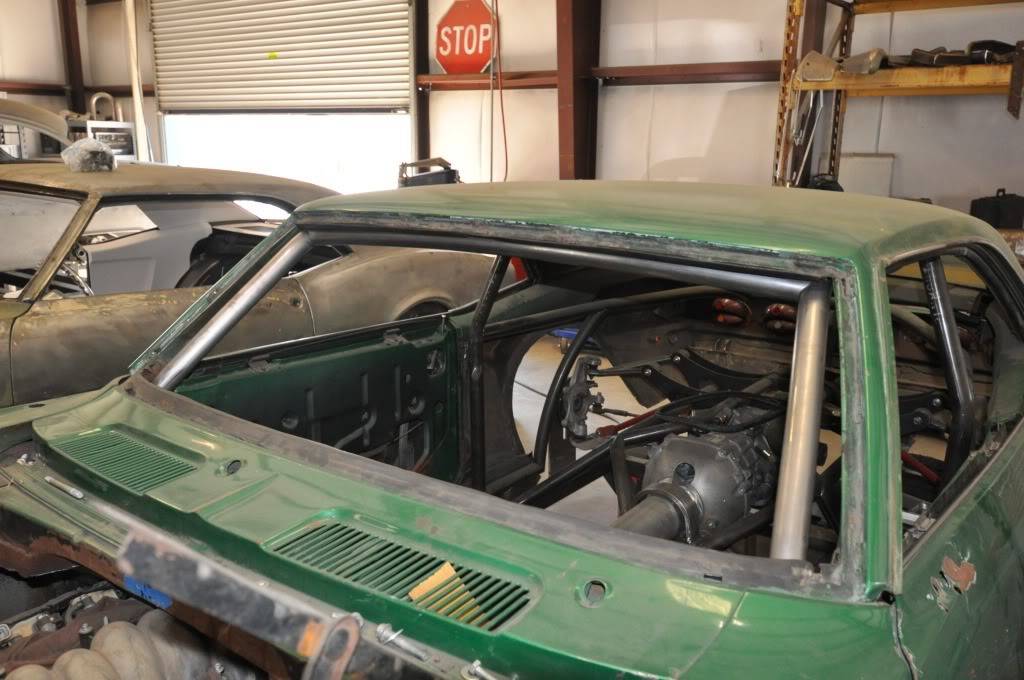

      Rodger uploaded a few more pictures that are current.
      Pretty A pillar tubes.
      Engine is set back very deep into the firewall at this point; I'm guessing 7-8 inches but it's hard to tell with the new fisheye lens my boy picked up.
      Sweet. Tilton pedals are mounted. Now I need to get off my ass an choose a Sparco seat, get a steering column, and wheel to get me all set up.
      A pillar bars again.
      Tyler

    16. #156
      Dec 2009
      El Dorado Hills
      1,645
      I gonna have to agree with matt. To me it does look like the pedals are too close to the driver. Not only that, they look to far to the left.
      When you bolt that seat in the pedals dont look like they will be centered. Amir Rosenbaum (Spectre Racing) had same prob after setting engine back in his '70 El Camino. He has to drive that thing with his legs to the left.
      Way to uncomfortable in a road racing environment and something to consider before you get to far along.
      Just my two cents.
      Gaetano Cosentino
