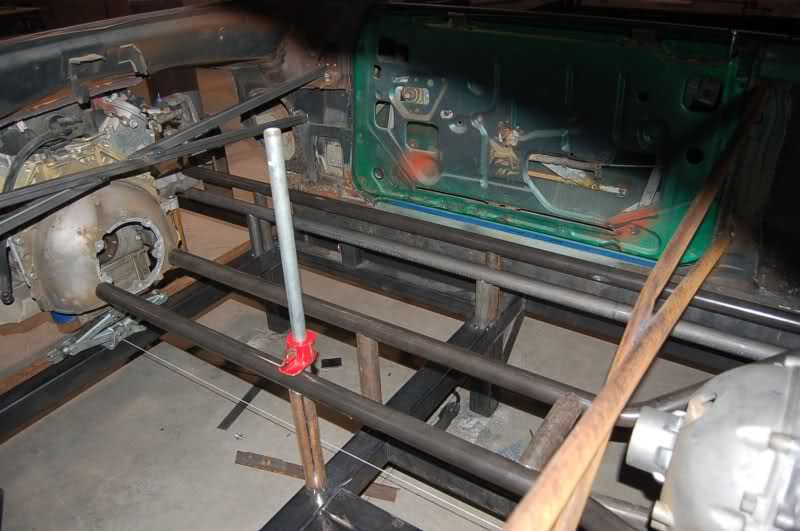

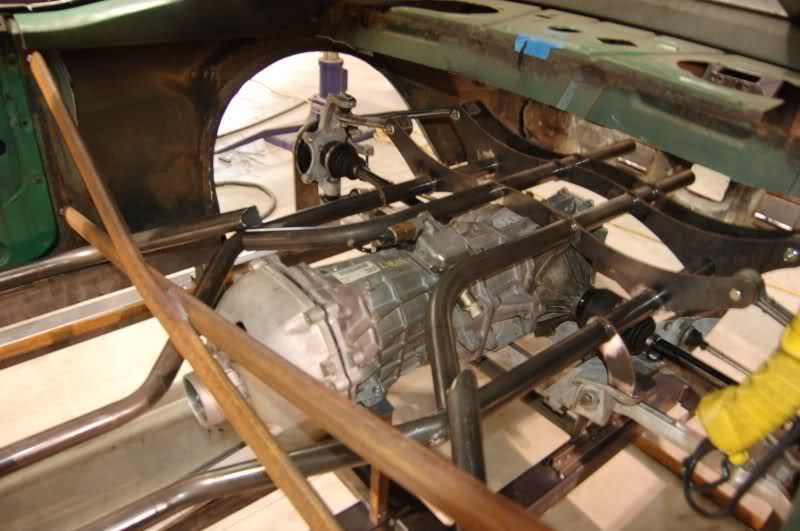

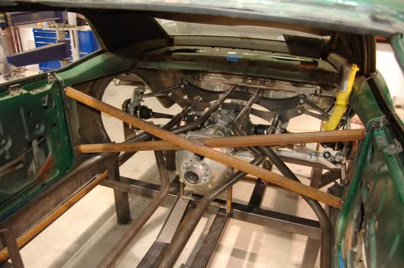

      Ironworks is SLOW. They already have the rear suspension 80% done. They have had the car for 2 weeks.
      Old T56 transaxle and rear frame.
      New T56 transaxle and rear frame assembly.
      More of the old config:
      And the new:
      Old chassis again:
      More new:
      So the new chassis is wicked. We are thinking about doing the cantilever style coil over mounts in the front and rear. I'll keep you updated as I get pics to post.

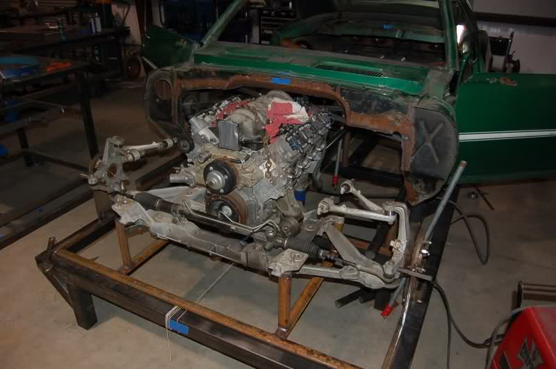

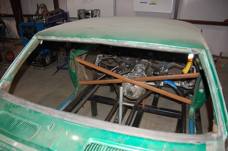

      Front cradle, engine and control arms laid in place on the chassis table:
      Rear bracing to keep the shell from flexing. Rear transaxle in place and suspension tacked up:
      Drivers side door- looking in where the dash once lived. You can see the boxed in rocker panels, and tube frame merging toward the front.
      Phillip-
      Plans for the car are to drive the piss out of it. I'd like to do the Silver State Classic race, optima Challange after SEMA, One Lap, and any and all HPDE events I can.
      Tyler
