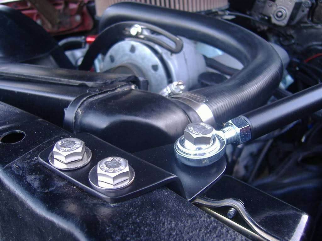

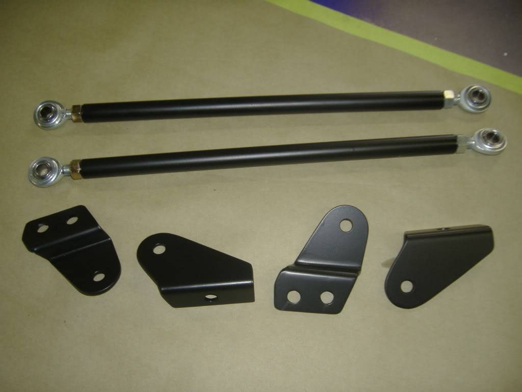

      I had to make me some cool fender braces.

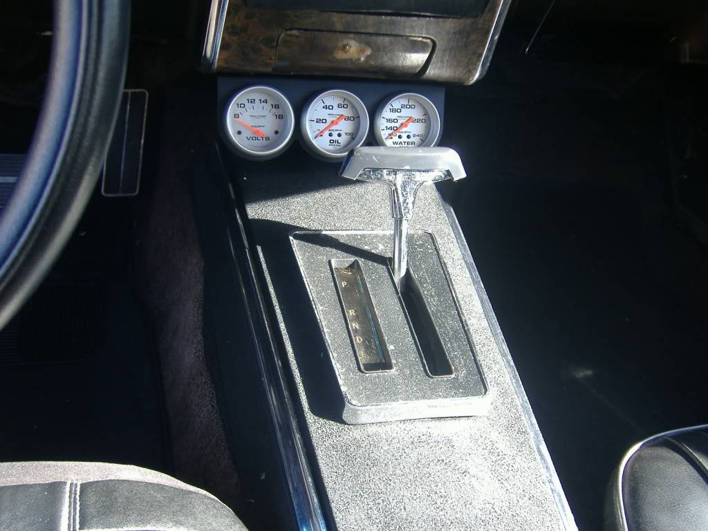

      Got some gauges and a Grant wheel. Redid the console with a satin textured black (instead of the faux woodgrain).

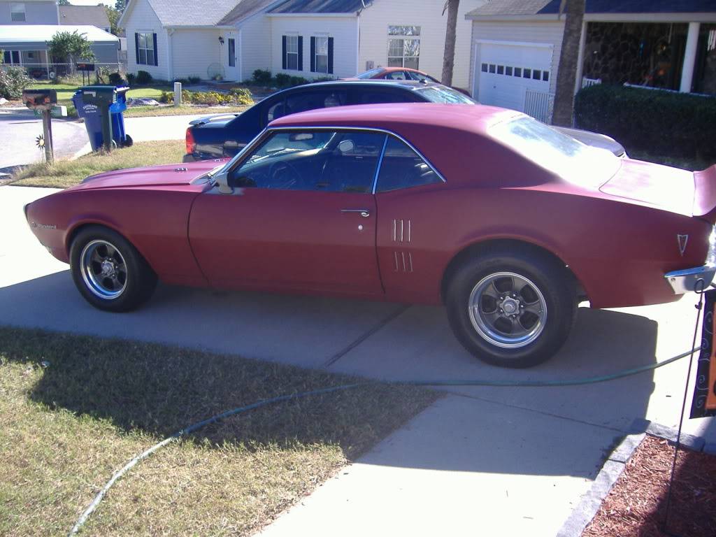

      I did some paint work and traded labor for these 15" American Hopsters. The hoops polsihed up good but the centers had some tarnish so I painted them. I like think they look pretty cool painted.

      Its nice to hear someone geting a deal instead of how high the price are. The braces look good , and I like the gauges you used. They look like they were made for this car. It looks like you did a god job on the wheels. Was it a lot of work making those mirrors fit the doors. I have a set to put on my Camaro. They look good.

      Thanks man. The mirrors were real easy to put on, but I need to trim a bit off the bottom outside edge so they lean out some more. Right now they tuck a bit too close to the glass.

      I like the braces! Good job. I've seen other builds with those guages (speedo and tach) and never really gave any thought. They look great. Are they a kit for that car or did you have to do some mods? Frank.
      Sep 2007
      Columbia, SC
      97
      Thanks guys. The Autometer 5" gauges actually fit right in the factory bezel. Just had to shorten up the legs on the U brackets that bolt to the backside of them.

      Love those fender braces! Did you fab the brackets?
      Sep 2007
      Columbia, SC
      97
      Thanks. I made templates up out of carboard and had a machinist buddy bend them on his brake out of 1/8" steel, then I trimmed them to shape. He drilled and tapped the tubes LH and RH thread for me as well.
