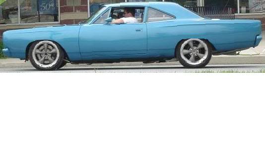

      Edit: You'll notice the chin spoiler is gone. A deer took it out on the way home from a club meet about a month ago. I'm lucky he didn't do worse damage.

      Thanks Colt. It's actually the original factory color: QQ1 Bright Metallic Blue. I got lucky and bought a car that I like the color. I've seen triple Green Chargers(paint, vinyl top, and interior) and I don't think I could live with a car that ugly.

      I am in the process of doing some upgrades on my charger. I have done a lot to it so far but, I want to change some things to make it stand out just a little bit more. I like what you did with the gas cap, and the door handles. I am just wondering, where do you have your ducts running to? One of the thing I am planning on doing id fresh air. One thing I do not want to do is cut up the hood.

      I plumbed them to the radiator support. The support is wide enough to provide enough room for twin 4" ducts plus a 26" radiator. I also could have run them to the inner fenders or through the inner pair of headlights like the older NASCAR stockers did it. I mocked it up one time to see what it would look like.
      I may do that eventually. But it involves a lot of cutting and fabricating for little benefit.

      With a ton of wheel spin, I ran 13.75 at 105mph on the first run. It was my first time and I was afraid of breaking the trans. My buddy with a 9sec Hemi Dart called me a ***** and told me to run it to the 6000rpm limit on each shift. My second run was 14.07 at 108.5mph, banging off the rev limiter as I went through the traps in 3rd gear. I need to practice launching so as to eliminate the wheel spin.
      My identical motor is running low 11's in a '63 Savoy. The difference being the Savoy is running an auto trans and the suspension is setup for dragracing.

      I like it! Is that a low deck stroker motor? Good MPH for what I'm sure is a fairly heavy car. Get it to hook and you should run at least mid 12s with that MPH.

      I say leave the chin spoiler off, looks better IMO, the chinspoiler looks out of place and uneven with the rest of car. I think the car looks great now!

      Hay thanks for the pics. I am not going to be able to use the front rad support for the cold air. It is way differant then the roadrunners. I am going to use the 2 access holes on the fender by the lower frame rails.
      That is a pretty good time, considering that it is not built for the 1/4 mile.
      So what have you done to the suspension?

      -circle track torsion bars(1.120")
      -welded-in subframe connectors
      -1 3/8" front swaybar
      -7/8" rear swaybar
      -the k-frame has been reinforced at all attachment points + all seams were welded up
      -the stock lca's were boxed with steel plates
      -tubular uca's
      -XHD rear leaf springs
      -polyurethane bushings
      -KYB shocks
      I'm also running a 13" front disc brake kit that utilizes 13" cobra rotors and 4-piston circle track calipers.

      If you dont mind, ive done a quick paint chop of your ride, added a bit of rake and upsized your wheels and rear tire slightly.
      Its sort of the look im going for...enjoy
      I can lower my car pretty easily, but I like the ground clearance in a car that get's driven a lot. I didn't go bigger than 17" wheels because of the added weight.

      well hope u dont mind me playing with your car at least, i was just tryina see how it would look with 18"s and a bit of a rake for the cruiser look
      Awesome car man, can;t wait to start workin on mine
      Decided on the 18x10 and 18x9 bullitt copy wheels in the black spoke/polished lip with 295/35/18 gforce drag radials out back, 255/40/18 up front gforce 2 tires

      Nice car Pete....Are you running AR engineering brakes? They look like the Viper calipers. Lookin' Good! Nice to see another Mopar in the mix.
