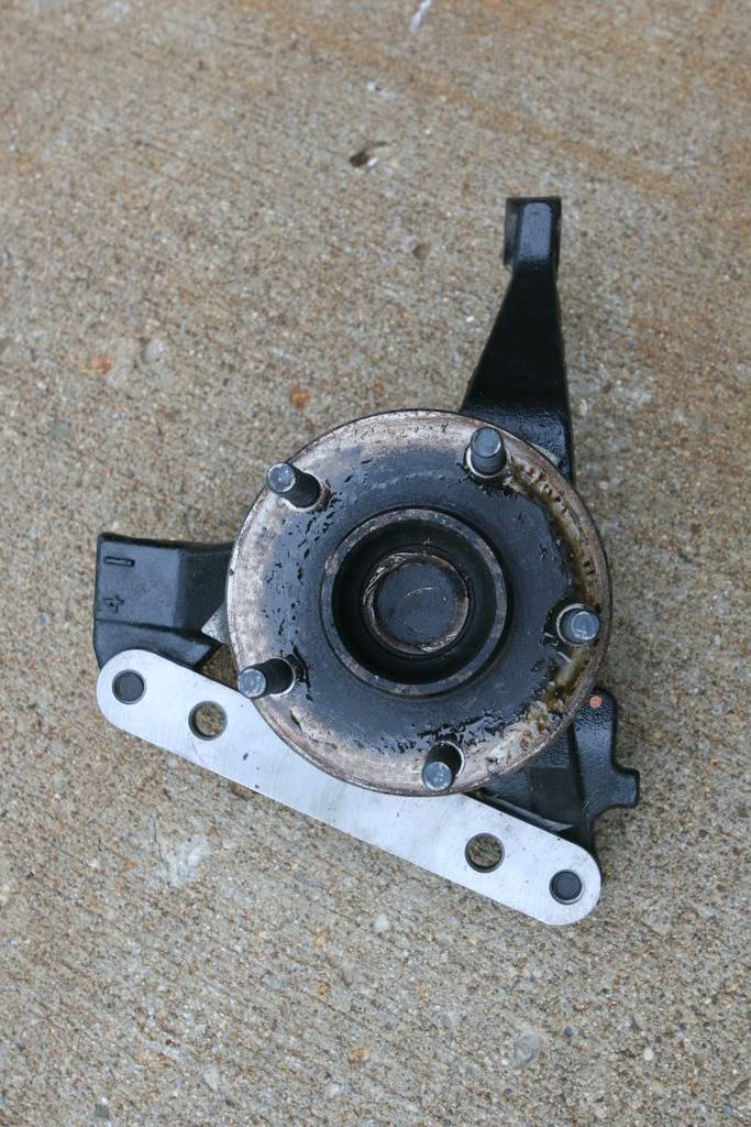

      I had my guy modify stock g-body spindles to fit LS1 brakes. PM me if you want his email, I"m sure he'll sell you a set of brackets. And the SC&C Stage 1 or 2 helps the geometry a lot. Otherwise the AFX spindles sound like the way to go.

      I have 98-02 S10 Blazer knuckles. They are a direct swap for factory Monte setup but have a slip on rotor similar to the way the Vette is setup.
      The truck spindles are the same as the Monte, they will not work for this setup easily. I'll look for some pics & post them.

      Thanks, that exactly what I was looking for and thanks for the pictures.
