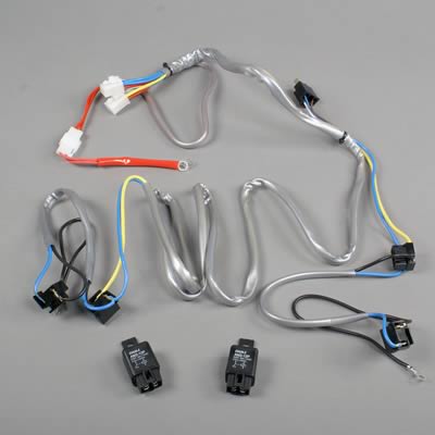

      To run the H4 bulbs you will need one tweak for the low beams, there are 2 pins you can swap, or just buy these pigtails and plug-and-play.
      From: http://www.rallylights.com/detail.aspx?ID=120
      Note: looking from behind the socket (both male and female plugs), where you have the wires, you have terminals at 9, 12, 3 o'clock, the 12 an 3 o'clock terminals swap.
      You can pull those mentioned from the car socket and re-insert them. The high beams (on a 4 lamp setup) need no mods.
      If your car has 4 beams, you 'need' to buy a wiring harness that can handle the added load the H4 bulbs will draw.
      If you buy the wiring harness, you only need 1 pigtail, as the harness will power the 4 headlights based on lo/hi beam detected.
      This is one sample of a wiring harness for H4 lamps in a 4 headlight setup, there are nicer ones by Bosch and Painless, but this is an example:
